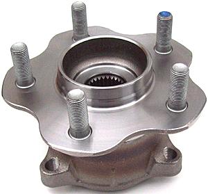

Thank you, this is great. One question, though. In your response first you refer to the hub bearing. But later in your response you refer to the wheel hub. Are both the same?
Old Mar 21, 2018 | 02:19 PM
rhomanski's Avatar
Joined: Oct 2017
Posts: 962
Likes: 171
From: Batesville Arkansas
This is what a typical wheel hub bearing looks like. One side bolts to the car, the wheel bolts to the other side. You don't normally need a wheel alignment when you change one either.
