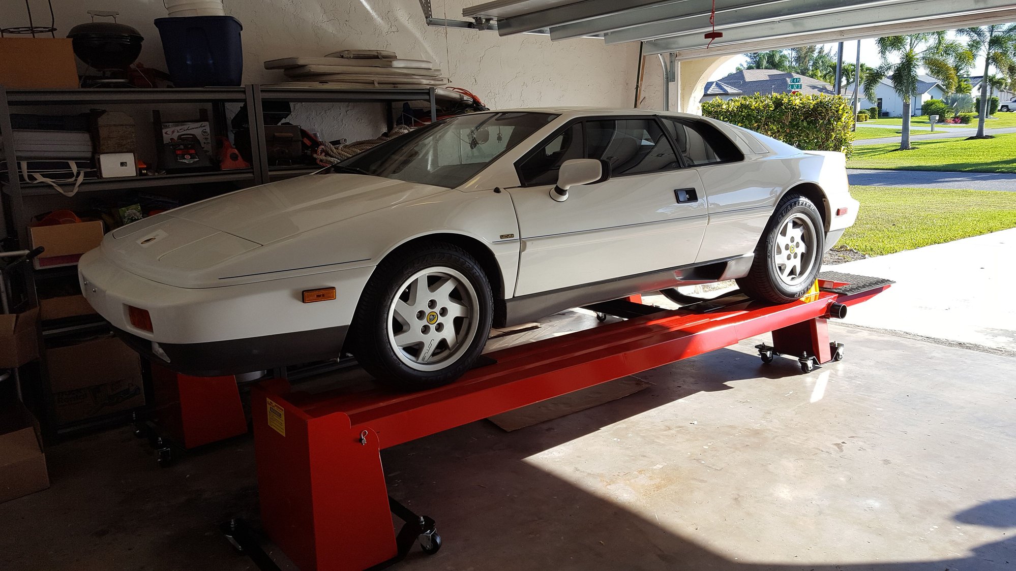

I had a https://www.kwik-lift.com/ that got sold with my Lotus and I would get this but they are not selling them do to steel costs right now. I had the trolley wheels and 2 cross Jack plates that where adjustable. It was a very nice system and adjustable in length when putting it together.
This was in the smallest length setting, actually had to drill some holes as it was shorter that the factory design.
