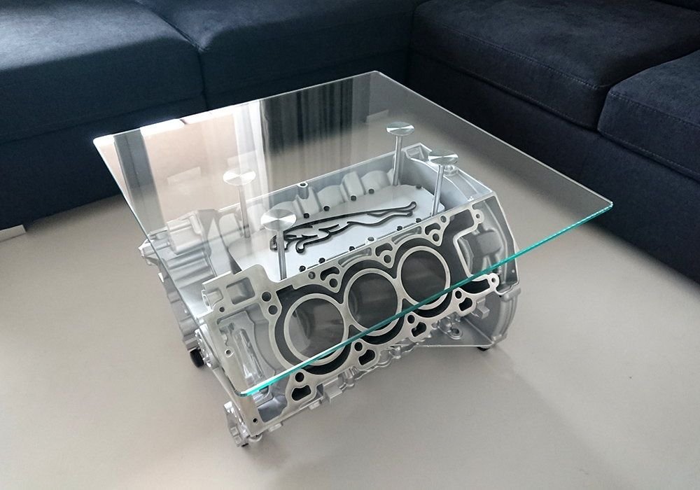

That V-6 engine is a real strange one too!
Yes that is a glass topped coffee table! They make them with many different blocks too.
