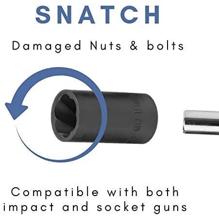

With many lock nuts you simply need to find a standard socket of the right size and hammer it on the nut.
if there is a free-spinning ring around the nut you may have to do this first:
Old Mar 14, 2021 | 10:10 PM
