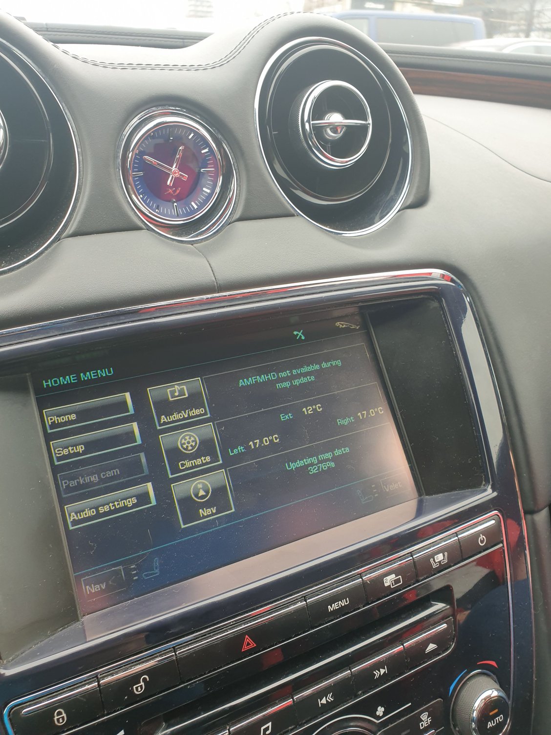

I have updated my 2010 Supersport with the update from Satnavishop, it's the same files as the genuine version and they evidently have some sort of bent way to generate the activation codes. It was very fussy about seeing the stick and updating, but in my previous 2010 Portfolio I could NOT get it to see the stick no matter what I did, apparently some early cars really played up and the SS has a VIN number a few thousand higher than the Portfolio.
I'm going to try the stick that worked in the SS in the Portfolio when I see my friend who bought it, if that works it's clearly some sort of magic stick and if you PM me I'll post it to you when we're done. As others have said it was a long winded and somewhat nervewracking process, at once restart it said it was 3273% complete....

I also had the percentage glitch, but that one fixed after car restart. And update continued
Update info changes every 5% that takes approximately 7-8 minutes. Have been driving for 3 days with short runs around town, till the update finished.
