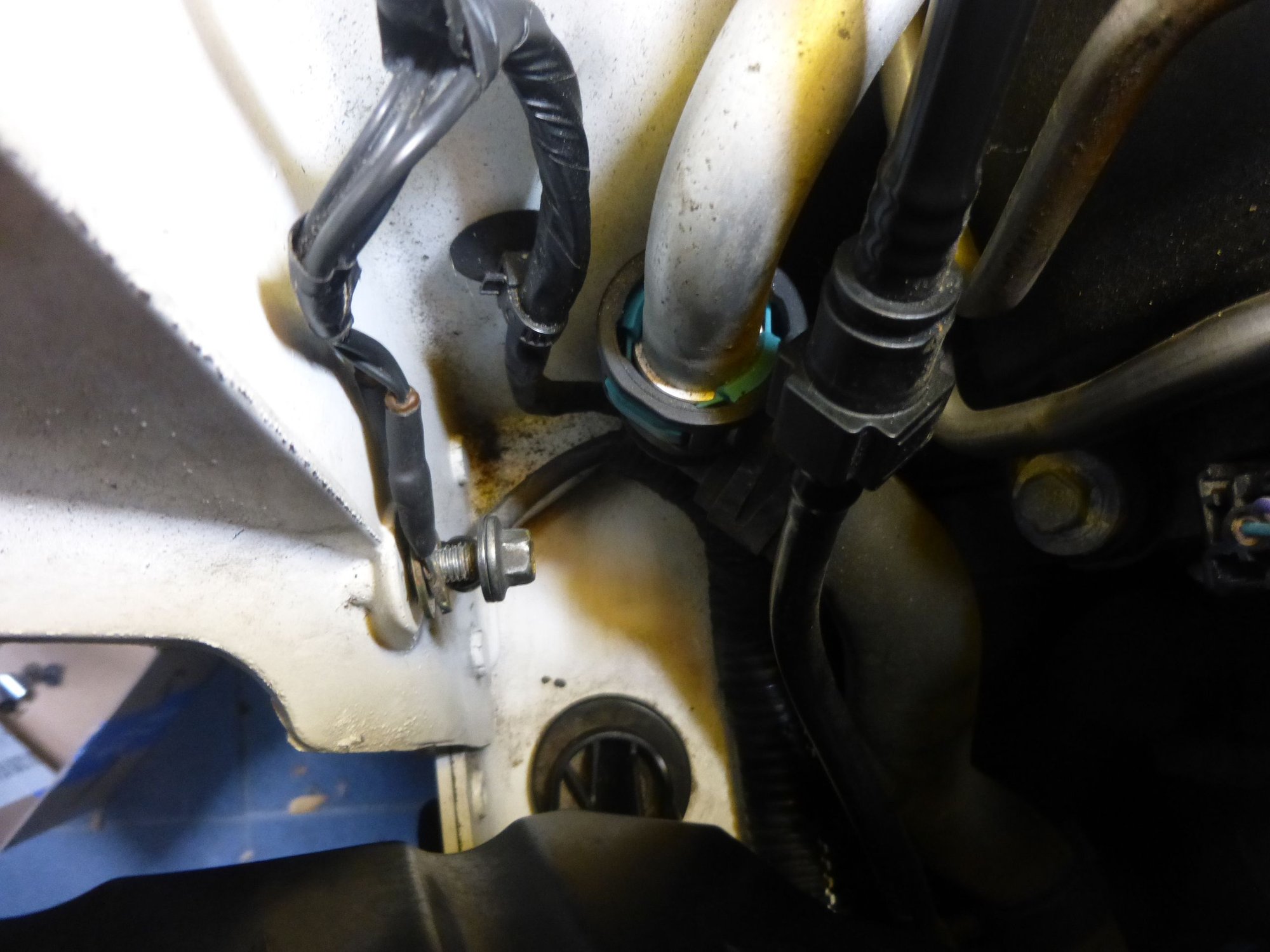

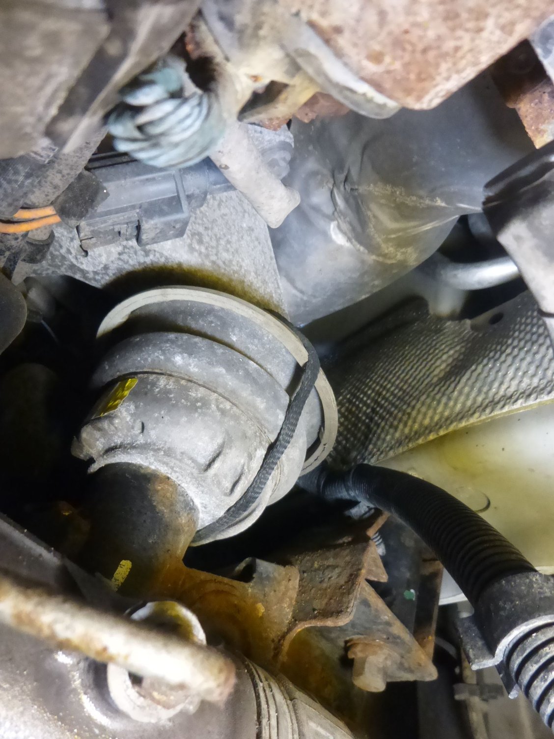

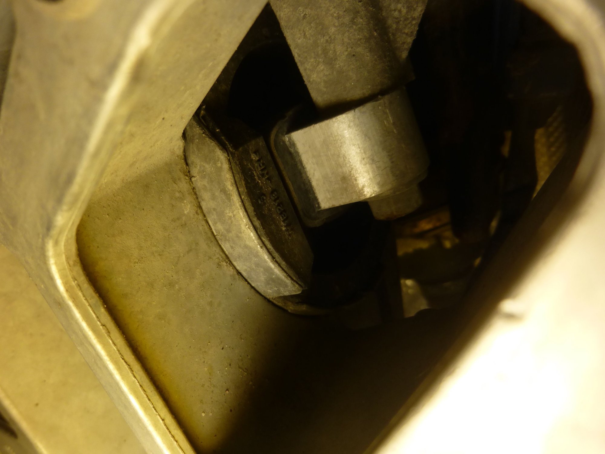

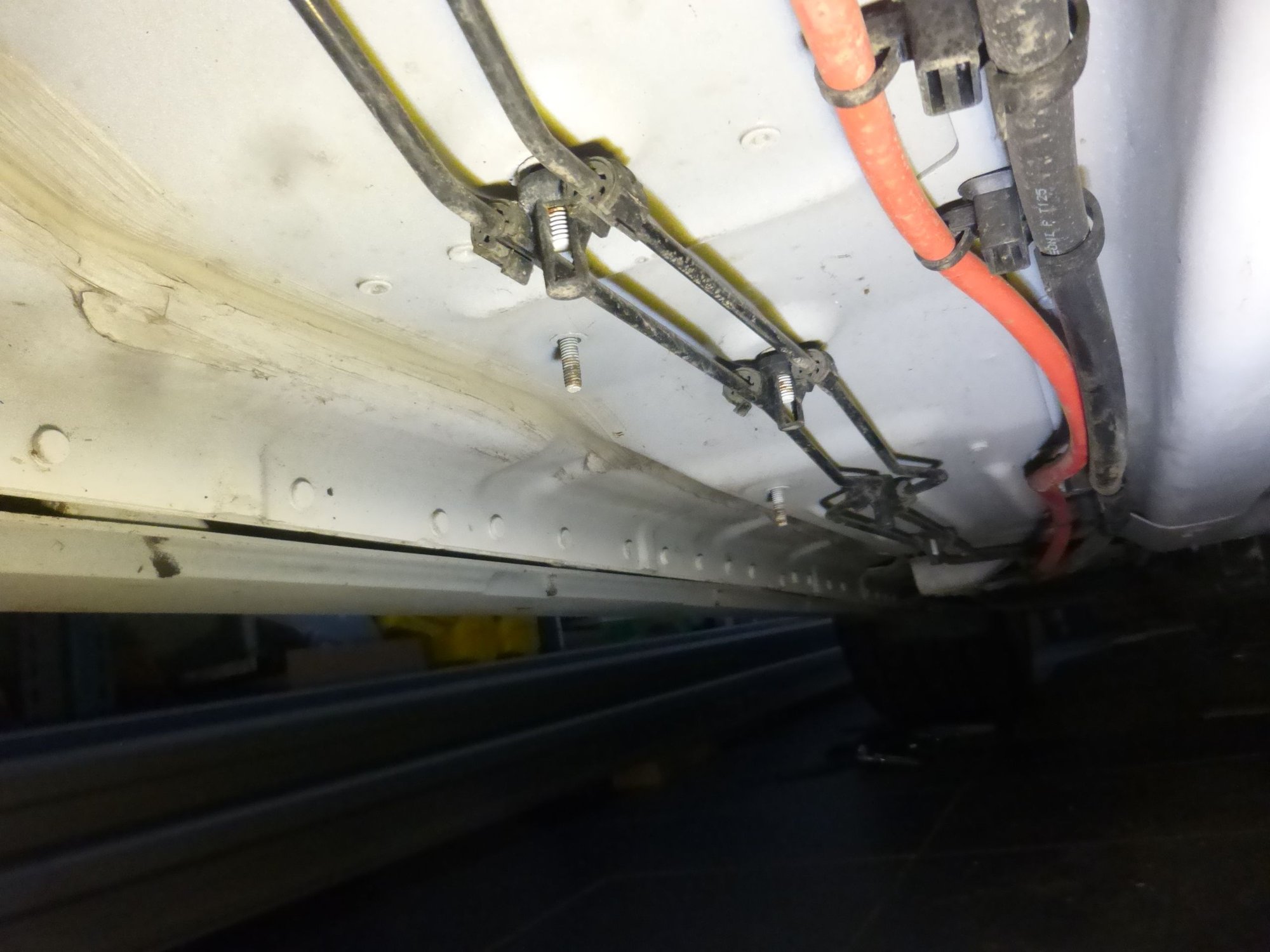

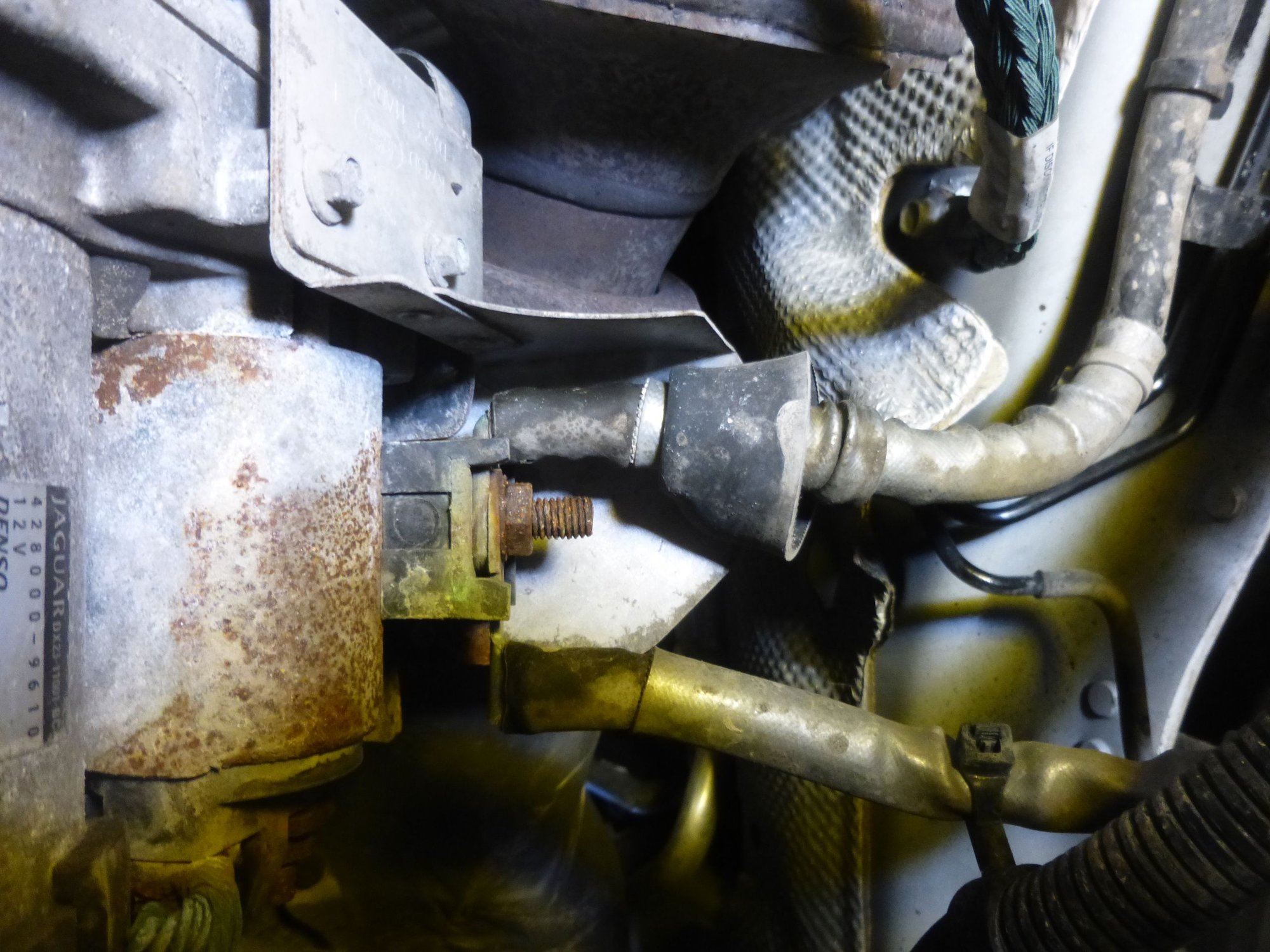

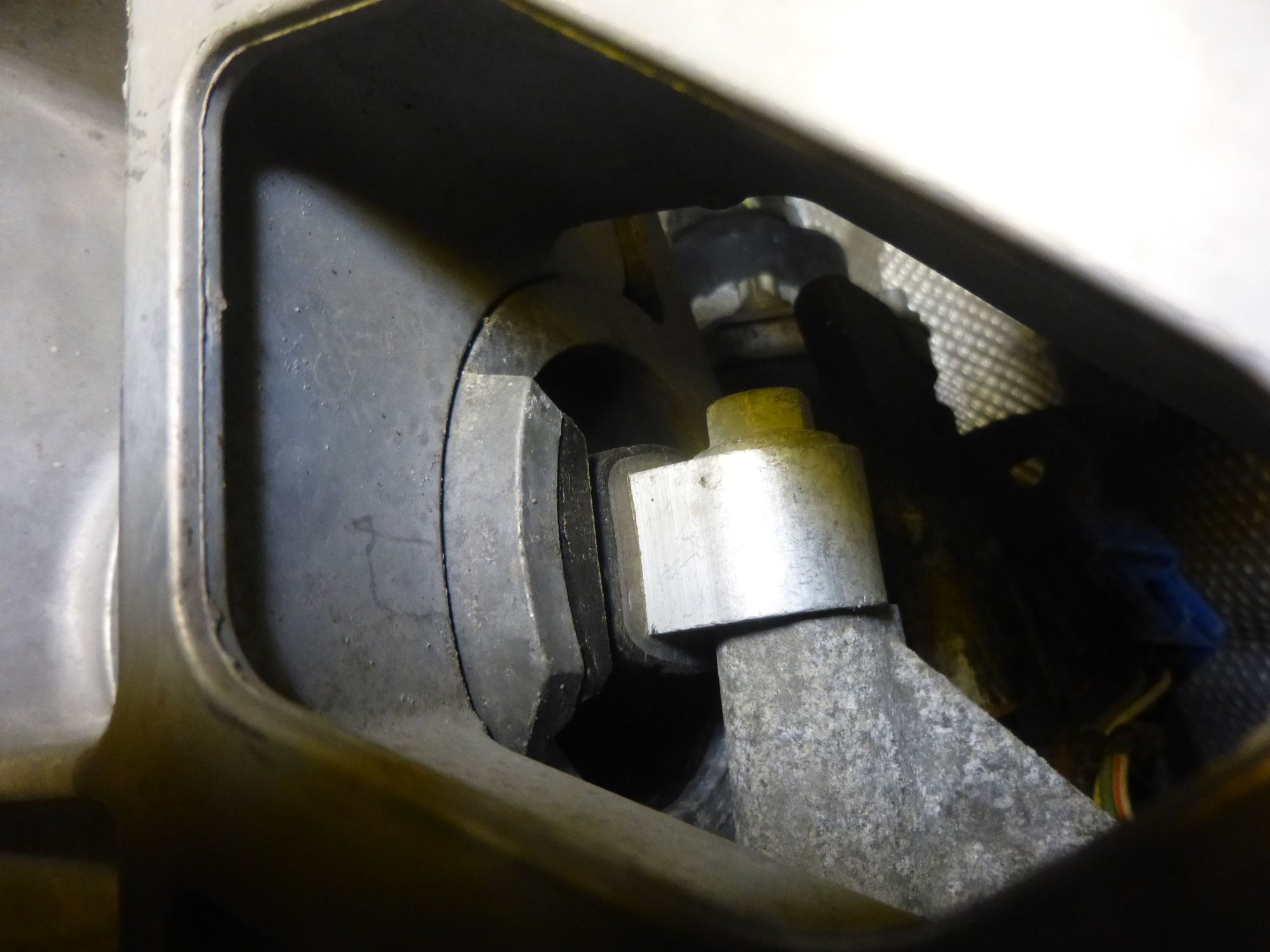

Spent a couple of hours under the car today and removed the covers on the passenger side. Mainly interested in oil leaks, oil, coolant and power lines. So the good news is no oil leaks anywhere, no coolant leaks anywhere. The not so good news is corrosion on the terminals of the powerline connector and starter motor terminals. Found early enough to fix tomorrow. Pictures are attached.

engine mount
engine mount
transmission mount
transmission mount

Starter terminal
Starter terminal
passenger side brake and power lines

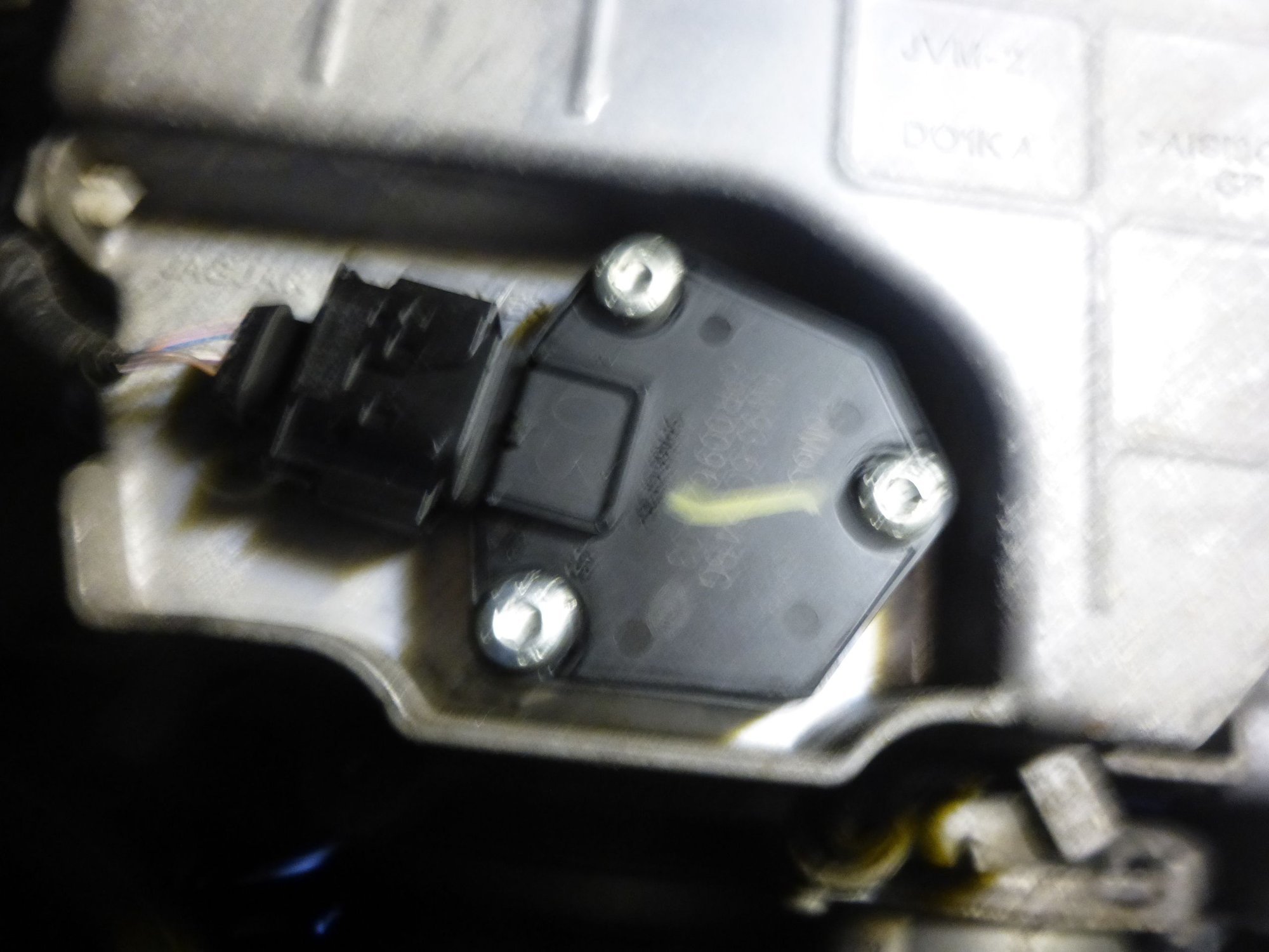

Oil level sensor
Oil level sensor

Still making progress, all the terminals are cleaned up and protected with a surface coat of nickel based grease. The power steering fluid has been replaced with Mobil Multi-Vehicle semi synthetic Mercon 3 and tomorrow the differential oil will be changed using Valvoline Advanced 75W90 full synthetic. Also took a look at the AC system which was running with only 0.4ibs of refrigerant. After evacuating the refrigerant, the system held vacuum of -30in Hg for 30 minutes and then was recharged with 900grams of R134a. Then it will be ready for our Annual Leaf Run around cottage country this week end.

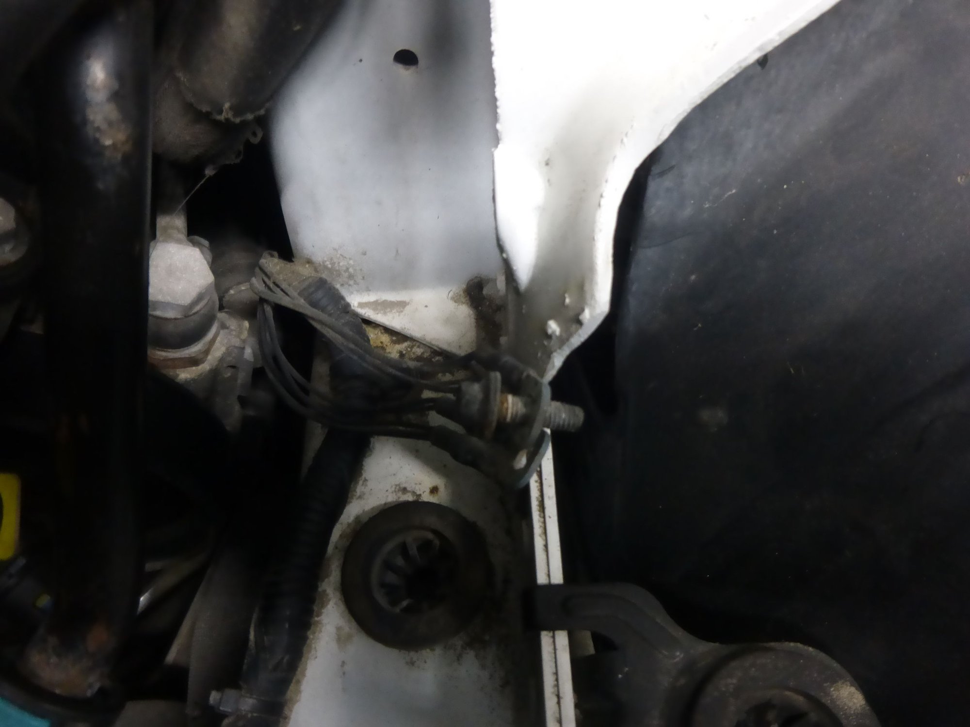

Default Engine Grounds

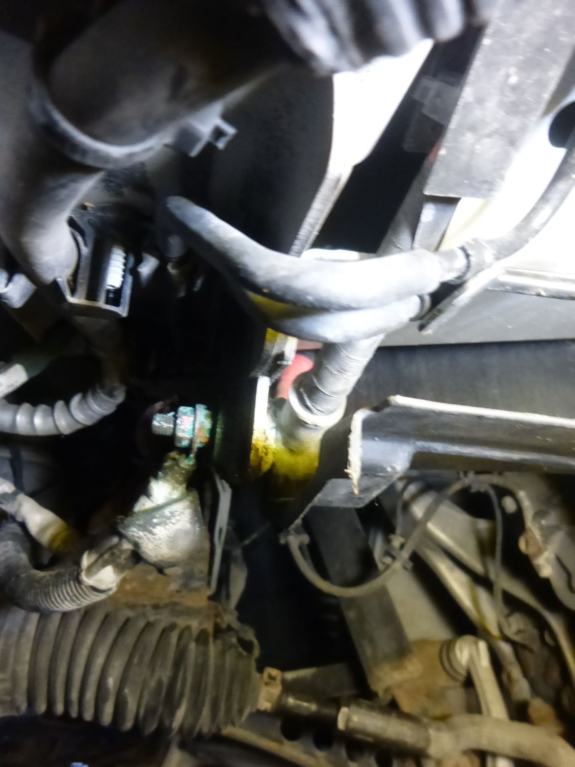

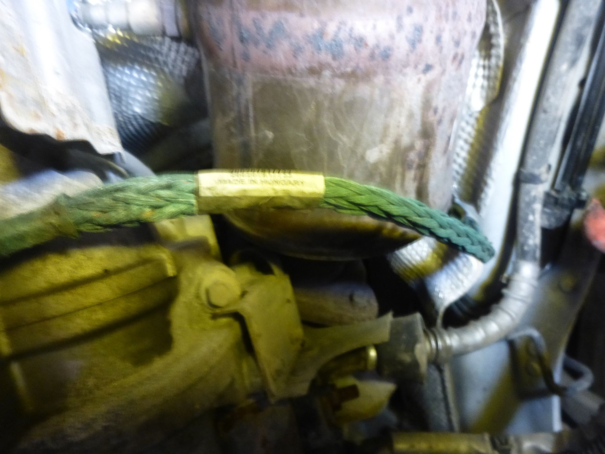

I decided to do the engine grounds this afternoon. So far I have found 2 sets, the one on the passenger side front has 5 conductors on 2 terminals. It is located just below the passenger side air filter box and is shown in the attached pic after cleaning but before tightening.. You can see that I removed the fender liner so I could lubricate the threads of the 6mm steel ground stud before I attempted to remove it. The second one is located on the drivers side in a similar position just below the drivers side air filter box.

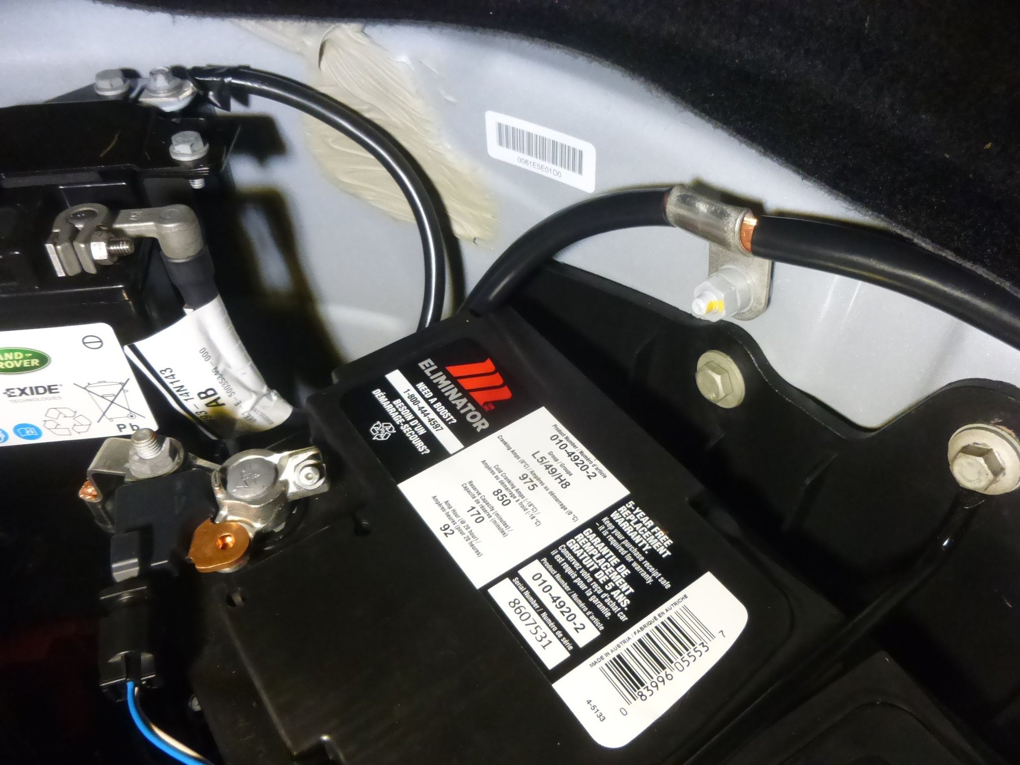

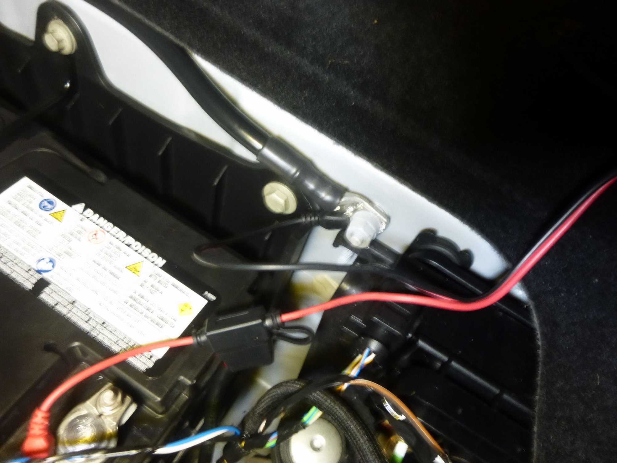

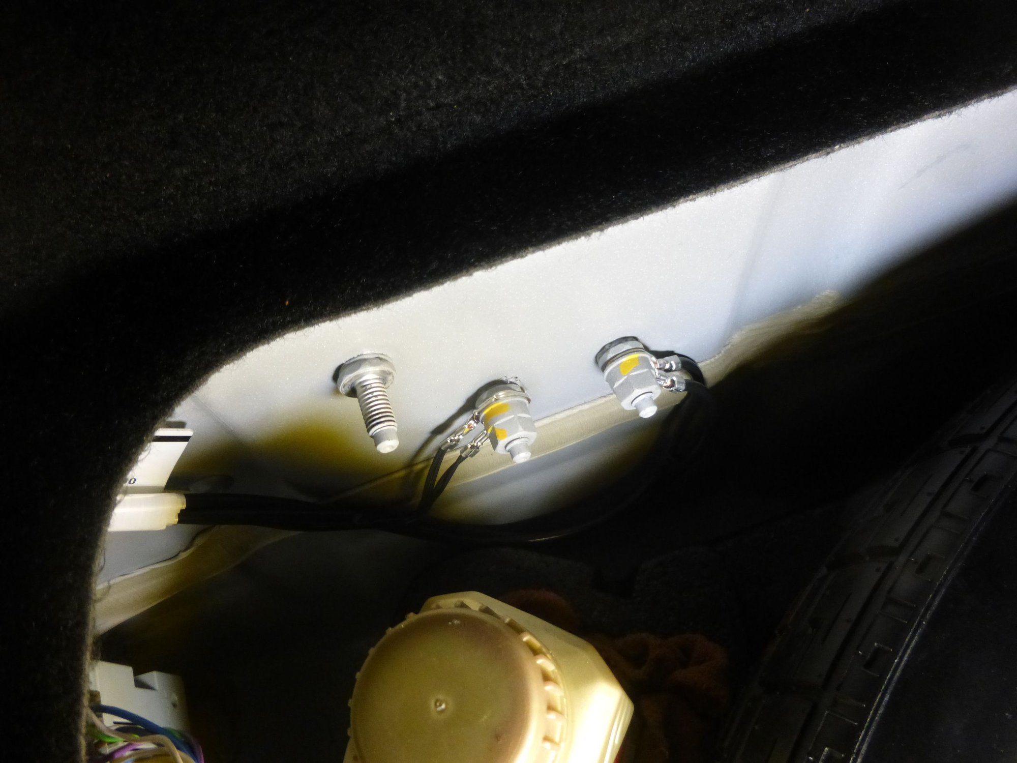

In the engine compartment I have found two steel bolts which thread into steel inserts and then there is the negatiive steel stud on the passenger side strut tower.
In the trunk all the ground points are aluminum studs which are similar to the X350 and X358 cars. They look fragile but in my car are in good shape. There is no evidence of water or dampness in the trunk.

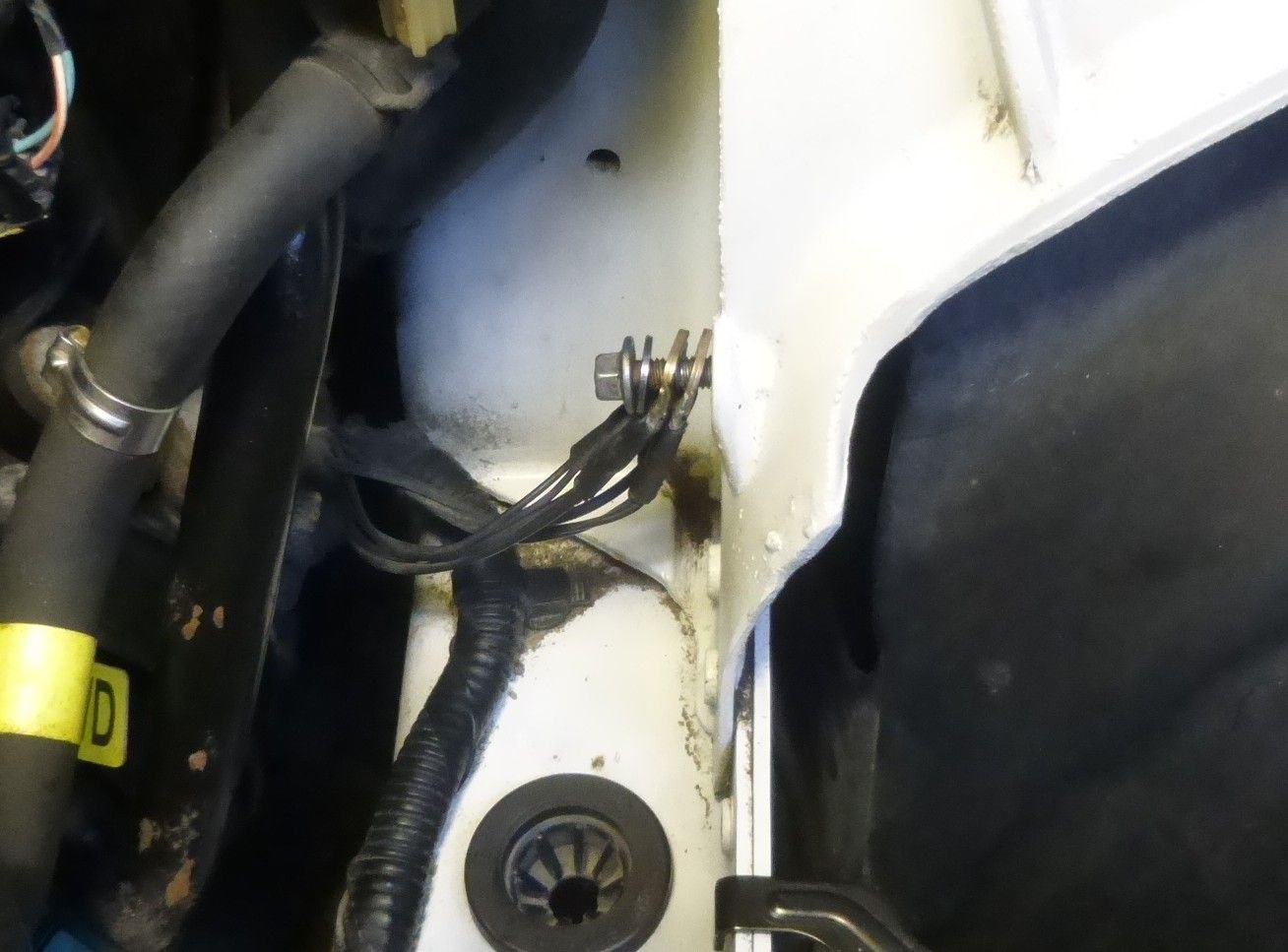

Default More Grounds
I have attached more pics of the grounds in my car.
Drivers side engine ground as found
Cleaned up ground
Cleaned up ground
Drivers side trunk grounds--just like X350 type
Passenger side trunk
