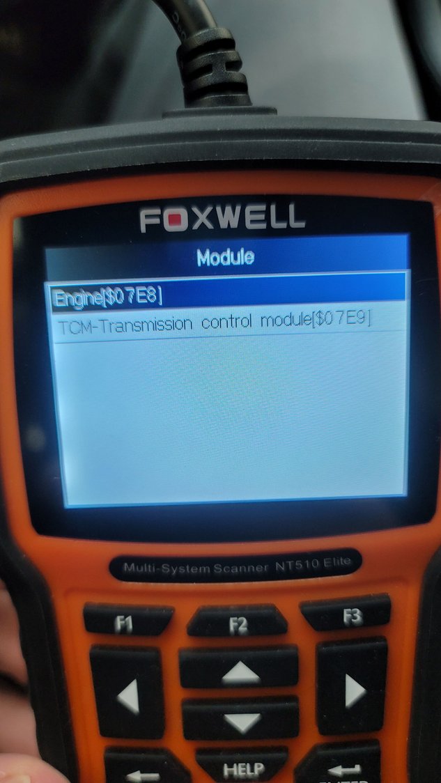

I drove about 30 minutes with no problems. I park for 2 hours and when I turn it on, the check engine light stayed on. I have a DTC reader and it reads, "TCM - Transmission control module [$07E9]".

That doesn't show any fault codes.
It's just saying the engine module (proper name PCM) is at the stated address (on the CAN bus) and the TCM is at the other address.
TBH I hate tools which are unclear!
(The TCM is inside the trans. It seems happy or ... maybe is.)
hmm... maybe your device wants you to select one of those modules and then it will do something (read data? read codes?).

I think you need a better scanner. Jaguar SDD is probably needed to get all the codes.
Old Sep 27, 2025 | 09:30 AM
Six Rotors's Avatar
Posts: 950
Likes: 292
From: Toronto,Canada
That looks like a Foxwell NT510 Elite. If he has the LandroverJaguar software package it will do what is needed.

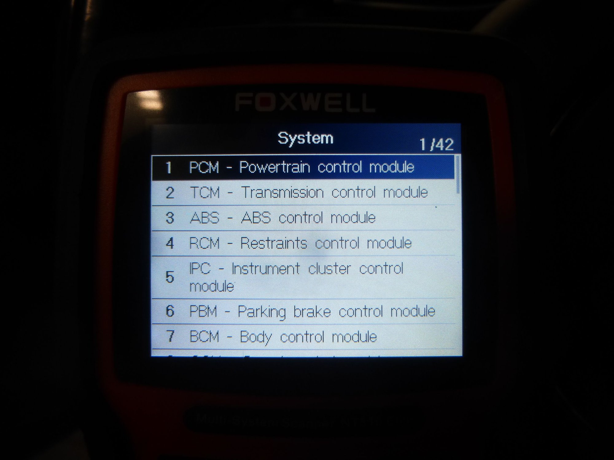

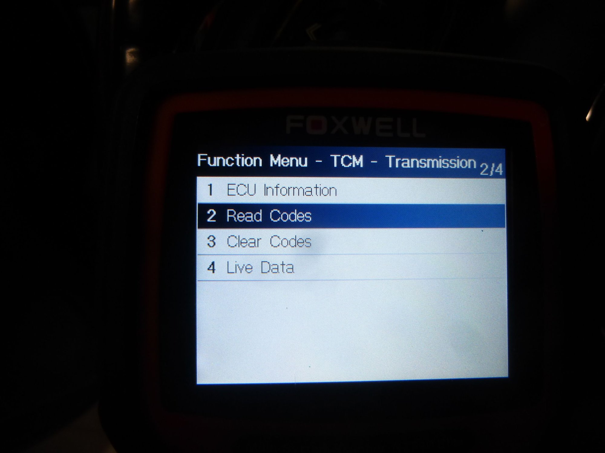

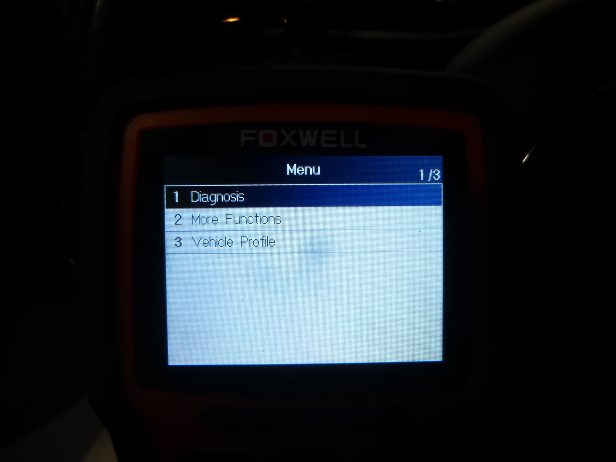

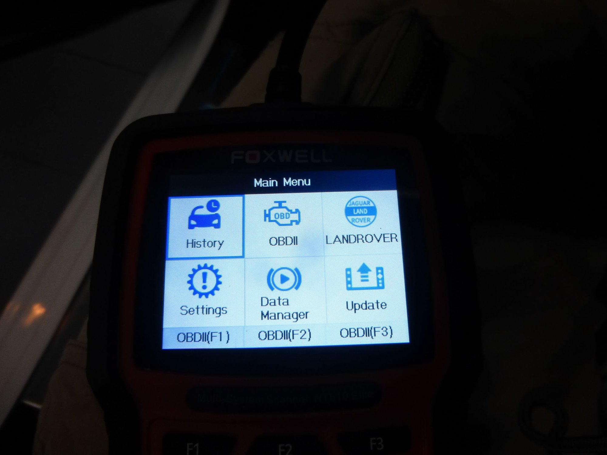

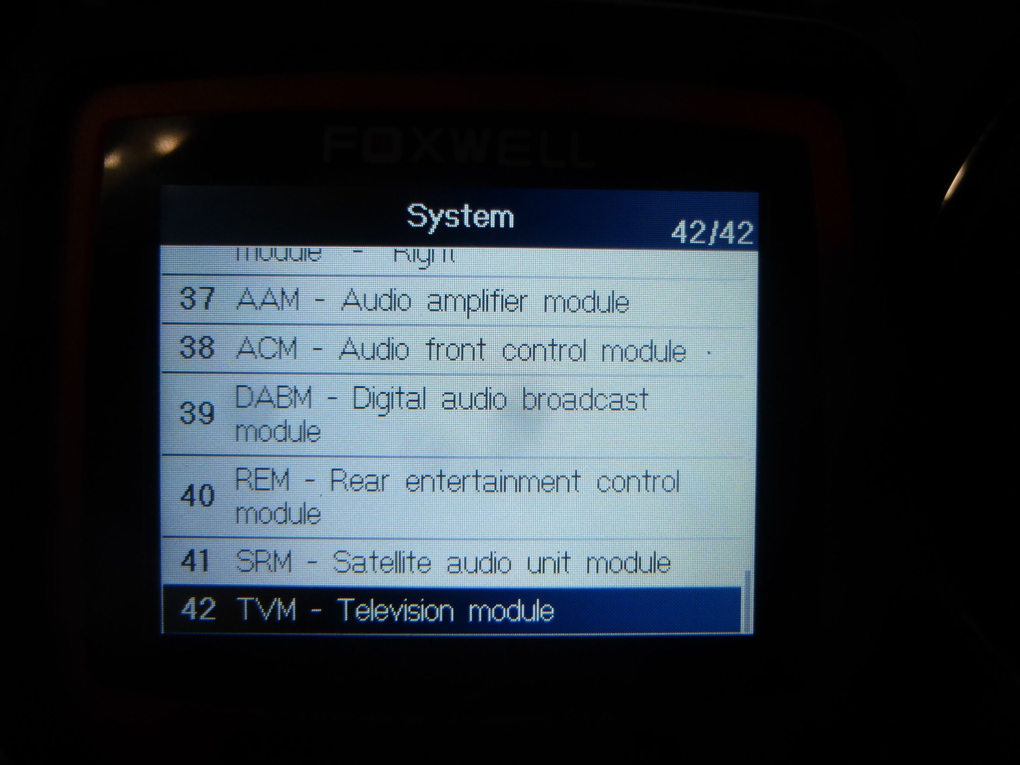

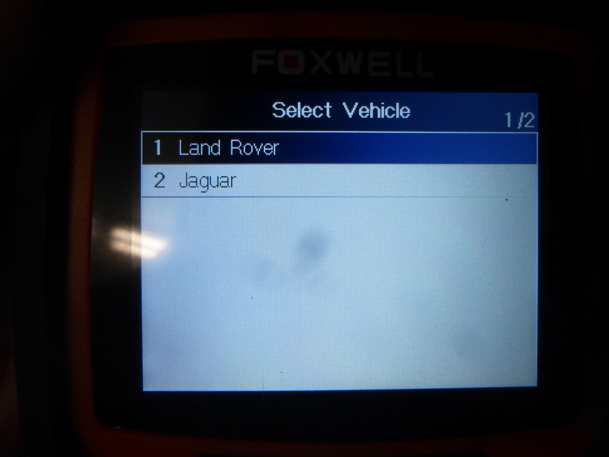

I have taken a few screen shots of my Foxwell NT510 Elite connected to my 2014 XJL 5.0 and basically shows the path to diagnose anything (almost).
Screen come up when connected to car diagnostic connector Click on Landrover
This comes up. Select Jaguar

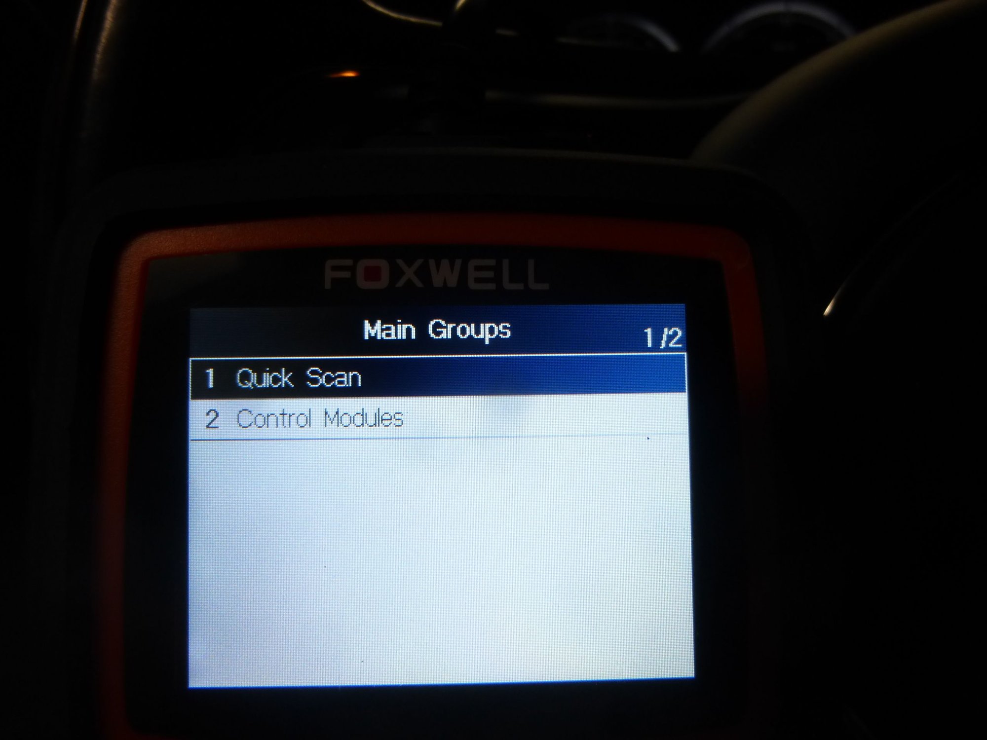

This menu appears after vehicle ID is verified. Select Diagnosis
Then you have a choice of a Quick Scan of the vehicle or you can choose to scan a specific system. For this sample I chose Quick Scan
This is the end of the List of system which can be scanned. I selected system2 Transmission(from first page of this list)
Then you can read any DTCs, Clear DTCs or get live data
First page of list of systems
