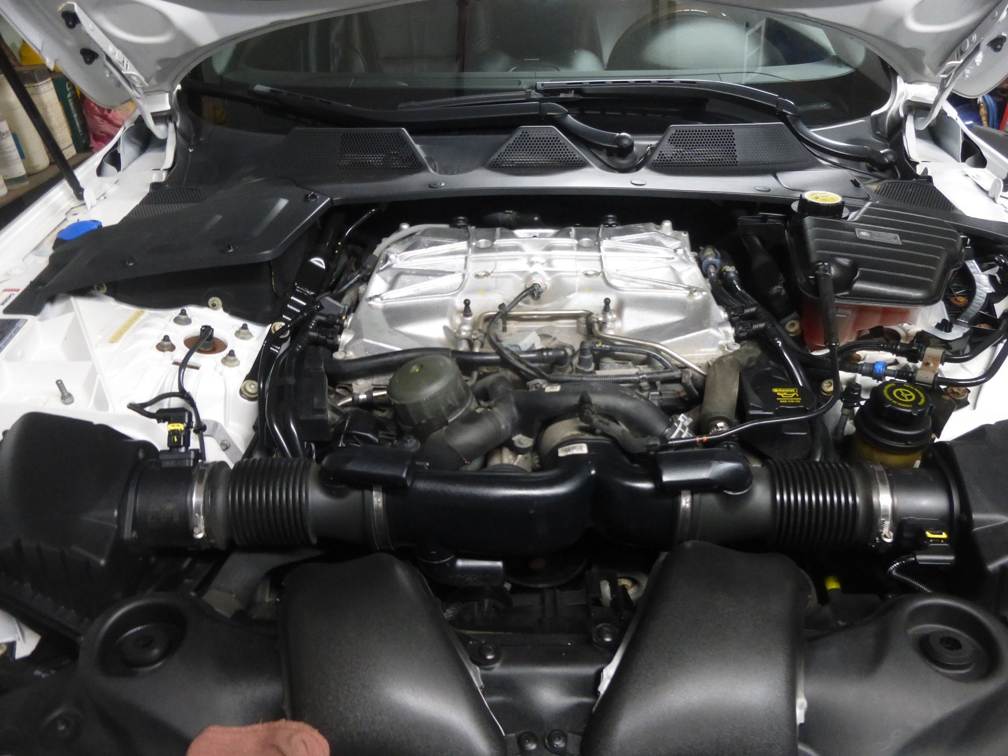

engine is clean ,has original cooling components

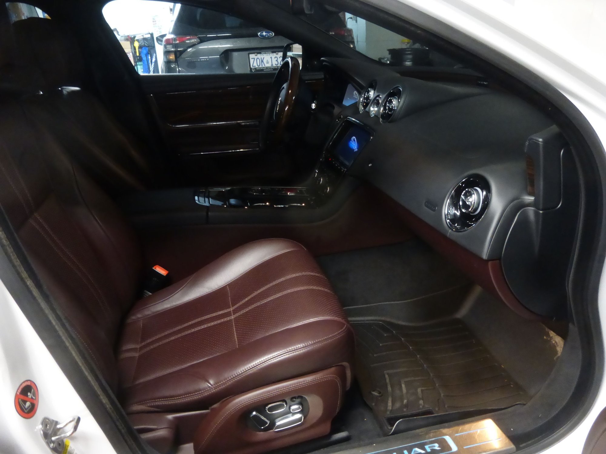

Does anyone know where the body fuse box is located and how to access it . The Owners Manual says it is where the rear arm rest folds up, but I cannot see with these "aircraft seats"

There are several fuse box locations but the one you're referring to is located behind the leather you see in the arm rest pocket when the the arm rest is down.

Thanks. I did not realize that I needed an upholstery tool to open it. Anyway I found a blown 5amp fuse for the diagnostic system which I replaced. Now I can put my diagnostic tool on the car.

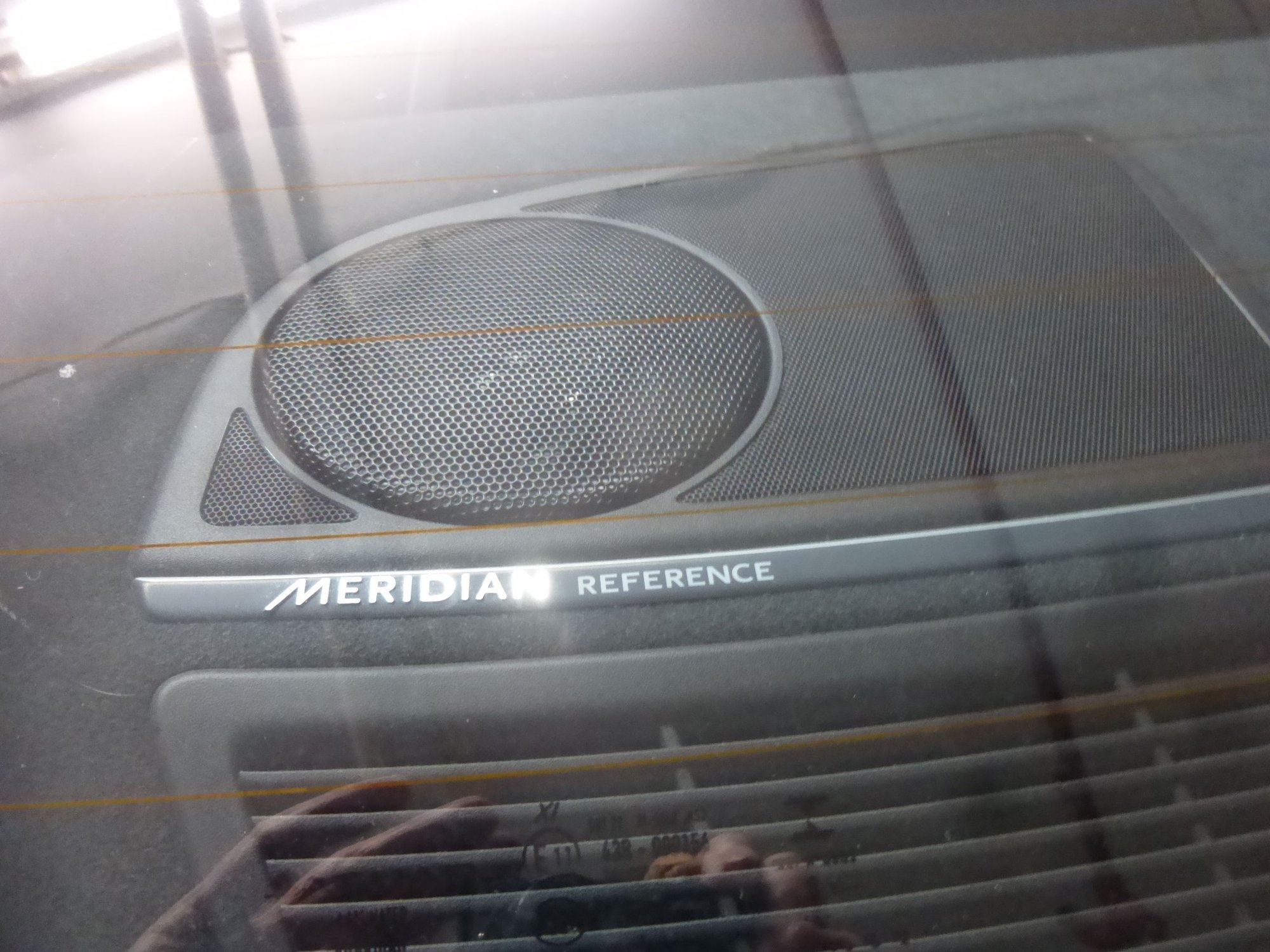

Meridian Reference system was a rare option. Doesn't it add one extra pair of speakers and different calibration compared to the Meridian Surround?
I'd upgrade that cooling system ASAP. The car is in too nice condition to have the plastic pipes explode on you.
Old Sep 8, 2025 | 07:29 AM
clubairth1's Avatar
Community Influencer
Posts: 12,097
Likes: 3,371
From: home
Yes his car has the rare reference system and you can see in one of his pictures the speaker grills located on the back of the front seats. Which is the biggest difference compared to the standard setup.
With that and the rear seat options as least in the US those are both very rare. Interesting seat color and I also have never seen that shade before.
I think all your missing is the Champagne cooler in the center section? And maybe the crystal glasses to go with it.

Originally Posted by Meanmugga
Nice find! I'm surprised you don't have the tray tables
Tray tables were not available with the Reference audio system as that space is occupied by speakers.
Yes, you can see them where the tray tables would be. It's a big upgrade over the standard system and what sold me on the XJ that I have now.

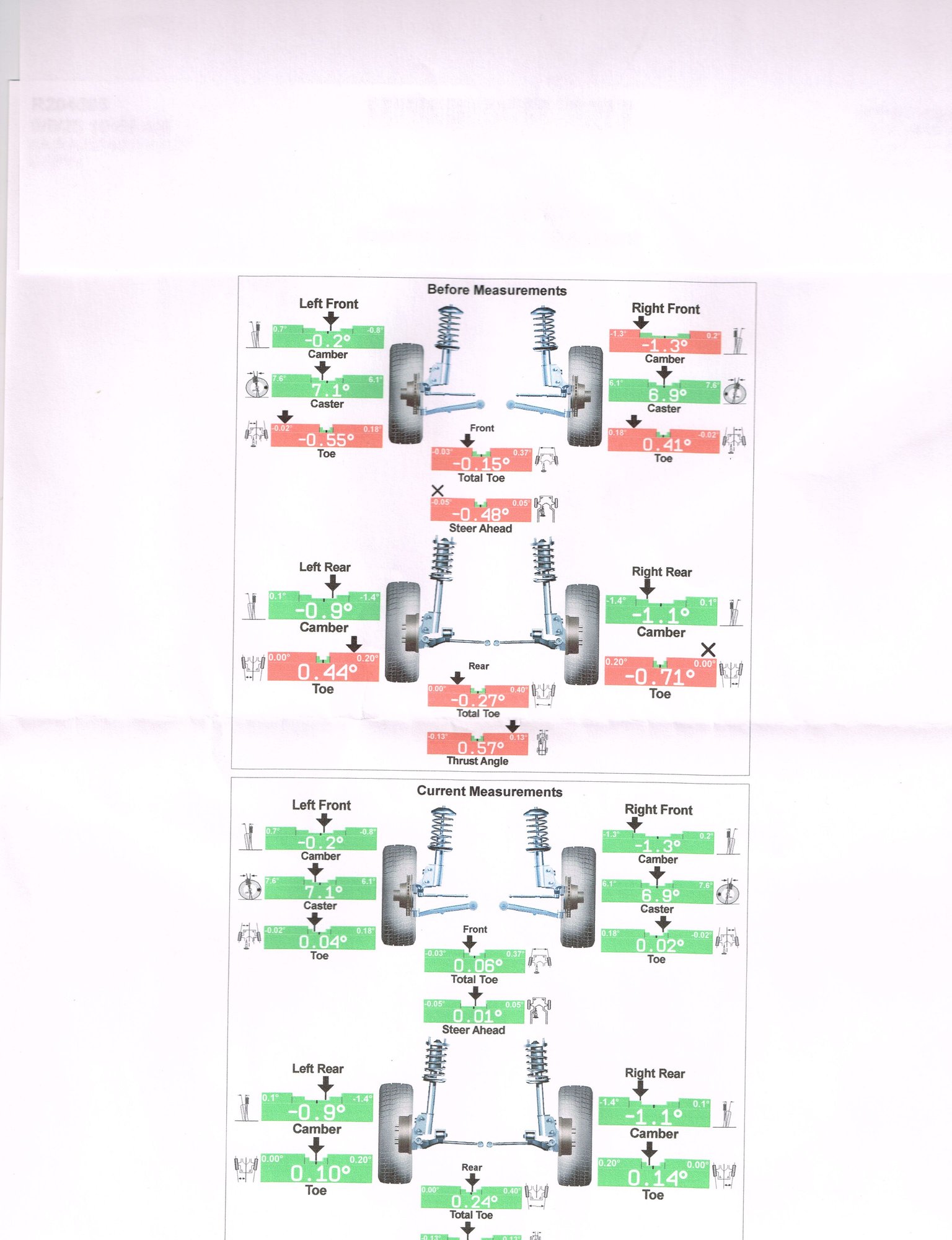

This morning I checked the alignment on the car with my good friend from Mazda and also rebalanced the wheels. I have attached the before and after readings. The car drives a lot nicer now.

Hi.
Holly God of all steering angles they were far off. x351 is very sensitive for angles.
My penny: Only Toe settings have been touched. Rear is Ok, but the front right Camber angle need bit attension. x351 have partially "hard bushing" from factory, so all the settings should be inside of narrowest tolerance area to have good behaviour (and not eating bushing or tyres out)
Camber is adjusted by lower suspension arm inner bolt and "banana" arm (front lower arm) inner bolts and are quite easyly accessible. (you need to recheck toe after camber adjustment)

We don't see many alignment threads and I have put 45K+ miles on mine in the 7-8 years I have owned it and have never checked the alignment yet. Tracks straight and true and zero odd tire wear so I have assumed it must be pretty close. With the car now at 65K miles I figure those "banana" arms will be the needing replacement in the future. Seems a lot of cars require that at or above the 60K mile mark.
Since I have staggered rims and I can't rotate them to spread the wear any misalignment should show up pretty quick. Plus with the Michelin tires I run I am replacing them before 20K miles.

My 2012 XF was similarly out of alignment when I bought it and after being aligned it ran straight and the tires showed even wear (I rotate my tires at each oil change).They were exactly half worn when I sold the car after 5 years and 25kmiles. I suspect that you take care of where and how you drive your car, just like I do, avoiding roads with big potholes etc. My new car has staggered rims so only side to side at the front and same at the rear with the tires on the car since it came with new General G-Max-07s.
One question --how reliable is the rubber hose under the supercharger?

I don't know if there is one under the SC on the 5.0L engines? Don't see anything about it in the forums like we did on the older 4.2L engines.
Got a picture or diagram of where it is?
There is a plastic piece behind the water pump, that will fail and leak over time. If the water pump has not been done, I'd replace it with a name brand pump and swap out the plastic for a metal version (along with two new gaskets) at the same time. LR028136 should get you the correct part.
