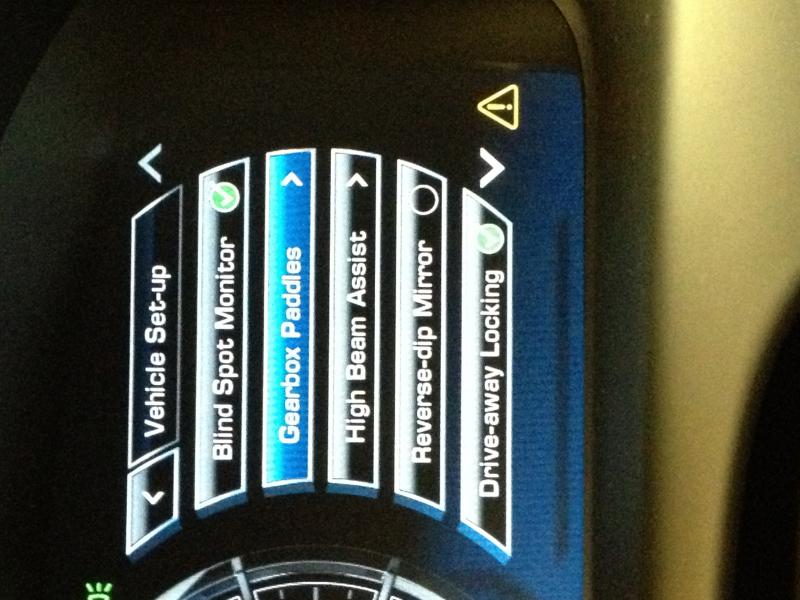

I got my car back from the dealer today after a week in the shop. They had to replace the entire instrument cluster because I was getting a false airbag warning on the display. It took a week to ship the part in from the UK.
I noticed a couple differences between the old cluster and the new -
  1. The clear cover over the display is much glossier on the new display - way too reflective compared to the old display

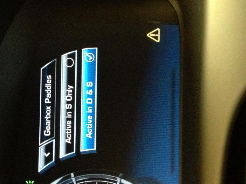

  2. I found a new menu item under the vehicle menu - the ability to enable/disable the paddle shifters so that they work in either Sport mode or Drive & Sport mode.
Last year, in a software update, the ability to use the paddle shifters in Drive had been disabled so I had to request that they be re-enabled. Nice to see that they now allow you to switch modes by yourself.
Can you please take a pic and post? Thanks.
As requested... ( Not sure why the pics are rotated to the left though - they display correctly on my PC )

does your 2012 have the gearbox paddle menu item?
No work was done on the Nav so the buttons and software were not touched on my car.
Old Nov 8, 2012 | 09:48 PM
tommyd's Avatar
Joined: Oct 2009
Posts: 422
Likes: 46
From: NJ, USA
Nope. Maybe it was introduced as a software update on the MY2013. I'd like to have the option to change the ability to enable or disable the paddle shifters as a software update on my 2012.
