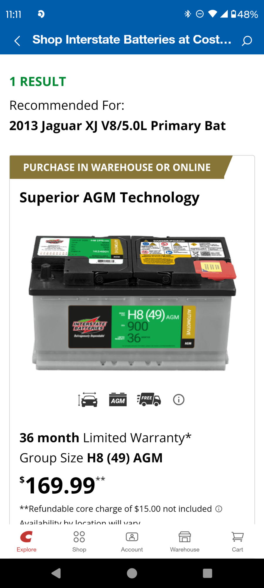

There is nothing exotic about the proper battery for the 2013 XJ - just make sure it's an Absorbed Glass Mat battery. I recommend this Interstate Battery from Costco:
P.S. There is no need to reset the BMS module, as it will reset itself after driving the car for a while. I keep mine on a CTEK battery maintainer because I don't drive enough for the alternator to keep the battery fully charged.

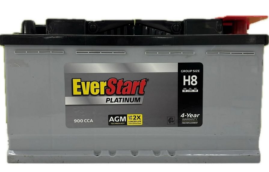

I like and use the Walmart version as it's $10 more expensive ($179) and has 1 additional year of warranty.
I can't complain as my factory battery lasted over 10 years! Let's hope these after market batteries last as long.
