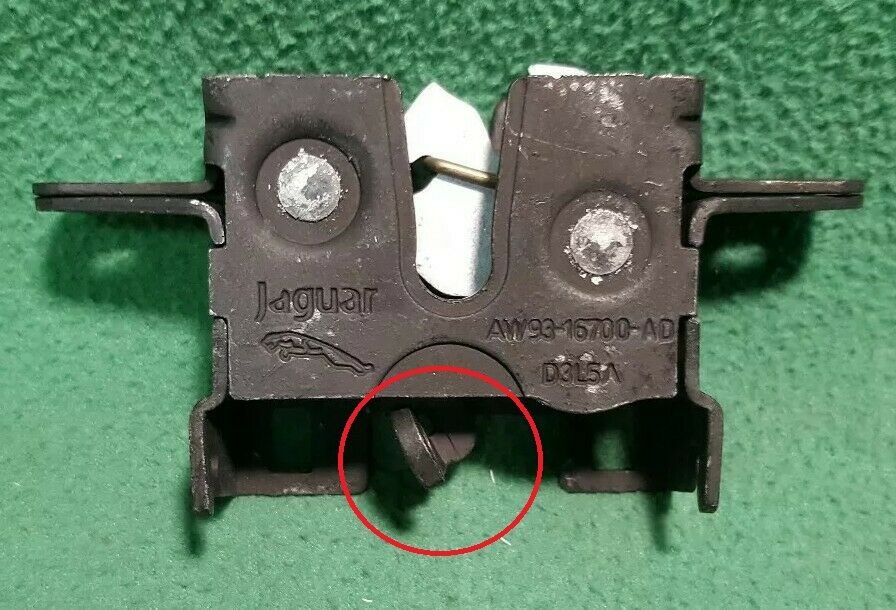

I've tried pushing down on the hood while the wife pulled the release to no avail. I'm guessing the cable is broken at the driver side latch. Driver side latch releases every time. Looking at this pic I think the only way to get it release is to attack it is from underneath. I'm going to remove the front splash guard and see if I can get to it.

Yes I usually get to the latches from underneath the car. Remove the belly pan and probably some other covers so you can get a long screw driver/pry bar up under the latch as shown above. If the cable is not broken I can sometimes pull on the release cable from under the car to release the latch.

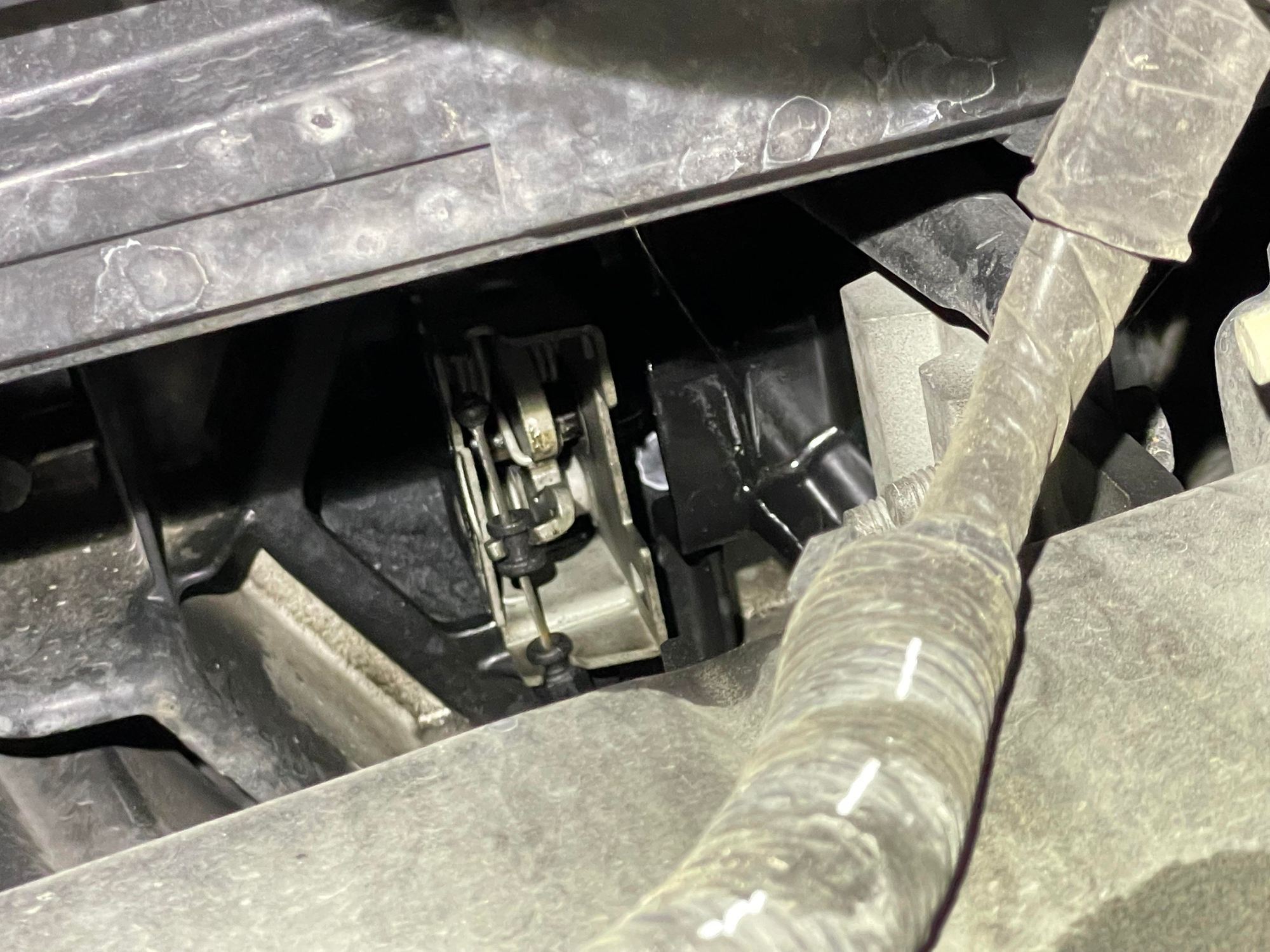

Removed the front skid plate this morning and the latch is easily accessible with a long screwdriver. Hood released when pushed from below.
Now on to trying to figure out why the latch is not releasing. The cable is actuating freely at both latches and is not bound at all. The hood bracket was a bit loose but tightening the nut did not help.

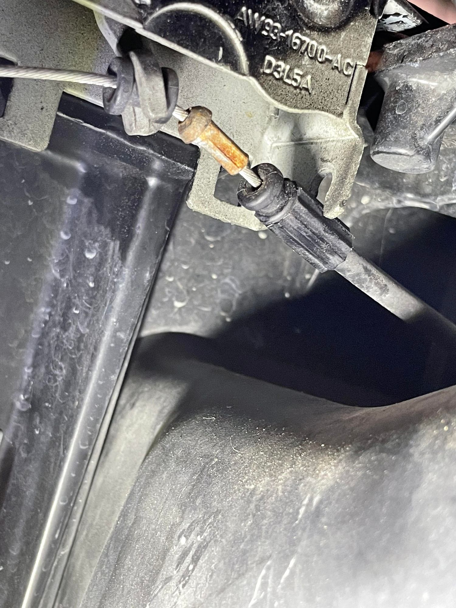

It's always nice when a repair is simply putting something back in its proper place!
Turns out the cable housing grommet (not sure what to call it) on the driver side had come off the carrier on the bottom of the latch. All that's required is to get to the the bottom of the latch and push it back on.
I had to unbolt the passenger side latch and drop it down to get some slack in the cable housing to make it work for me.
