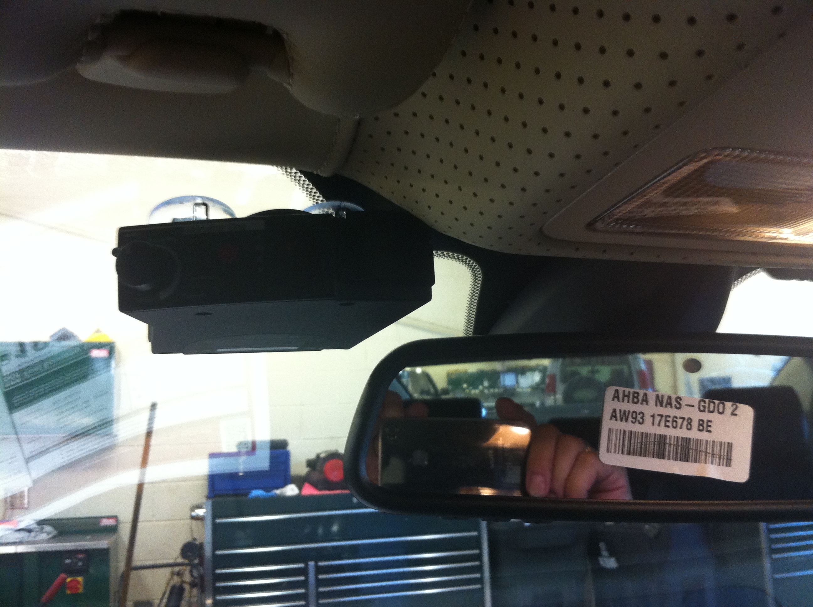

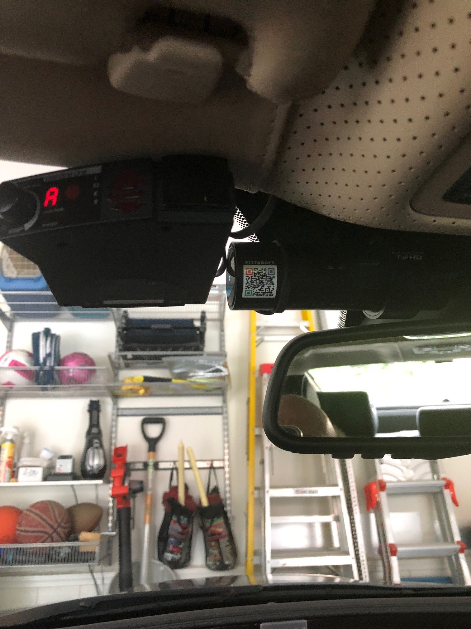

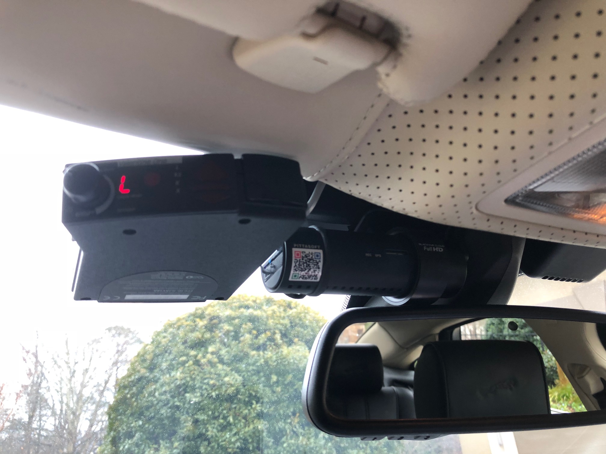

XJsss's Avatar
Posts: 1,827
Likes: 522
Mine is connected in the upper console and was done by my dealer when I took delivery on my 2013. Not sure of the wiring now as back then the lighting was incandescent and is now LED so loads may be different. The pictures are where the detector and indeed it is there now plus Blackvue Dashcam.
