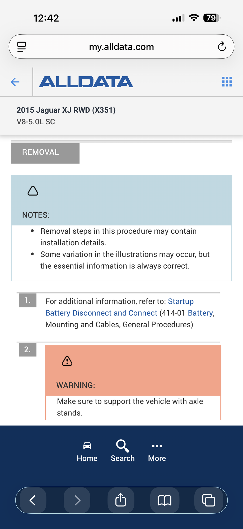

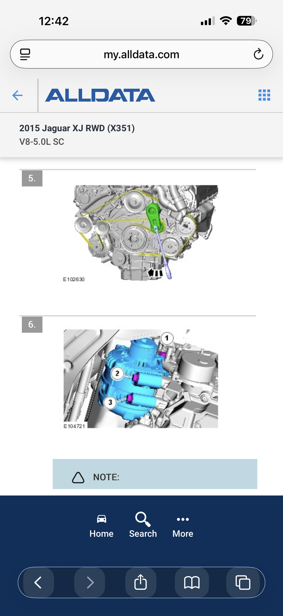

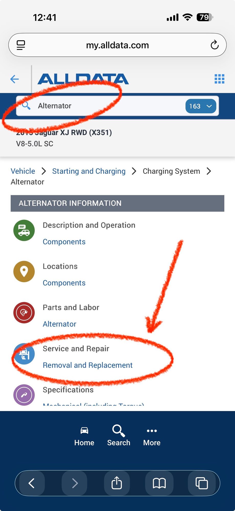

I’m not sure why you’re struggling with AllData. Granted I have a 2015 but I would assume that it’s same for most of the years.
Either way, sometimes the difficulty is finding out what they called X part in AllData. When I searched “alternator” I was easy able to locate what’s required.
