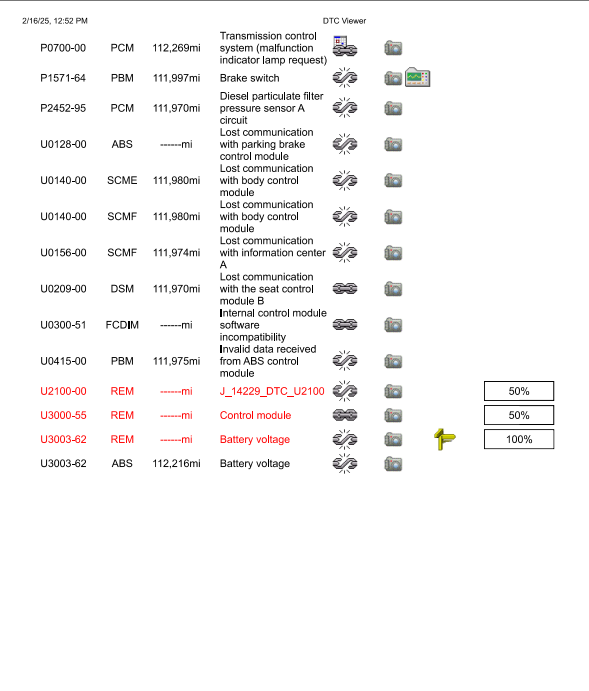

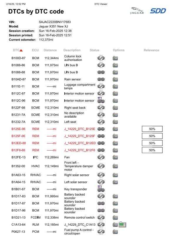

Hi All.
Recently picked up a 2011 XJL (351). Loving it although there are a few issues.
I've got hold of the cable and software SDD 165 but a bit clueless on the readings.
Attached are the screen shots, does anyone have any ideas what they mean?

What are your mileage count now? Most of these codes have mileage mark 111-112 t miles and suspect are that the battery voltage have been dropped low on these mileages and caused multible codes.

Be sure and clear all codes and then drive some more.Those might not be the current ones.

Hi Mileage is now 112500

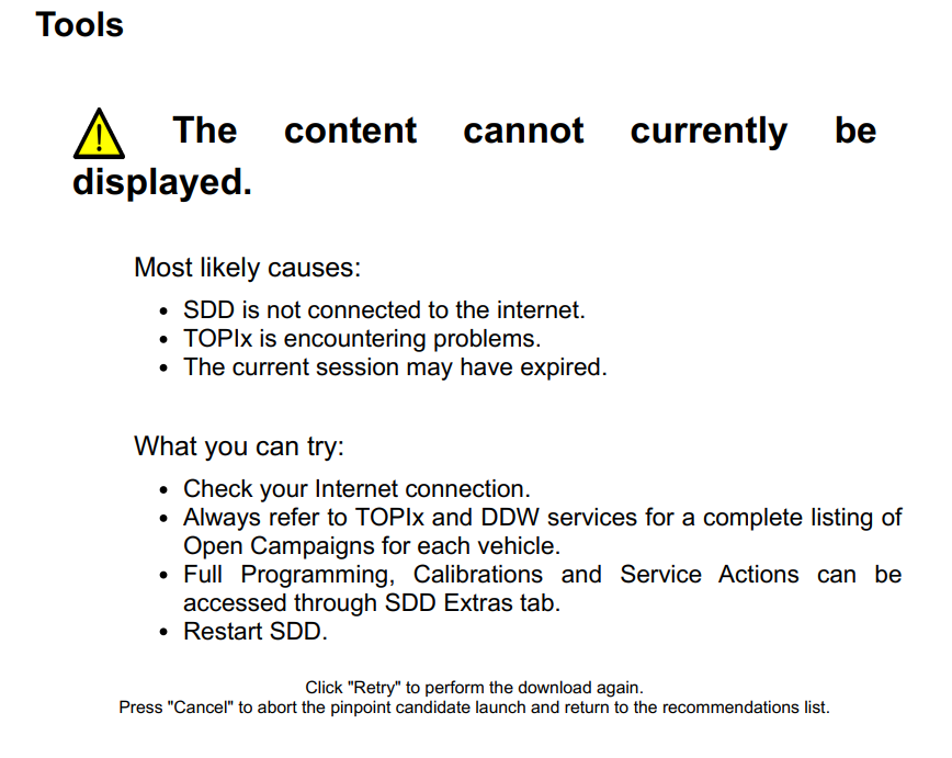

I keep getting the same errors when trying to RUN a test:
Browser does not support PAGMCP ActiveX Controls
and attached picture saying TOPIX encountering problems
I'm connected to the internet but it won't progress.
Any help would be appreciated.

SDD MUST use IE for the browser. What OS are you using?
What does SDD say when you try to download updates?
I recently ran into a cluster with SDD. I had a fully working Win7 Pro SDD setup. Connected to the Internet and always could download all updates. But apparently Jaguar has shut down the Win7 servers and SDD now requires Win10 or above. That was the first big mess trying to upgrade from Win7 Pro to Win 10 Pro.
After all that the next problem is Win10 only can use Edge not IE anymore. So you need to fiddle with Edge and make some changes to force it into a IE compatibility mode. This again was fairly complicated but I manged to get it done with some instructions I found.
Not sure if this is your problem but do post back if possible.
