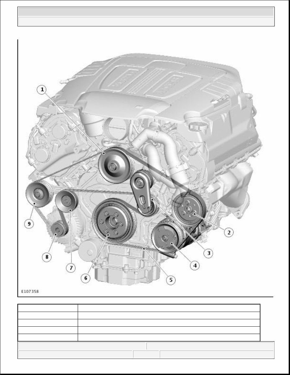

You get the belt off by releasing the spring tension on #3 in the drawing. Then it just unravels off the pulleys. Getting it back on is not hard just tedious.
If you haven't done it before probably best to get some help - a shop could do it in 15 minutes or less.

Also - to access the belt, you need to first remove the top engine cover. You lift-up on the front end of it until it releases, then pull forward to remove it.
Then you have to remove the air intake ductwork.
For the Naturally Aspirated (NA) engine, there is one worm gear clamp on each side, where the ductwork meets the air filter box. Loosen the clamp at each side w/ screwdriver or nut driver & pull back on ductwork until it comes off of the airbox (MAF sensor with wires stays with the airbox side).
There is one small bolt (10mm) that secures the ductwork to a metal bracket at the top-left side of the ductwork. Remove that bolt & when removing ductwork (after the next steps), pay attention to guiding the ductwork out from under that metal bracket.
Then there is one more worm gear clamp where the ductwork meets the throttle body. Loosen that clamp too, and wiggle the ductwork CW/CCW to pull free from the throttle body.
Then there is a vacuum hose that connects to the right side (as you're looking into the engine compartment) 'inboard' of the ductwork - you have to look at the lower-backside of the duct to find it.
This hose is released by squeezing the two sides of the quick disconnect connection on the hose & pulling it from the ductwork connection.
Then there may be a hose routing clip under the left side of the ductwork that the cooling hose is kept in place by. Before pulling the ductwork out of the way, make sure the hoses are clear of the keepers that are on the bottom-side of the ductwork.
After those are released, the ductwork should easily be removed (remember to guide it out from under the metal bracket by pulling it forward enough to clear it) and set-aside.
Be careful to NOT LET ANYTHING get into ANY of the air ducts that are now exposed. You could cover them temporarily with sandwich bags or something if you like.
With that out of the way, you can easily see the belt.
Since you're there, you may want to go ahead & replace it unless it's been replaced within the last few years. Belts are pretty cheap. Paying someone to replace them, not so much.
And maybe the same with the air filters, at least check them out since you've got the ducts off of the air boxes.
Put force on the tensioner in the correct direction to relieve the belt tension, if it takes a lot of force, it's probably the wrong direction. IIRC it takes a 1/2" (or was it a 3/8"?) drive ratchet (I use a breaker bar) into the square hole on the tensioner that's there just for this purpose.
BE CAREFUL with your fingers (of course), not that anything will bite you in there, but just general safety.
Re-installing the ductwork & engine acoustic/vanity cover are just the reverse of removal.
I don't think I forgot anything.
