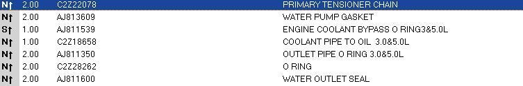

Hey Z20!
I have a list from a 2011 XJ 5L we did the timing chains on. I put your vehicle into our parts look up system and it looks like the timing chain, timing chain guide rails (upper and lower) and the chain tensioner are the same as the 5L. The valve cover gaskets are different: part numbers AJ813020 right AJ813023 left. Some of the parts on this list we had to replace once we were doing the job and noticed they were cracked, brittle etc. Anywho, here is the list from our customer's repair order!
I hope this helps! Sabrina
