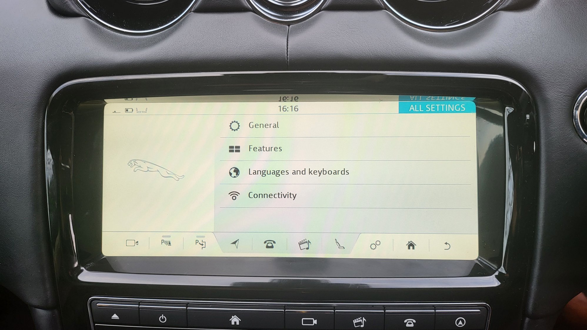

Hello,
I am new to the forum as a member, even though I have been reading a lot about the XJ from the forum for a while
I recently took the plunge and bought my xj (autobiography) and it's the version with the 10.2 screen. However, it's not the latest system update (android auto...). When I tried to follow the steps for system update, I don't see the "software update" to click on.
Which from various search on the Internet should look like this
Does this mean I have to take it into the dealership? If so, what am I asking for?
Thanks and apologies if someone already asked the same question before.
Ojay

Luckily you have the 10" screen, so you will likely have a 4G system, meaning that the 3G sunset shouldn't bother you. You probably need to be upgraded to a more recent version of software (I believe that H251 was the relevant update) which will give you the SOTA capability.
Thank you for the feedback! Will take it to Jaguar dealership and request the H251 update. Will post my feedback once it's done
