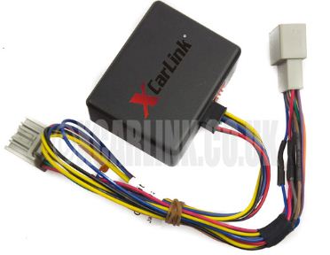

Nice write up...I have the Carlink version. Video in Motion...an Easy DIY upgrade-carlink.jpg which cost $169 incl shipping
Great idea using 3m tape to secure it. I wish I had thought of that

I sourced it from an ebay seller in the UK back Oct 2014. Unfortunately the Carlink version is no longer available on Ebay. You can get it directly from the manufacturer in the UK for $230 or as an alternative you could source the Caraudio version on ebay for $183 incl shipping from Portugal.
