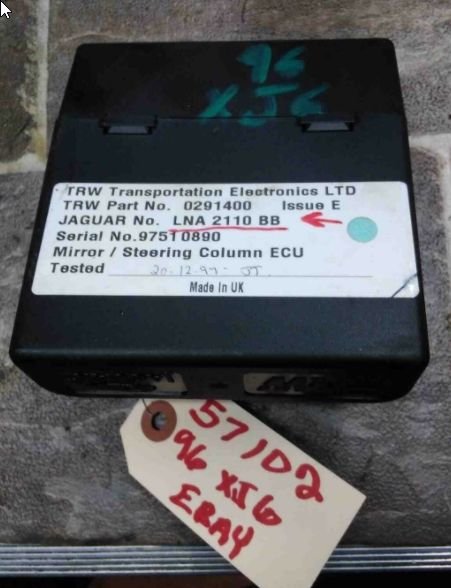

I can find the motor JLM 20194 all day online. But I only see used C/MCMs pulled mostly from XJ6's, that "seem" to state they will work in my XJ12, and have these part numbers: LNA2110BA or LNA2110BB.
So, my question: If I buy used, how do I know if I'm buying the "
improved column/mirror movement control module"? Maybe the stripped modules online are the previous "non-improved" versions. How can I tell if I'm buying 'improved' or 'not-improved'?
Anyone know the difference between LNA2110BA and LNA2110BB?

A photo of a used Control Module available online. Improved or not?

All I rremember from when I was with Jag, Parts Manager.
LNA2110BA, was superceded to LNA2110BB.
My assumption would be that the BB is the next generation module, BUT, there was never mention of other items needing changing to install it.
Any part that was "updated" and required "this and that" to be installed AT THE SAME TIME, was always clearly stated, and usually in RED so you could not miss it.
My "R" had issues with that module, and I sourced a known good used BA (lotsa $$), its still in the shed, as my unplugging and replugging the BA in the car, while waiting for the BA to arrive, fixed the female moment it was having. Cars gone, module is still in the shed somewhere?, that could be a fun search.
This might help you??
https://shop.everydayxj.com/XJ6_X300...-lna2110bb.htm

Wanted to say thank-you Grant, I replaced the motor and while in there saw the module was the BA version. Swapped in a BB version. All working now! Thanks.
