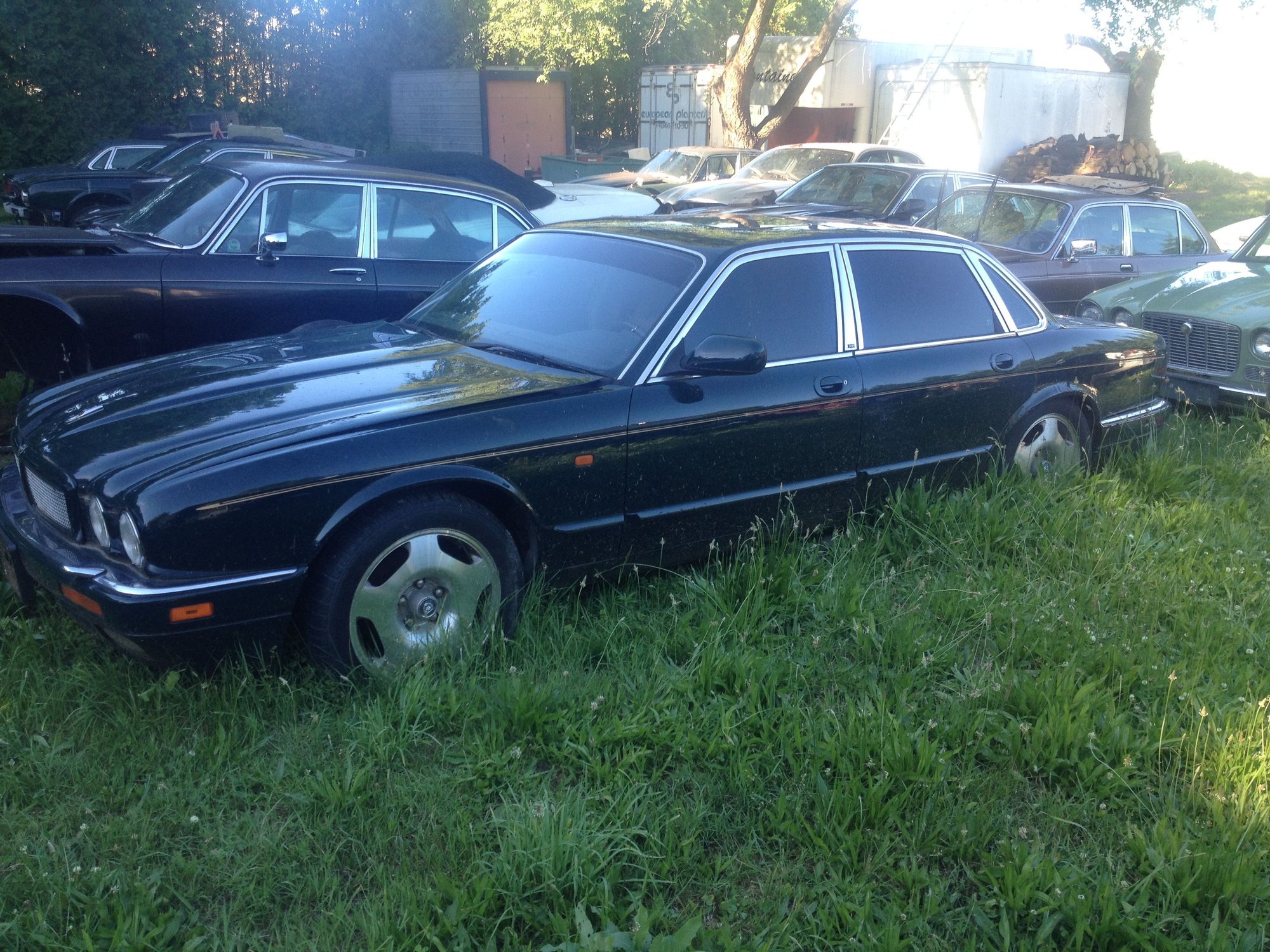

I bought a '96!
Hello folks,
About 8 years ago, a friend came over with his newly bought '96 XJ12. He let me drive it; the only one I have ever driven. I thought wow of course. After driving S1 XJ's for 35 years, this was a jet!
Unfortunately the fellow suffered a mild stroke, had his licence revoked, and sold me the car.
I didn't get to put it up on a hoist or test drive it.
I got it home and looked it over, runs nicely, 109,000 Miles (a USA car), cheap paint job, minimal rust, some driver's seat movements don't work, needs 4 brakes, cracked windshield, needs brakes, AC weak, leather needs dye, headliner of course, coolant tank was low, needs throttle rod bushes, transmission mount thumping, lot of wheel speed related vibrations. But of course, I'm in love with it! I'm just retiring from teaching, and want all the Jags.
I was pleased to learn (thanks DD) that all the X300's had the same brakes, because I have a new set on an XJR6 I have in my private bone yard. I want to swap in the R shocks too, as these are shot. I'll use the R front sway bar if it's bigger. The rear bar would be nice, but I know that the diff bracket has to be changed too. The shocks should make a big difference; now I can bounce the XJ12 about a foot up and down all around, whereas the XJR6 will barely move no matter how hard I try.

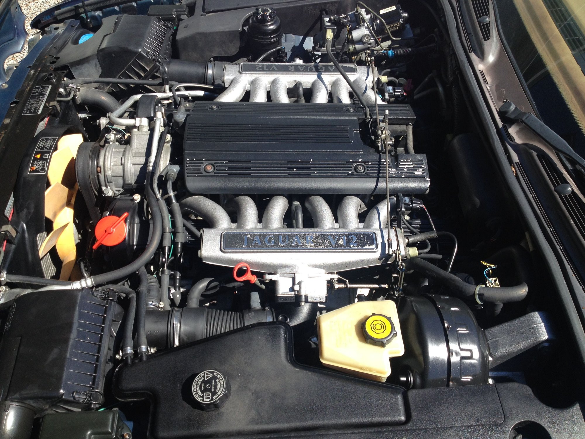

I'm worried the coolant loss could be the evaporator. I see a film on the inside glass. Is there any quick test? I know people here frown on Barr Leak.
The rims are shabby. Has anyone had luck painting them?
The leather dye should be easy, as I'm a distributor of these products in Canada. NDR Cream.
I'll send pictures as I progress. If anyone has any tips, please tip-away!
Cheers,
Rob

Windsheilds come in 2 versions for the X300 heated and non heated . Depending on which option you want to go , if it is currently heated there will be 2 extra relays behind the left side left foot small panel .
The clearcoat on the wheels being 22 years old can be removed by aircraft paint stripper back to bare metal but must be removed from car
Your V12 engine coolent diagram is on page X . Best to go ahead and change the thermostat as they fail closed and you have that covered .

I really like the Saphhire blue on these cars. Get some wax on that finish so it will last as long as possible. You've got better things to do than repaint right now!
Non-heated windshields are readily available. Shop around for the best deal. But be wary that some replacements do not have the VIN opening in the right position. The edge masking on the new glass might cover the VIN, so check that out before installation.
Two thermostats: 88 deg. C only! You'll need 2 of the triangular thermostat housing gaskets too. While you're at it, replace the main radiator hoses at least, for now. All of the major radiator hoses are available from Uro Parts via Rock Auto and Ebay. They are quite inexpensive. BE CAREFUL with the hose fittings on the radiator. They are aged.
