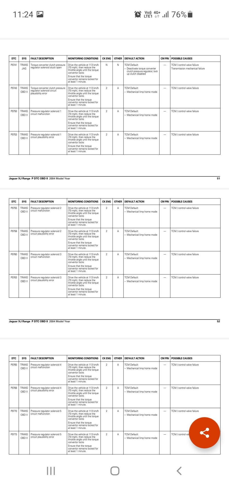

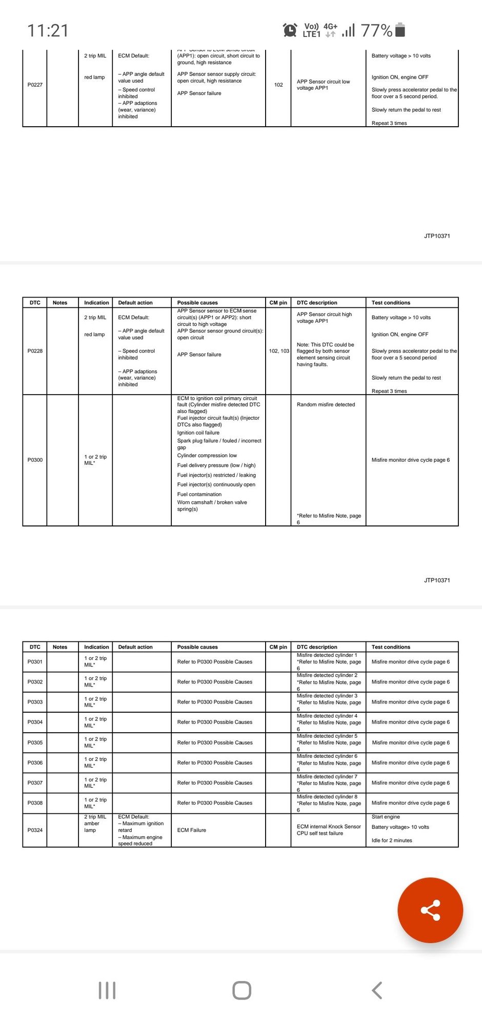

First guess batterie ,check with engine off 12,5 volt it should be ,engine on 14,6volt so the alternator works properly.
check your grounds in the front right and left behind the headlights . Carefull those break off easely ,clean them with a brush or sandpaper reconnect
I do have some time and check if I can find more info related to the codes the codes.
there are downloads available in the x350/358 forum , scroll a bit in the stickies

Did you change your ignition coils lately?
