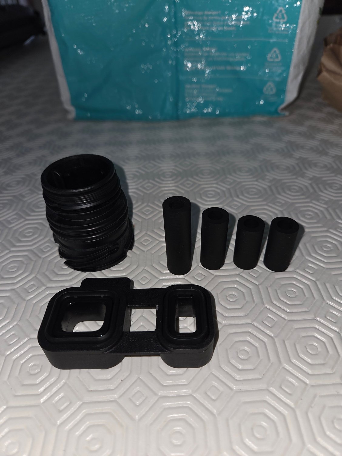

Inner parts bridge seal tube seals and connector sleeve that can be changed during a normal oilchange.
1068.298.062 is a Zf oilchange kit 7 liter pan filter magnets screws
videos are available " zf6hp26 oilchange and level procedure"
