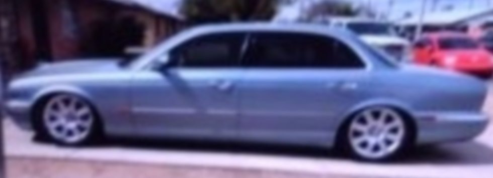

These cars are VERY sensitive to low voltage, and by "low" I'm talking 12.1 instead of 12.3 can trigger some of the failures and diag codes. Mine wouldn't sit for two days without telling me it that Cruise was not available, or cannot set parkbrake. All of that nonsense went away with a new Diehard battery.
These things take a monstrous battery, by the way, 900 cold-cranking amps capacity.
The car in your blurry picture is sitting on the bump stops, which implies fairly serious issues with the air suspension. Maybe because it sat for months, but maybe because the air suspension system is shot. It might rise right up and be fine once you get it started.
As others have said, don't worry about the long list of codes. Clear them all, put in a brand new battery, and worry about codes that appear after that.
If the air suspension remains problematic, I would strongly recommend going with replacement coilovers and abandoning the air system. The air system on these cars is well beyond its design life, and while there is a dryer in the compressor, it's not serviceable without disassembling the compressor, which nobody does, so I can pretty much guaranty that there's water in the air system, and there is NO WAY to remove it. Valves will rust and freeze up.
