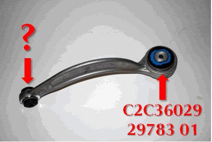

As far as I can tell from the parts catalogue the lower shock bushes (factory fitted spherical joint) are not the same front & rear. They have different part numbers.
Spherical joints are fantastic until they wear out, when you get a metallic knocking sound from them. Sounds familar?
FYI a number of the other bushes are originally made by ZF Lemförder, and you can buy them from ZF, here they are referenced to the Jag part numbers.
C2C26267, C2C26851, C2C36029, C2C4471, = 29783 01, Control Arm Bush, Front Axle, Lower, Left and right, Front, inner (the big one)
C2C4437 = 29784 01, Control Arm Bush, Front Axle, Lower, Left and right, Centre, inner
C2C4438 = 29785 01, Control Arm Bush, Front Axle, Lower, Left and right, Centre, Outer
C2C12119, C2C18350 & C2C36866 = 35353 01, "Damper Bush" Control Arm Bush, Front Axle, Lower, Left and right, Centre
