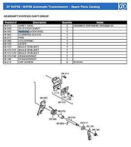

The gearshift interlock is simply to prevent the transmission selector from being moved without having your foot on the brake. It doesn't lock the transmission, only the selector.
In the ZF, the transmission is locked by the Parking Lock Disc which is engaged when the selector is moved to Park. Selecting Park with a moving vehicle can break this or the spring on the shaft.
There's several selectors and rotary switches listed for the X305. Just because they look the same doesn't necessarily mean compatability.
