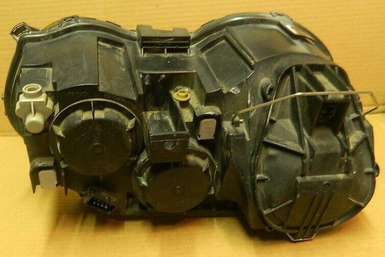

Here is the back of an Xenon head lamp;
You need to get access to the back to remove that wire bail and get that plastic panel off. You need to be careful and NOT apply force in the wrong places. Also note that the wiring inside these head lamps will be cooked and very brittle from the intense heat. The insulation will be falling off. It's all plastic so probably no shorting out but do take a look. Try not to touch it if possible.

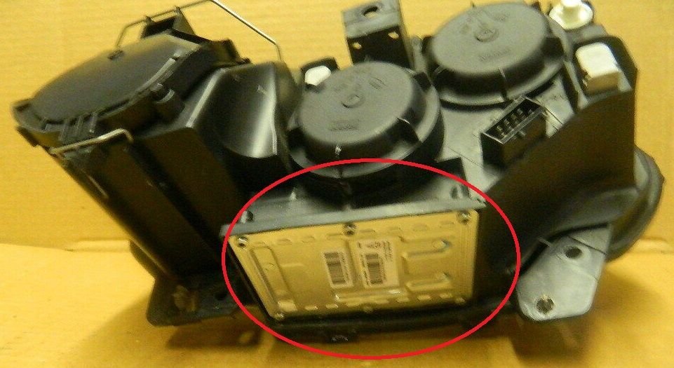

Here is where your ballast is;
Again you need the head lights off the car to work on them. Please stop trying to do it otherwise.

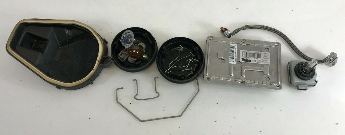

Here are the parts shown spread out. Note the 3 items on the right. You need to swap these items side to side to find the items that have failed. The bulbs do age and I would for sure replace both bulbs regardless. The ballasts I don't change unless they fail.
