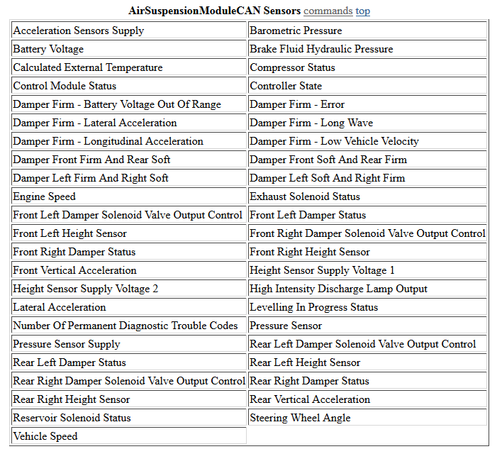

I have the AutoEnginuity module Lagonia. I tend not to use the software unless I have a bug. I've run full diagnostics on mine and no error codes so I haven't putzed with the software much. Maybe this spring when I wake my kitty which won't be long now.
Here is the software's functionality related to CATS in case you didn't have it.
