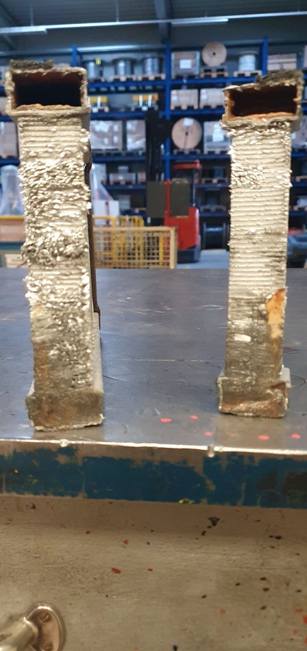

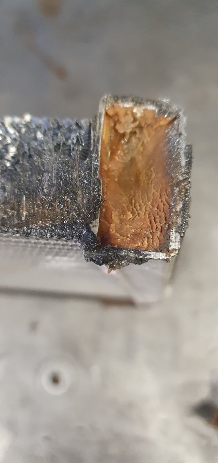

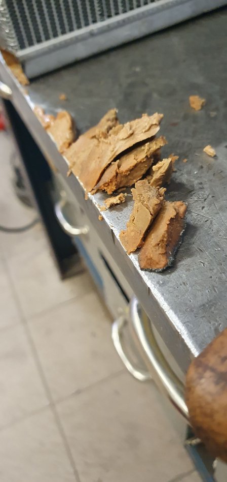

Oat or for europe G12+ silica free is the coolant that should be used , as water only use distilled water please even if you have a leak.
white sand in the radiator might be aluminum oxide. Some of us know what it looks like when moving the side mirrors on older xj's white powder falling on the paint.
easist exchange of coolant can be done over the expansion tank with running hot engine ( no bleeding needed). Stop the hot engine , open up the lid carefully to release pressure , unplug the hose on top of the expansion tank do not damage the tiny nipple , shove a tinier transparent hose into the hose to purge any coolant coming from the engine into a 5 liter container or a bucket . Have 10 liter of distilled water ready to fill up the expansion tank gradually while the coolant is being pushed out . When done with the destilled water continue with filling with 5 liter or more of coolant OAT / G12+
this is what can happen if Coolant is wrong or in the circuit for way to long and naturally tap water can do damage too... this is the heater core of an xj6 2003 with 142.000km no heat inside cabin
