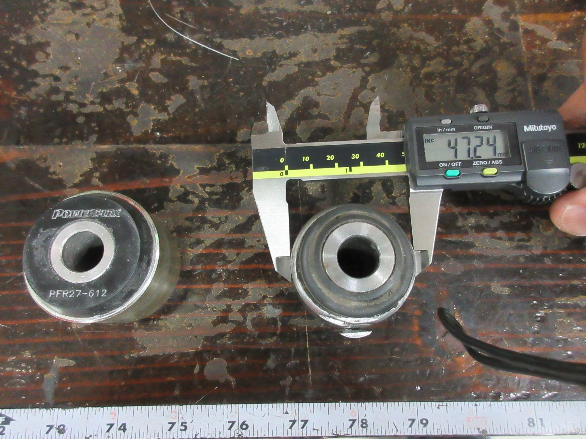

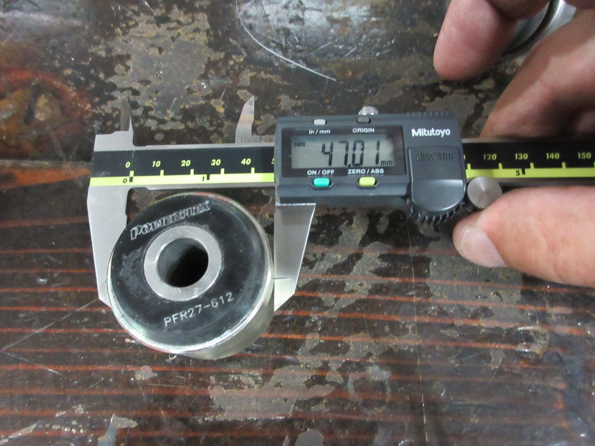

Last week I bought PowerFlex control arm bushings which cost a pretty penny to replace the crap hydro-bushings in both the lower control arms on my 2004 XJR. I had replaced the bushings about 40K miles ago and they went to hell. I believe I got them from flea-bay so, ok, I got what I paid for.
Since I had to do the job again, I went for the polyurethane bushings from PowerFlex so I did not have to do the job again... ever. The bushings are definitely of good quality but unfortunately they did not appear to be machined correctly. All of them took very little power and one of them (the 59mm outer one) you can flop it in and out by hand which makes it unusable.
Have any of you had any experience installing PowerFlex bushings in your vehicles and did you have any similar observations?

So I have been going back and forth with PowerFlex's warranty department exchanging pics and such but their claim is that their bushings are manufactured for proper interference fit. I have taken the measurements below with my trusted Mitutoyo caliper many times (Powerflex vs the original that came out of the arm) and always come up with a 0.25mm narrower width on the Powerflex bushings. So pretty much $300 down the drain. So caveat emptor! I would not trust that company.

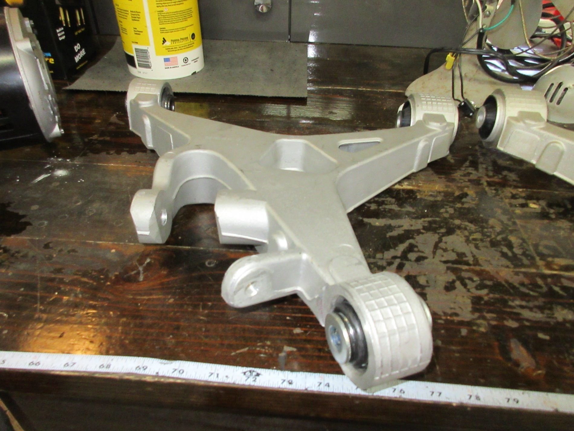

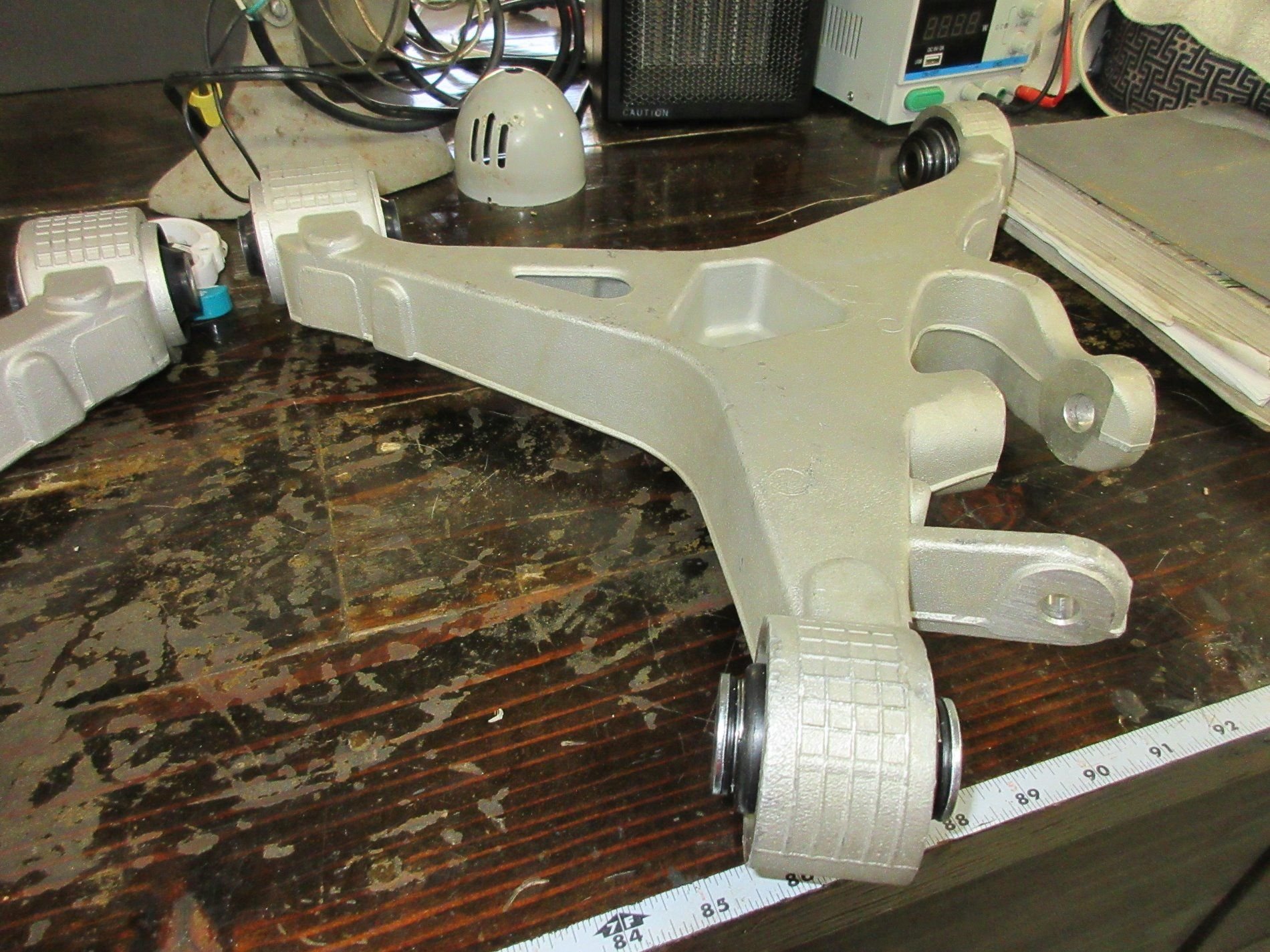

So obviously I couldn't keep the car on the lift indefinitely. Gave up on installing poly bushes for now and I purchased control arms from Amazon as shown below and the fit was superb and exact. So, for my 2004 XJR, the Doorman control arms 521-937 and 521-938 are a perfect fit. They are installed and drove the car for about 100 miles with absolutely no issues!.

I have these on my car but my NA XJ8, my STR has X351 arms.
30k miles and they're holding up fine. Shocking for a Dorman part.

Lemforder/Jaguar/Ford set the bar very low on lower rear control arm quality. My originals were in a danger to drive condition when I purchased the car.
Never seen a car that had all the suspension rubber completely disintegrate in 9 years and less than 100K miles. Only the subframe bushings were intact.at that time we had an Audi and BMW same age with perfect condition Lemforder suspension parts. At least rubber boots. The A8’s wear out front upper control arm bushings due to using the same arms in A4, A6, and A8. A front end heavy car holding up a V8, V10, or W12 with 4 cylinder car suspension.
May be heat, I have heard repeatedly thefactory hold up fine in Canada and Europe. Or different rubber composition.
I was so pissed at Lemforder that I used Monroe, Moog, and Raybestos brands that used to be high quality replacement parts. But used Ford for all uppers, rear lowers, and toe links. Some had Jaguar cast into the arm.
They are seven years old now. Rubber on the toe links is going, rest look fine.
But with factory items being disposable parts the Amazon, eBay, Rock Auto sure are looking better.
BTW, I try to avoid Dorman. But after Discount destroyed the third wheel stud I found out they are OEM for Ford wheel studs. They are still Dorman crap. Discount manages to destroy one about every second tire rotation. Last time the stud spun in the hub. That was painful.
I would have to rate the PowerFlex as junk. Your undersized bushing May explain the squeaking. Metal on metal. But not having to press in sure makes install easy.

QUOTE: always come up with a 0.25mm narrower width on the Powerflex bushings.
You can use grades of Loctite and similar ( anaerobic ) products that will fill that gap and be very close in performance to an interference fit.
Note that these products cure differently with steel to steel contact as opposed to steel to alloy contact.
In some instances these products provide a better fitting solution than the conventional interference fit.
The reason it is not popular with manufacturers is that it requires more care to clean the components for fitting and also more time to do it.
There can be two problems with this approach:
1. It is not always easy for maintaining concentricity of fitted parts.
2. The cure process can be too quick for allowing everything to be tightened or lined up properly.
I would guess in the case of rubber bushes concentricity is not a major headache, and fitting is quick.
