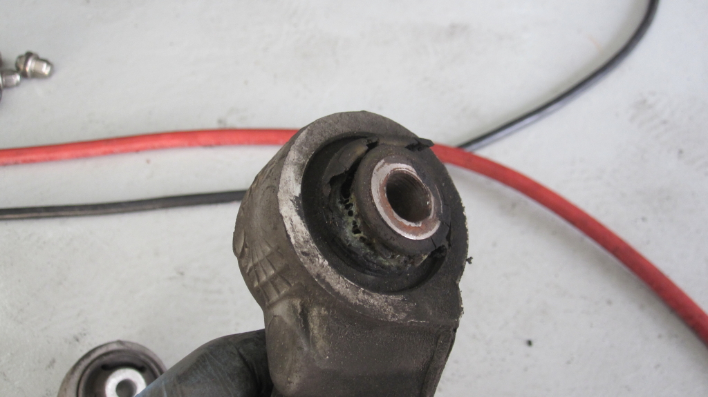

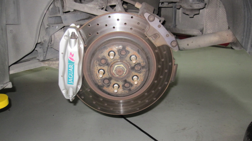

After taking off the wheel, brake caliper, parking brake caliper and rotor I realized that the movement experienced was due to a bad lower wishbone arm bushing... looking at JEPC there do not seem to be available separately.
More headaches on the way.....

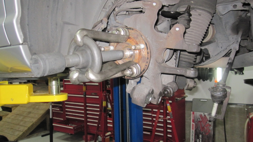

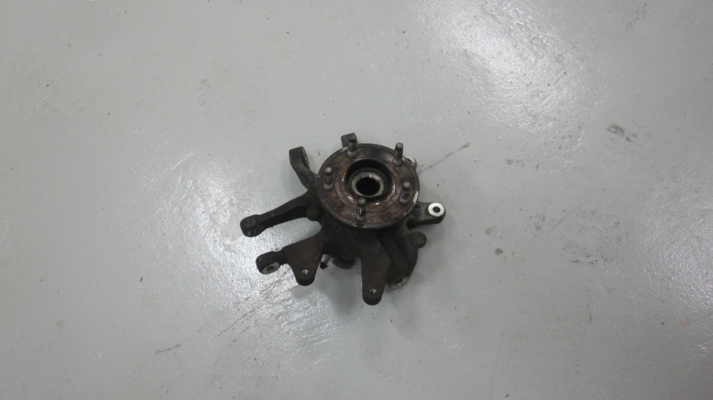

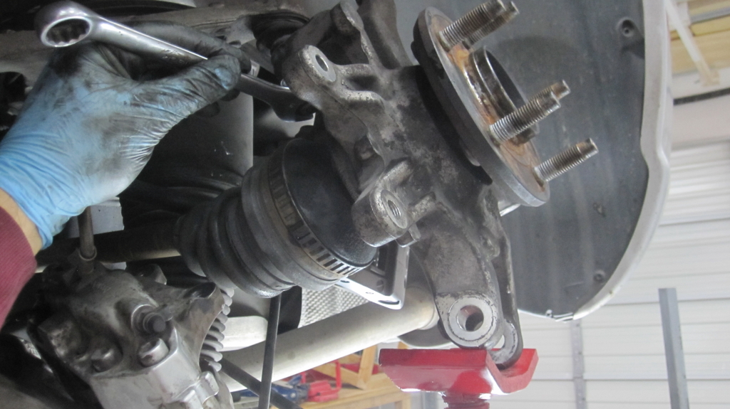

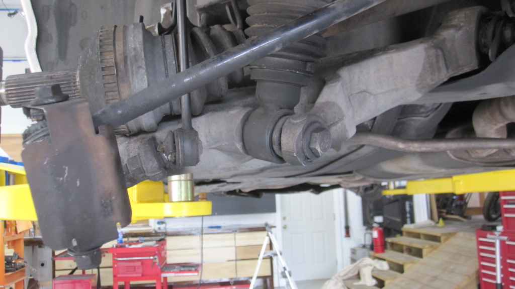

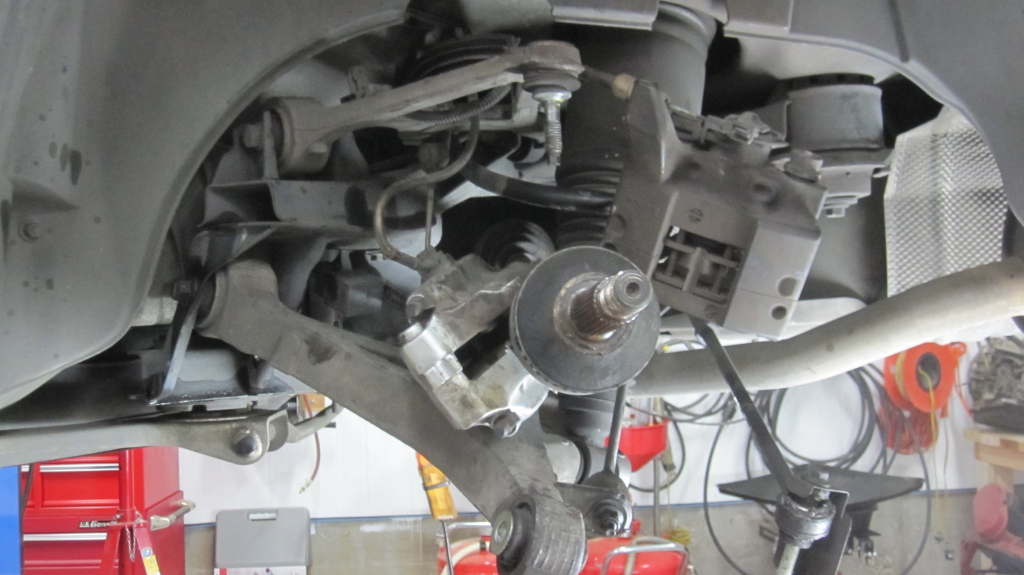

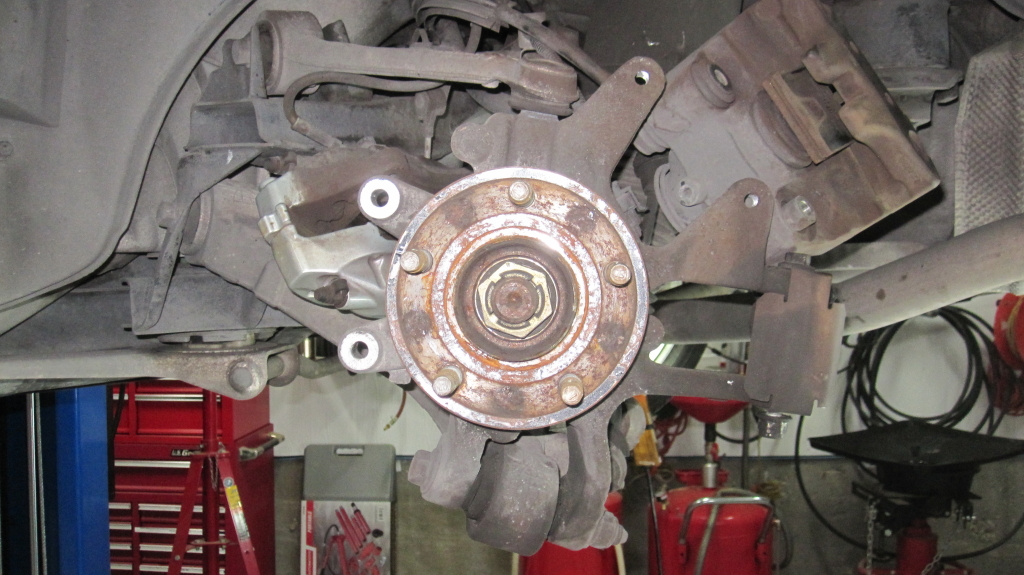

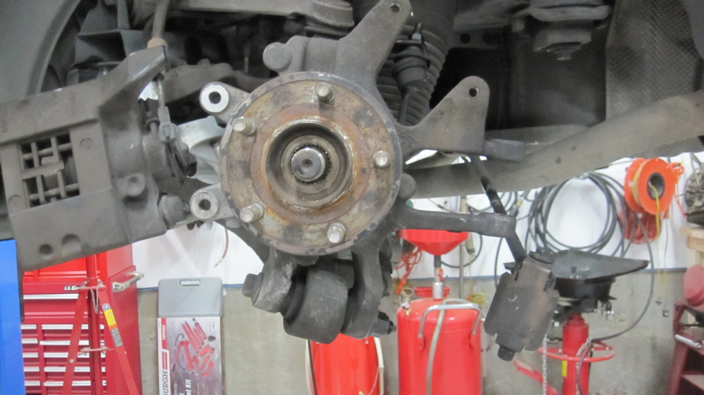

Actually, the bearing is also bad big time. I removed the hub carrier/wheel hub assembly and sure enough the bearing is noisy and loose; the lower arm bushings are toast. Got my work cut out for me:

Just recently done the same thing, at the same left rear wheel. Initially thought on rear diff.. the noise was like train is taking of like airplane at around 80km/h But my indy said without a doubt - left rear bearing. replace. What expirience means. I think it was damaged when I used car with top nut loosened at balljoint on the left top rear arm. I was lucky it was not lost completely.. the feeling on road was like gliding on power boat and that time i thought that was that differentiates jaguar from other cars
Old Apr 9, 2014 | 06:47 PM
meirion1's Avatar
Joined: Nov 2009
Posts: 3,145
Likes: 804
From: The beautiful Mornington Peninsula in OZ
https://www.jaguarforums.com/forum/a..._9294small-jpg
That is some puller!
You need something like that because I know that the hub can be very tight on the driveshaft splines.
That monstrocity of a puller coupled with a healthy impact gun does the trick every time.

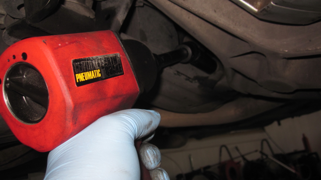

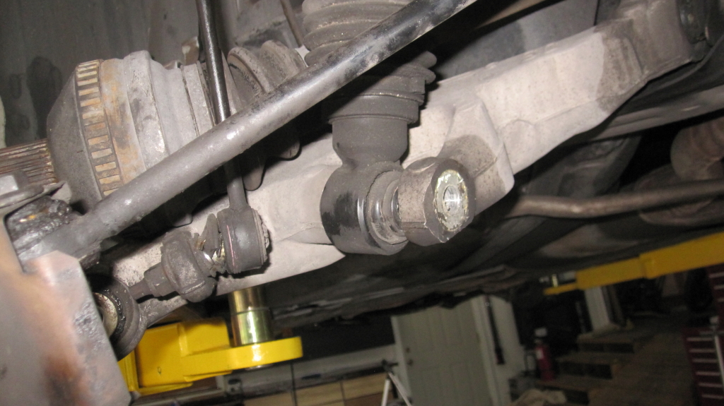

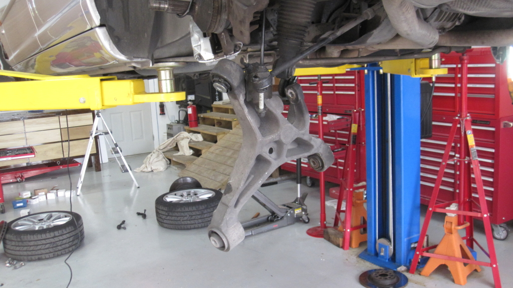

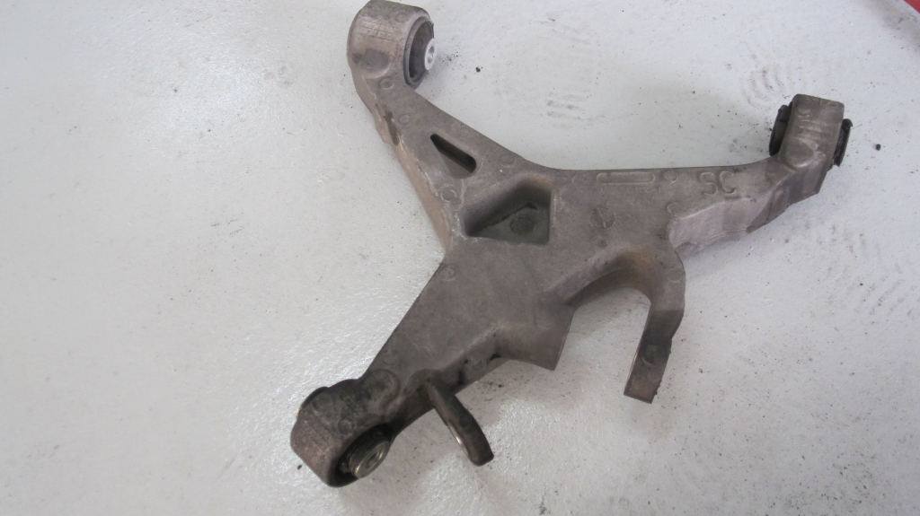

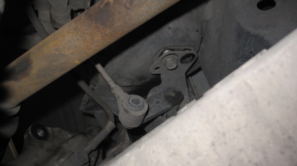

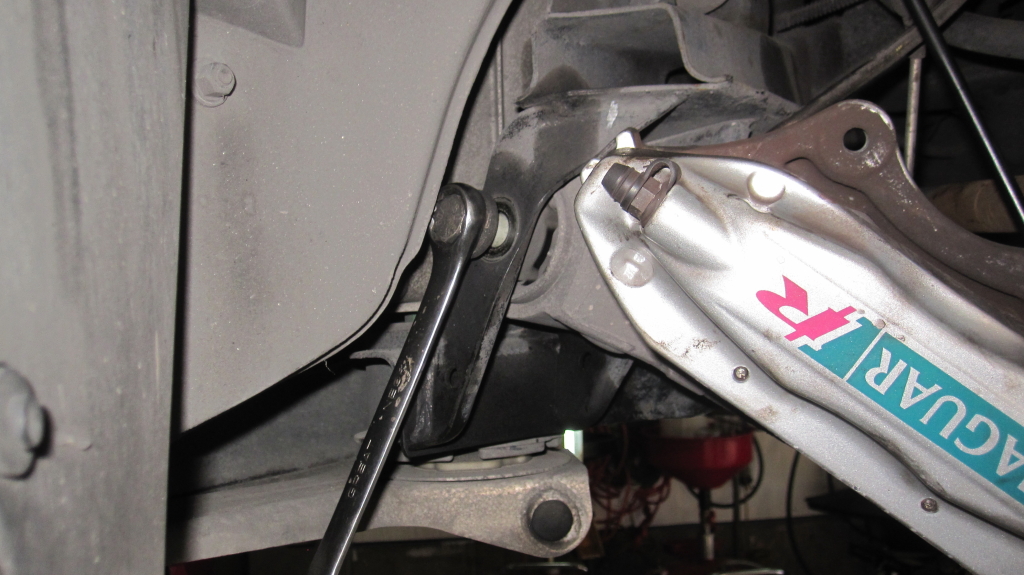

Removing the lower control arm, once the hub and hub carrier are out of course, did not prove to be a big deal. The lift is not needed for sure. Impact gun *really* helps but it is not necessary:
Remove the bolt holding the shock absorber to the lower control arm:
Remove the rear back arm bolt. Impact gun is a life saver
Remove the rear shock absorber height sensor and push it out of the way to get to the rear front arm bolt.
Oops. Forgot the stabilizer link. No prob, just unscrew it and you are done
Done

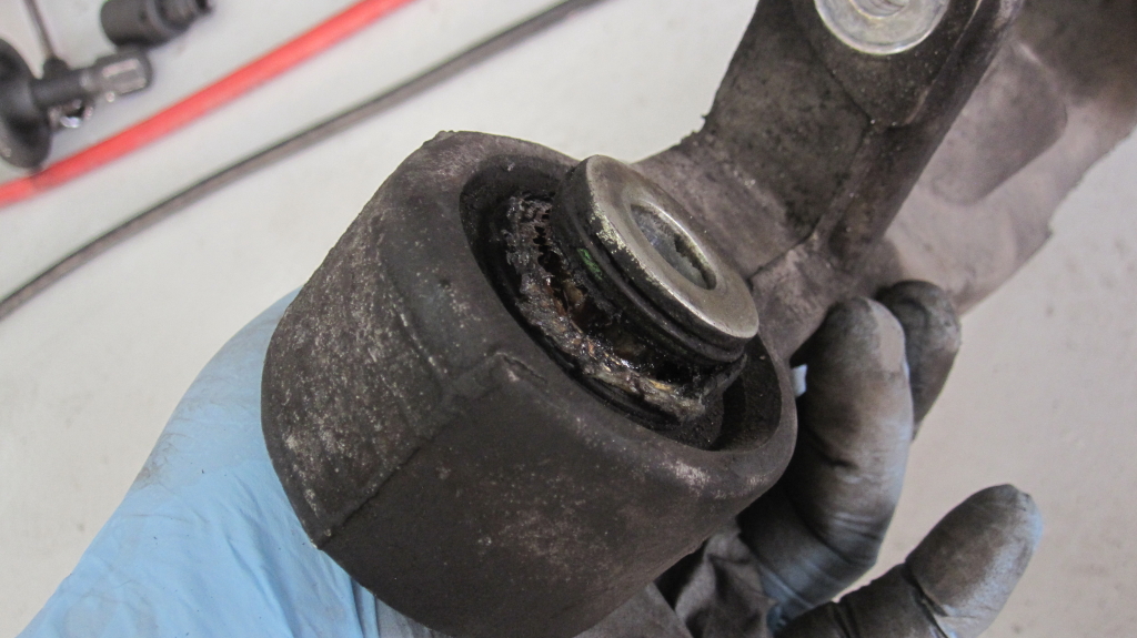

Bad bushing
Bad bushing

A tip
When pressing out old and pressing in new bushes, pour a couple of kettles of boiling water over the aluminium arm. Aluminium has twice the coefficient of expansion of steel, so it will really ease the task of pressing.
Funnily enough this was told me by a chap in a Jaguar main agent ! As we all know, Jaguar will not supply the bushes separately, claiming it is a safety issue. Frankly I don't believe it. If done correctly, there is no hazard as thousands of Jaguar owners with replaced bushes can testify.
I see the ball joint boot on Lagonias anti-roll bar link is also knackered, and maybe the ball joint too !
All that hardware is on order and will be replaced.

A tip
And put the bushes in the freezer for a while to reduce their outer circumferences.... Some advise to leave them overnight, but I've found that they give up their heat and do most of their contraction in the first 30 minutes or so.
