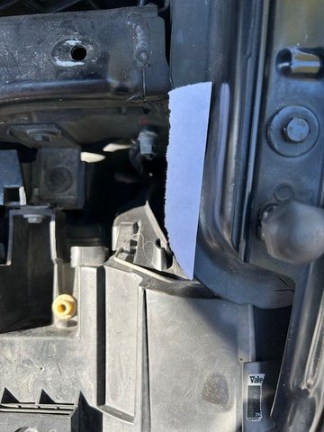

Like many I've passed a few relaxing afternoons attempting to replace a HID bulb in one of these. I've managed to back out the inner Torx screw but the outer is hidden by the fender/wing flange. I suppose I could remove the bumper cover as directed but it occurs to me that the flange is just sheet aluminum, why not get out the tin snips and trim it back? The flange doesn't appear to be structural, removing it might give me just enough room to maneuver. I've placed a scrap of paper on the flange to indicate where I could trim to gain room to work. I would drill a hole in the inside corner to eliminate any stress risers of course. Thoughts?

left side?
no tools required just pull the plastic cover off
Yes, left side. That would make it easier, thanks. I'll look into it. That was a quick reply!

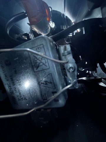

Inside the cover you should see the HID lamp secured by a clip. There is a small silver rectangular connector to remove. Undo the clip and pull the HID lamp straight out.

Here is mine, I may be trying to make things more difficult though. Seems reasonable that it would just pull off once that clip is released. I've been unscrewing the little Torx screws, which is very difficult.
Reply 0
Mar 14, 2024 | 07:15 PM
No, that holds the whole clip on. On the other side of the bulb, just unhook the wire clip, and you will see that the part you show is the hinge. In your picture it opens from left to right like a book. Tighten up those torx screws!
