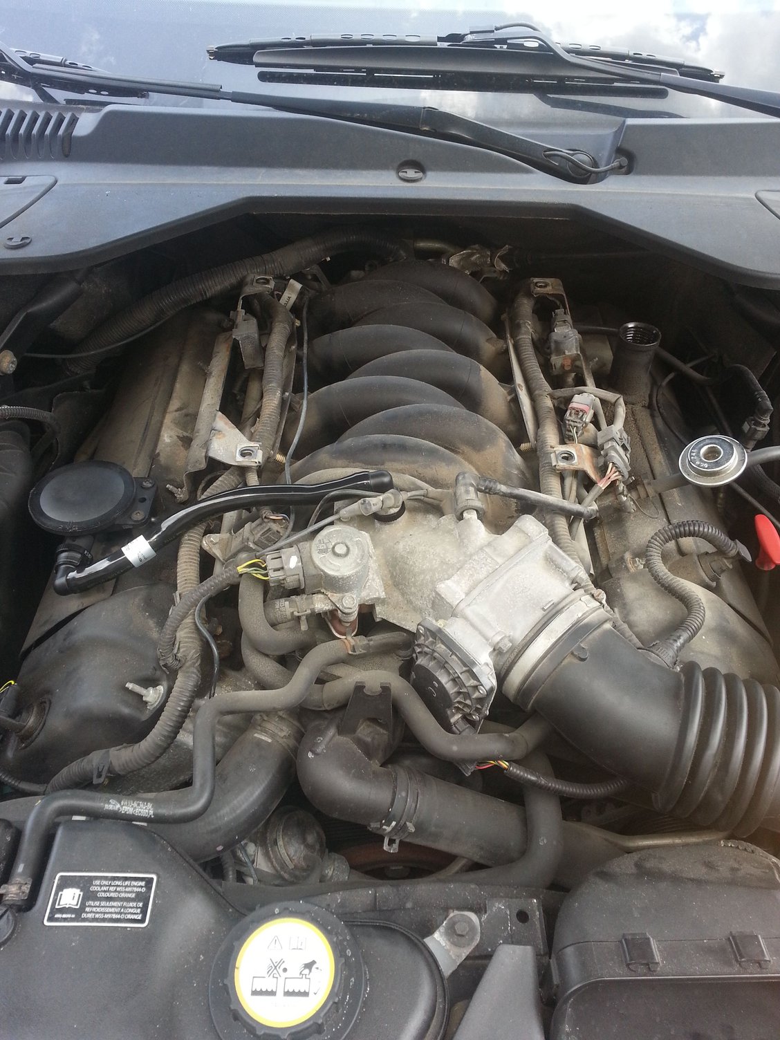

Thanks edobernig! Very useful stuff! So I've taken to collecting and replacing pieces on the car in attempts to cure my CEL and P0171. First was my MAF sensor, which gave me a few hours of somewhat normal driving. Whilst waiting for my PCV and connecting hose to come in, I started experiencing very rough idles. At this point I decided to park her and not drive until the problem is solved. Valve and hose have now been replaced, though I want to be very thorough with this. I don't know what hose to pull off for a smoke test (cigar method, don't really want to spring for a several hundred dollar smoke machine) so I'm attaching a photo, if someone could steal the image and highlight what I should remove, it would be greatly appreciated!

Thank you 34by151! That's a great little machine you made there! I'm working on making one today, any suggestions on where to inject the smoke from? OBDII only reads P0171, not paired to a P0174.

Remove the intake tube from the airbox/maf and plug the end
A plastic lid from a bottle will do but a quick search of the kitchen (while the misses is not looking) will yield a perfect cap.
Punch a hole in the cap and inject the smoke there
This is also the same bank as the P0171 so it will show the leak quicker thank bank2
Remember to check the smoke output now and then as well incase the oil runs low
This will show up most vac leaks fairly quickly however I have had to resort to using a vac pump to chase down some leaks.
The process is longer and slower but will always get to the leak
Basically you attach a vac pump and gauge, same a charging an a/c system
Vac down the system and leave it 30 mins, if it looses vac you have a leak.
Tricky part is hinting it down by blocking tubes or testing off the car
34by151
