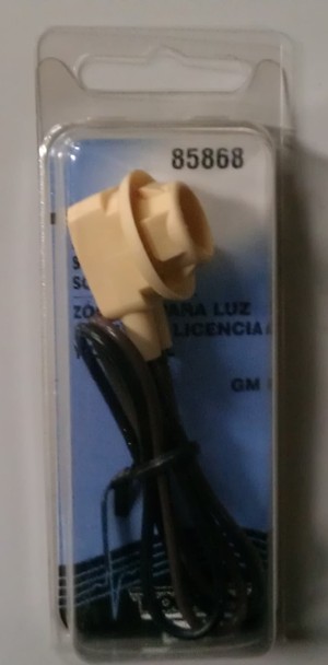

Replaced my marker bulb-holder with this item from Auto-Zone at $4.
Attached Thumbnails 2008 rear side marker replacement-marker-light-bulb-holder-fix.jpg

Hey reyesl, on that part you used to replace the bulb holder, by that do you mean he little base that twists into the actual side marker? I have a 2004 XJ8 and the inside of the bulb holder/base rusted and I can't find a replacement anywhere without buying the entire side marker, which I don't need.

Yes, that part replaces the bulb holder. You may also try your local auto wrecking yard for a used one from a VW.
