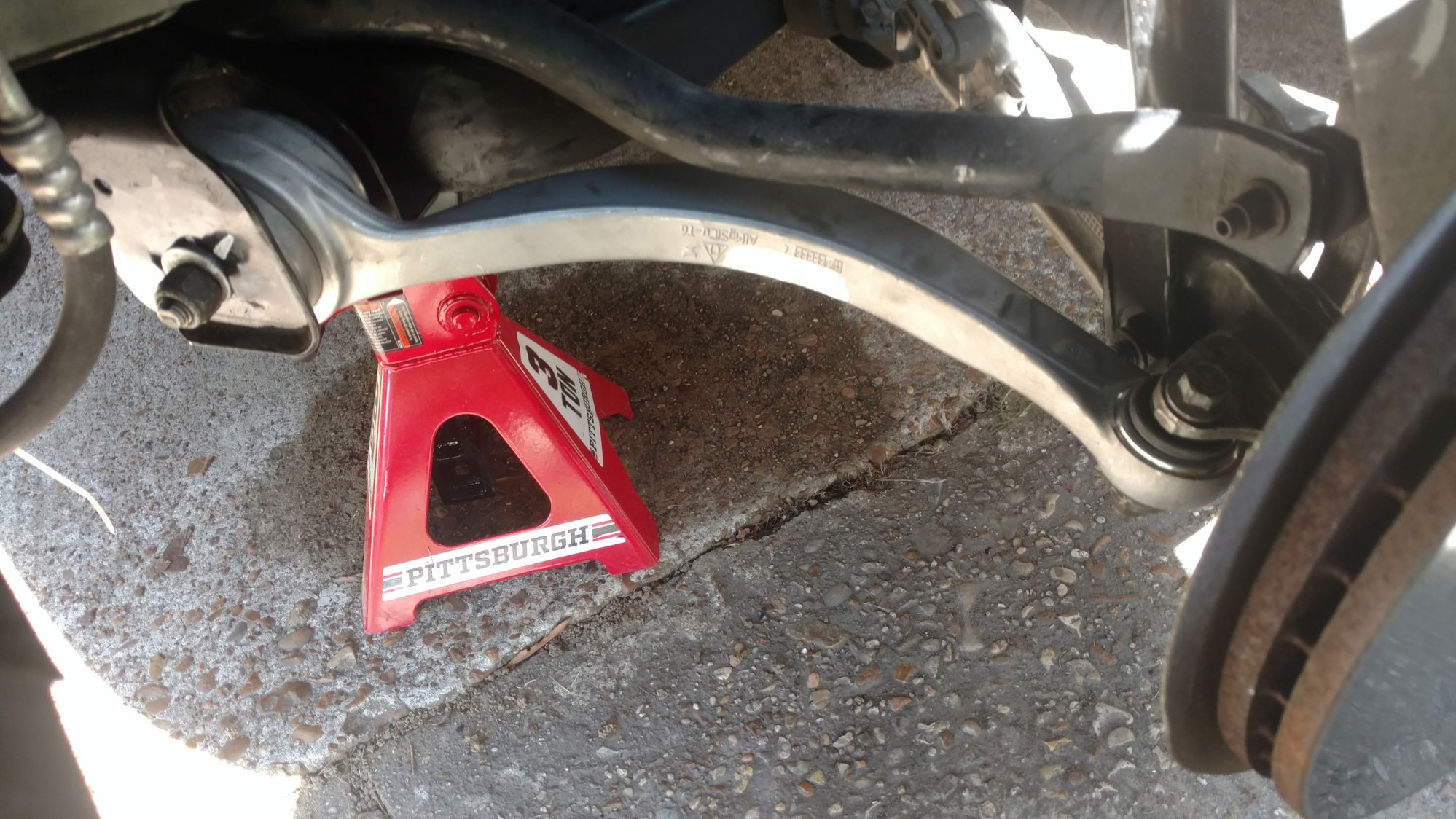

So I got my driver's side front lower arm replaced today. I'm still experiencing a CLUNK - but perhaps it's a bit better now? Anyways, the tools needed for the job:
Jack, jack stand(s), wheel chocks, and ramps
18mm and 15mm box wrench/spanners
21mm socket
18mm crowfoot or 18mm deep well socket
Torque wrench (45 ft lbs outboard bolt; 130 ft lbs inboard eccentric bolt)
Steps:
1) Loosen lug nuts on the corner being repaired. Place wheel chocks, jack car up; then place jack stand(s). Remove wheel.
2) Mark eccentric bolt position on the inboard side with paint pen. Loosen with 21mm socket.
3) Loosen outboard nut with 18mm spanner/socket. Hold bolt head with 15mm spanner. Remove inboard & outboard bolts, along with control arm.
4) Replace arm. Remember - the arm curves INWARDS towards the car I had to pull the arm off & correct this.
5) Replace outboard bolt/nut with new hardware. Tighten to 45 ft lbs, then another 135° to ensure tightness.
6) Install eccentric bolt on the inboard arm. Use 18mm spanner to return alignment with your markings. Hand tighten, then tighten until snug (perhaps a proper spec is 65 ft lbs until the car is on its own weight?)
7) Reinstall tire. Remove jack stand(s). Lower car.
8) Set ramps in front of car & drive into ramps. Ensure eccentric bolt is still correctly aligned. Tighten inboard nut to 130 ft lbs. Back off of the ramp.
9) Set appointment at the alignment shop!
I so far skipped step 6 - new outboard hardware, and step 9 - realignment. I drove ~10 miles, which is not advisable per more experienced users. Still experiencing a CLUNK from the front left corner. Perhaps I have more bushings to replace, or the air compressor, or my calipers not having the retaining clips.

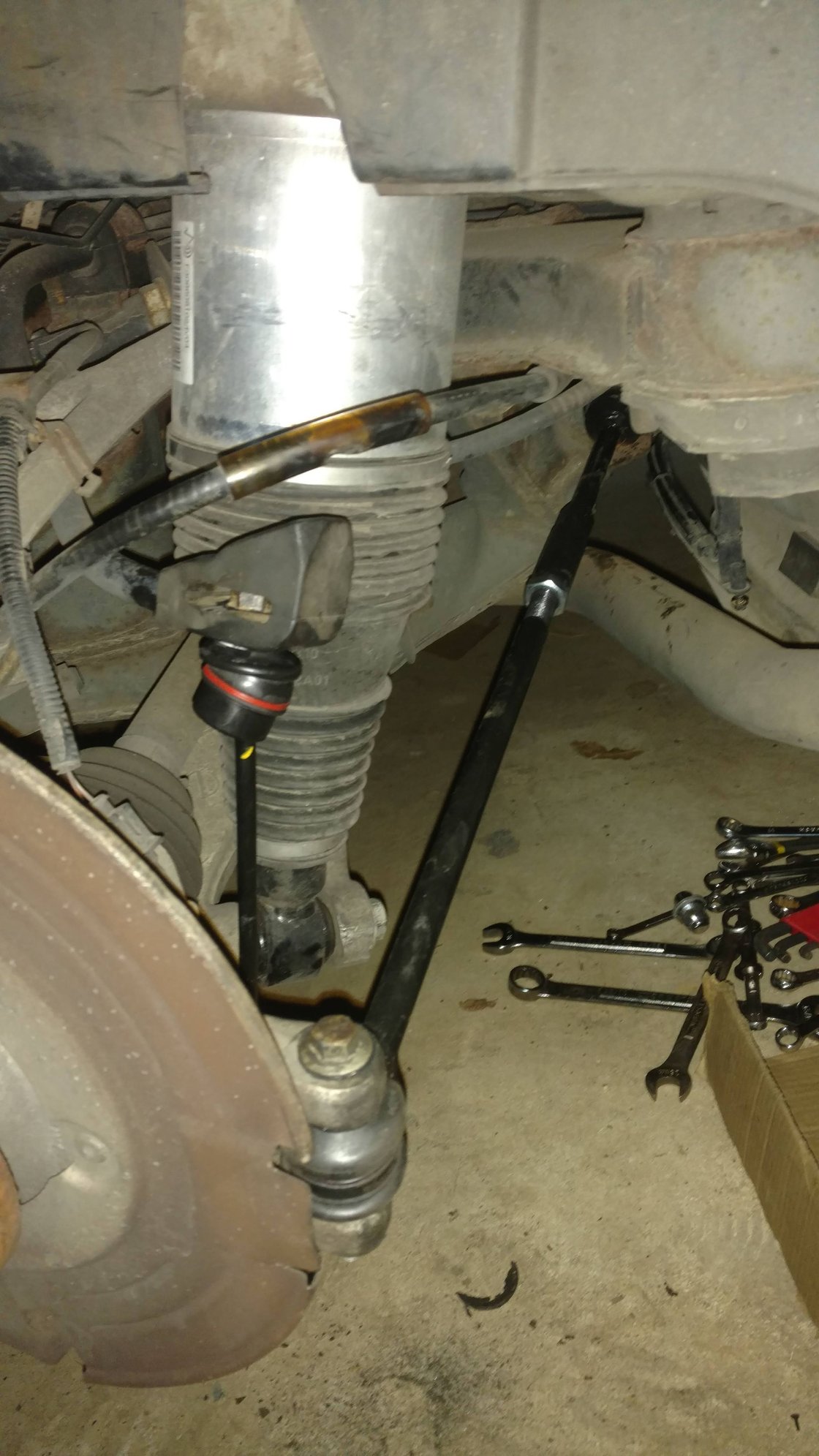

Quick update - my CLUNK was resolved by changing the sway bar links all around. In my opinion, this is the worthiest upgrade to date I've made. I did rear lateral arms while doing the sway bar links, and resorted to a hack saw 4 times to take the rear links & lateral arms off. Still worth it
