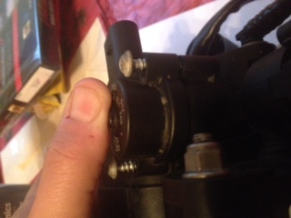

Here are some pictures:
The vent solenoid is a rubber/magnetic shaft spring loaded in the solenoid. The spring applies pressure to the rubber shaft to seal the vent hole in the dryer assembly.
The ASM activates the vent solenoid w/ 12V (based on "12VDC" listed on solenoid) to retract the shaft into the housing - I bench tested and the shaft wiggles slightly downward upon applying 12V. (not sure if this is normal operation) I would imagine so as it wouldn't take a lot of movement of that shaft to get the air to vent out.
This is from my 2nd hand unit. Upon inspection I found the white flaky stuff was kind of binding the shaft from retracting into the solenoid housing.
To save time - I removed the vent solenoid from my original unit and fitted. (This is held with 2 torx bolts. (Don't over tighten... haha...)
Not sure if the rust would play a part in operation (doubt it) but this would mean there is/was moisture in the system at some point that wasn't properly "purged". I guess this could happen if the vent solenoid is rendered non-operational.
As far as the comprssor dryer side - the white flaky specks were evident here as well. A simple blowing out w/ compressed air took care of that.
So, If you get the B2810 code - might be worth removing the vent solenoid (easily accessible with compressor mounted to car) and check it out for build up and clean it and blow out the dryer side w/ compressed air.
Also a good idea to clean the harness side with a quick shot of electrical contact cleaner, let dry and a dab of di-electric grease. (one of my connections looked a tad dirty.
But since the B2810 worked itself out with the vent solenoid swap - I'm leaving well enough alone... until the compressor performance degrades then it will be time to swap over the Andy's ring fix (2nd hand compressor is working just fine - very quiet and raises the struts very quickly)

I thought I would add some more findings today.
On a hunch - I decided to check the front struts, valve block and reservoir air line fittings today w/ a soapy solution.
So, the good news - both front air lines not leaking...
The bad news - I have air leaking from the fitting with the 2 notches on opposite ends. (I attached pictures) I'm not surprised as the previous owner installed tire air fittings to manually fill each front strut.
When I removed the valve stems these fittings came out too. I tightened them the best I could when I initially re-installed the air lines, nuts and olives. (DOES anyone know the tool needed to tighten the round connection with notches on opposite ends under the line nut???)
Onto the line block and reservoir - started the car, sprayed soapy solution on all the block and reservoir fittings. No leaks, but I thought I saw very minor air bubbles at the line connection on the reservoir side.
I went to tighten that connection ever so slightly - BAD move... the leak became worse. Had to cut the line (with a razor and a block of wood) and install a new nut and olive - no more leak...
