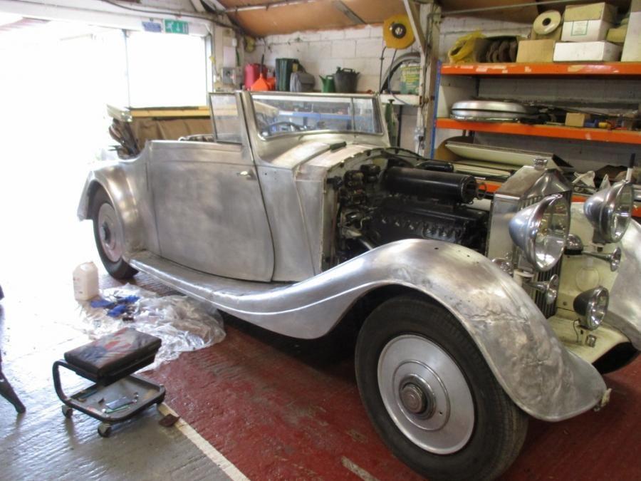

Having spent many years restoring aluminium coachbuilt Rolls Royce and Ferrari one product that i always found useful when dealing with bare aluminium prep on a large scale is Deoxidene though i doubt the Ops repair is sufficiently large enough to require such measures and it is certainly not the kind of product you want splashing about in the close proximity of good paint!
https://www.trimite.com/product/deoxidine-624/
