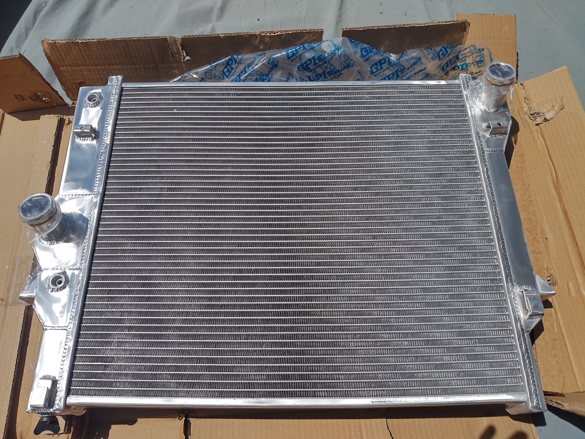

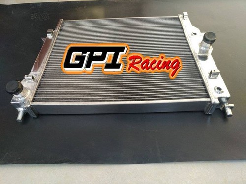

Like others my radiator plastic tanks and connections are turning to cheese and the side tanks are leaking, so I researced many all aluminum replacement radiators. I found good purchase satisfaction from what seems to be a distribution source out of California being sold through a number of various names, all the radiators seem to be manufactured from one Chinese source - my evaluation after research of all the "distributors" with all sports of names.
All of the various online distributor photos appear to be the same radiator but packaged for or by each distributor with their name on it
So I bought this one pictured that appears to have all the correct brackets in the correct locations, except that the main hose nozzles are tilted up a few degrees as opposed to be perpendicular to the tank. It uses a 5 row core which is I think two or three rws thicker than the stndard radiator with plastic tanks, so flow and cooling surface ares "should" be increased, and backpressure after the thermostat "should be less.
Unboxing the GPI Racing All Aluminum 5 row core radiator, in plastic
the GPI Racing All Aluminum 5 row core radiator engine side
the GPI Racing All Aluminum 5 row core radiator, right engine side Pump Outlet - radiator inlet
the GPI Racing All Aluminum 5 row core radiator, left Engine side drain
The GPI Racing All aluminum radiator, engine left side supports and ports

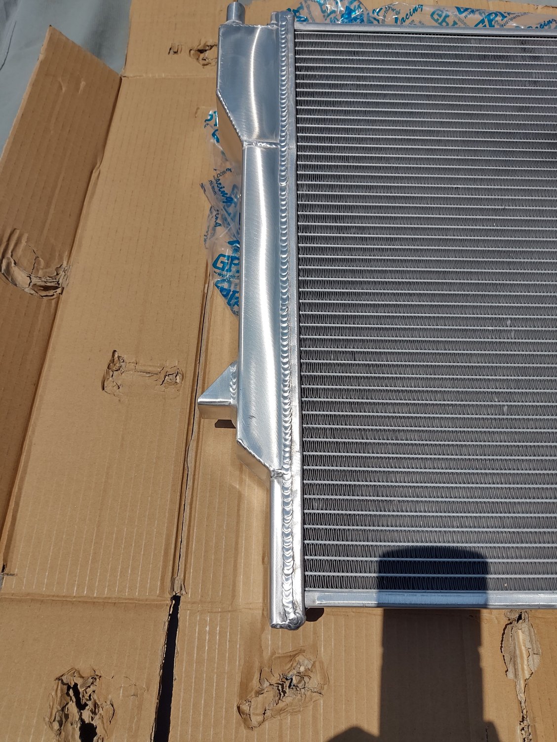

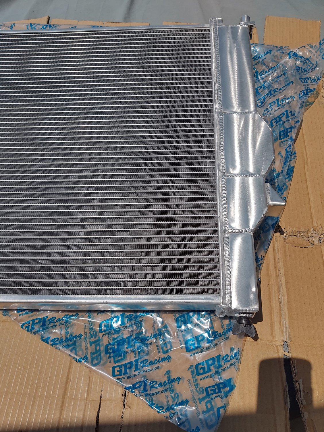

My inspection of this radiator shows, in my opinion, to be good quality consstruction and very uniform welding of all welds.

I think, maybe I could have made things fit with the stock fan setup and the added thickness by modifying some things, but the missing plastic mounts on the front of the radiator tanks toi and bottom for the condenser is not resolvable without additional custom made bracketry to attach to something else, or weld something to the radiator tanks.
Those condenser brackets in front of the radiator I totally spaced as when I skimmed the mounting, I saw what I envisioned to be a separate metal bracket setup. It was not until I took a harder look that yes, the bracketry for holding the condenser IS molded plastic onto the front of the radiator at four points, left and right, top and bottom!!!
