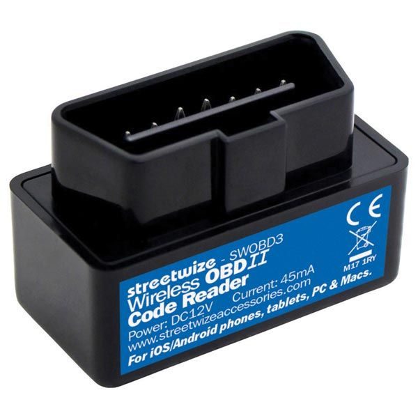

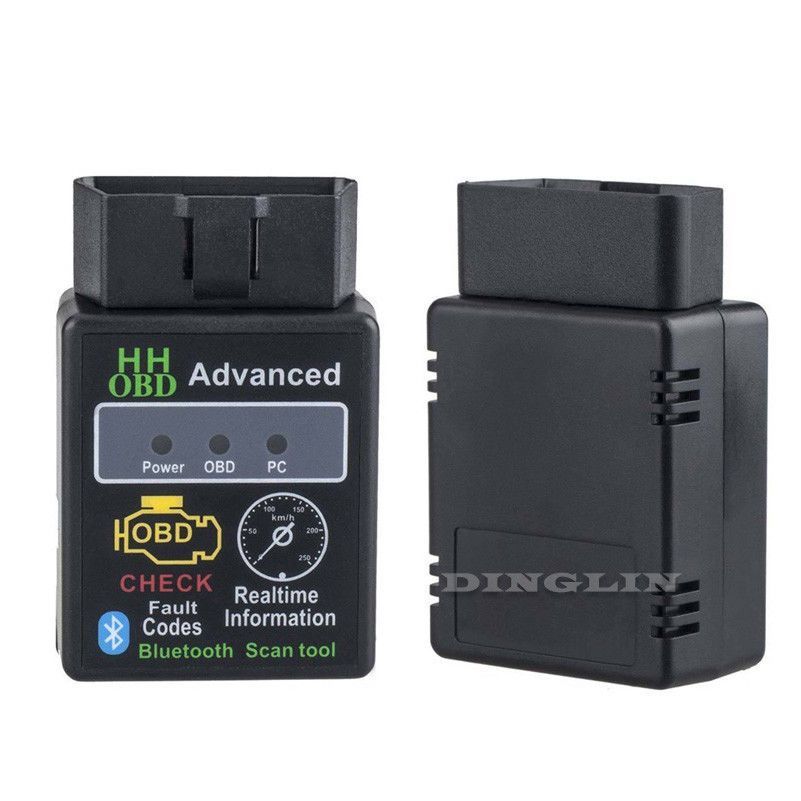

Hi all,
Tried another code reader that I was advised was ELM327 compatible but this one also does not seem to connect to my car. Not sure if it's just my car or I'm just unlucky.
This is the one I tried.
Just going to order a different one to try. I'll let you know if I get better success with the new one.
Thanks,
Chris

I believe you need the blue tooth module not the wi-fi version. Leastwise I did.

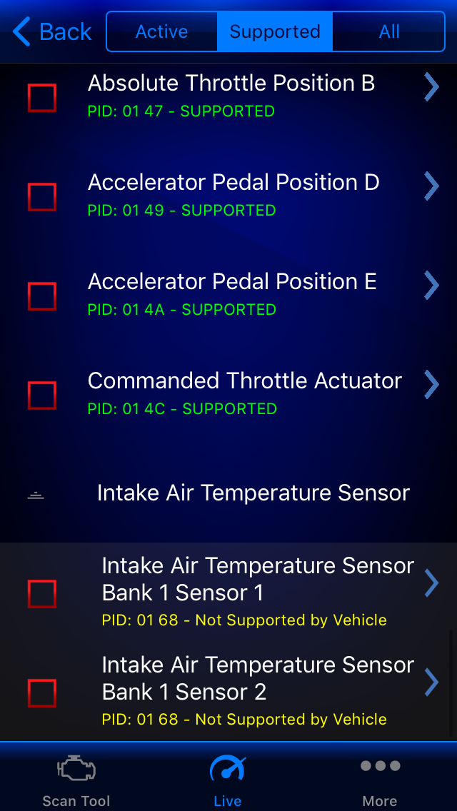

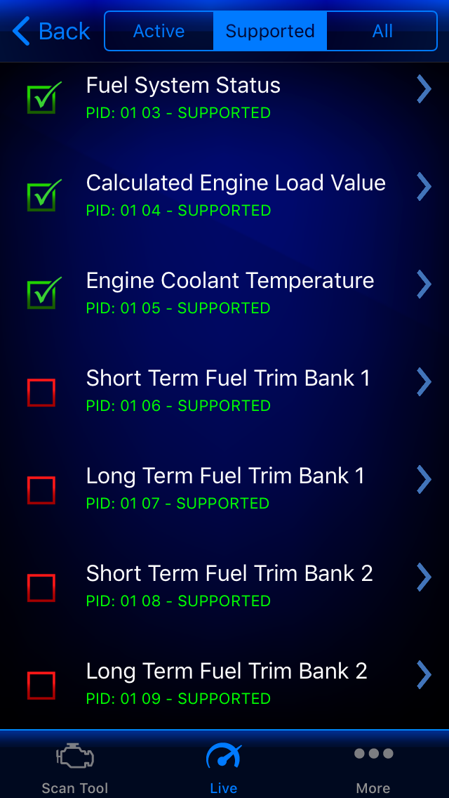

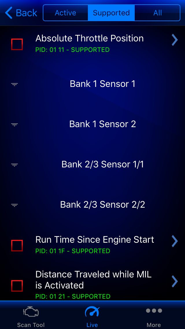

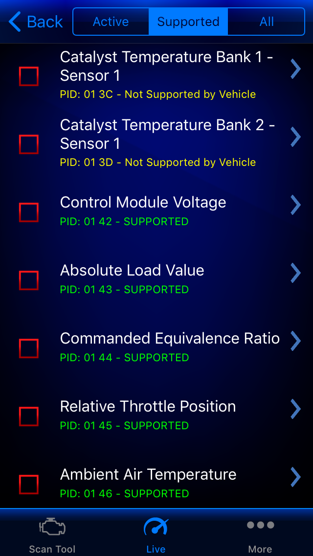

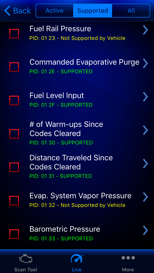

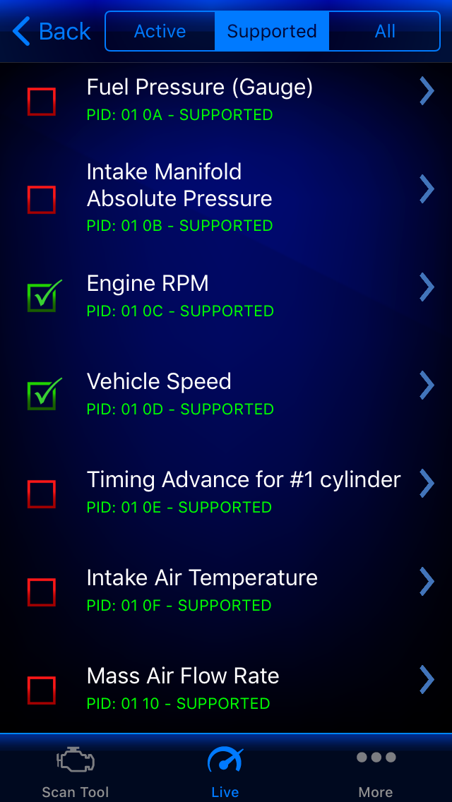

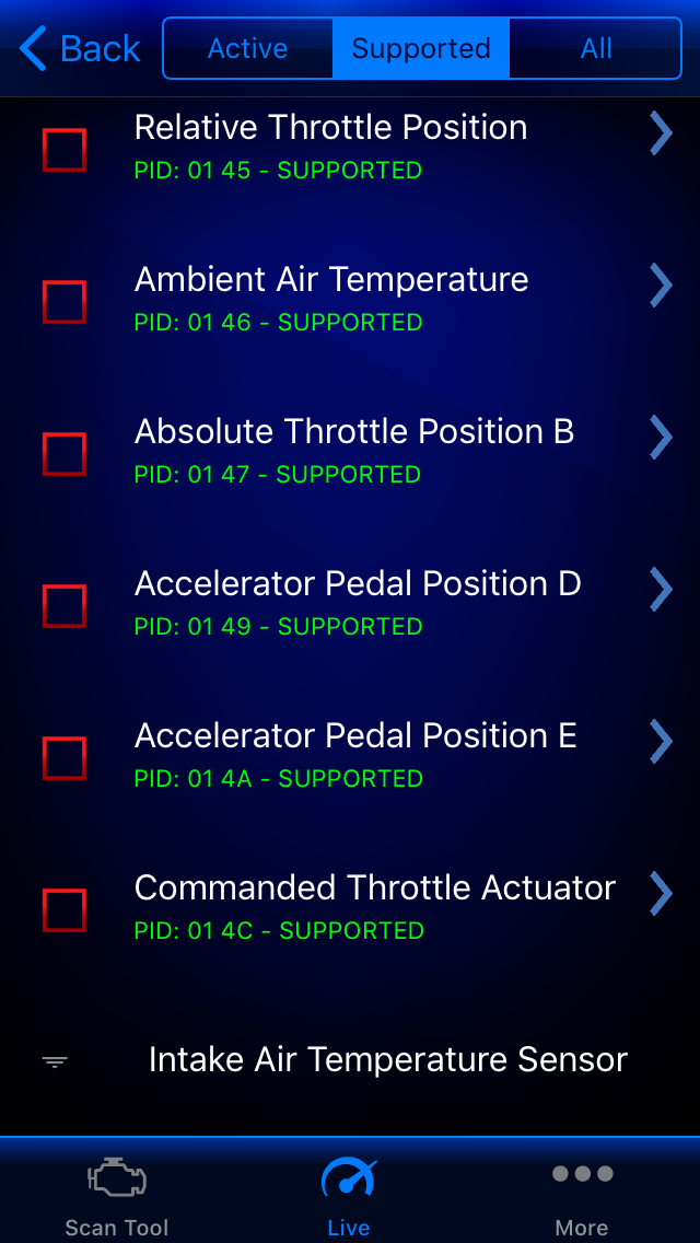

Hello Don,
Sorry for the delay, I didn't have a chance yesterday to connect the Blu-Driver to the car. I am not sure which are the codes you mentioned so what I did tonight was do the "live" data feature and screenshot all the supported codes it shows. Sometimes my car says "cruise not available" but I don't get any codes for that. When I scan for trouble codes it says no problems found. These screenshots are from the "Live Data" feature of the scanner, which was helpful to me in understanding the coolant gauge. I thought it was broken until I found a post here on the forum that indicates it stays at 50% for a wide range of temperature. Some screen shots may have repeated codes because of how the scrolling worked out on my phone. The check marks are only there for things I chose to display or log live, the app recommends you don't pick more than 4 or 5 at a time.
Hi Frank,
Thank you for posting those screenshots. The BlueDriver Live Data display seems very similar to and just as complete as the one in Torque Pro.
Thinking about your Cruise Not Available warning, plenty of faults that can inhibit cruise will trigger P- codes, which the BlueDriver should be able to read. But a lot of other issues, such as faults with the air suspension, anti-lock brakes, or multiplex network, will trigger B-, C- or U- codes but not a P- code, so it is possible the BlueDriver is not capable of reading those (Torque Pro can't either). I'd love to hear from you if in the future you find that it can in fact do so. Our members are always looking for affordable scan tools that can read all the Jaguar codes, so please let us know!
