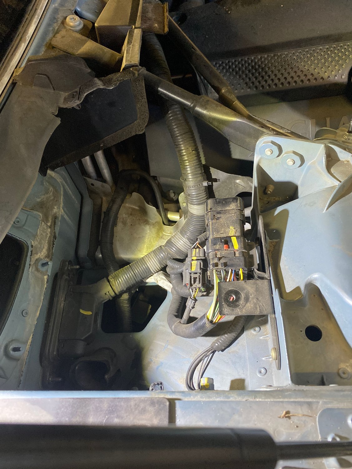

I need some advice on my Blue car, 2004 xj8 4.2. not super, serial G31309. I have a code P1646. I have ordered and received the bank 1 upstream sensor for replacement. The job is now in progress.
I have researched and found several threads referring to such a job, one even claimed it was an easy fix from the topside. But none gave any good description of procedure.
So far, I have removed the wiper arms, the plastic cowl trim piece below the windshield, the cabin filter mount box and the lower outer cover for it. As yet I can but barely see the sensors' plug since it is mounted to the body edge. To continue the job in this direction and dig deeper I can see there is a brace holding a large wiring bundle, an aluminum heat shield bolted to the right side of the body (cant see where), the air conditioning lines, and then possibly lastly the exhaust manifold heat shield before I can get at the sensor itself. I am not interested in unhooking a/c lines, and I am not sure how the manifold heat shield would come off/out without the a/c lines being moved or removed.
Does this seem like the right direction to proceed or should I shift gears as it were and lift the car up to try from below?
Barring the lower plastic cover and the front suspension, I am not sure what would be in my way to try from below. I do have a jack adapter to lift the whole front without twisting.
Thoughts or recollections of actual procedures? Thanks!
The area where the cabin filter ought to be (right hood strut at bottom of pic). several parts still in the way without any obvious means of their removal or a promise of ability to remove the sensor.

I'm not sure who would have ever told you to access the upstream O2 sensor from the top side. It's readily accessible once you jack up the front end just removing the undertray.

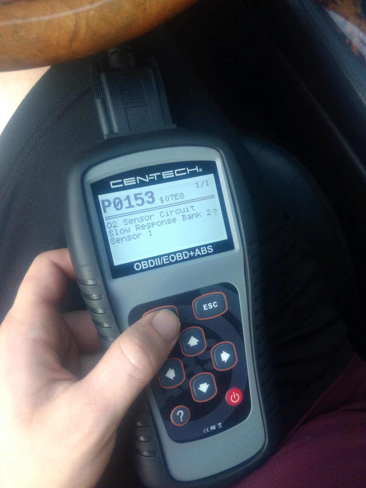

Above posters sound correct. I replaced the two upstream sensors last year (economy grade). Just a week ago, I started getting another set of O2 codes.
Can anyone tell me if these are upstream or downstream? P0153 - slow O2 response, sensor 1 bank 1 and matching for bank 2.

Sensor 1 is upstream. The ECM uses the upstream sensors to monitor the combustion. The downstream sensor is just there to see of the cats are working. If they read the same as the upstream sensors then the cat isn't doing anything.
