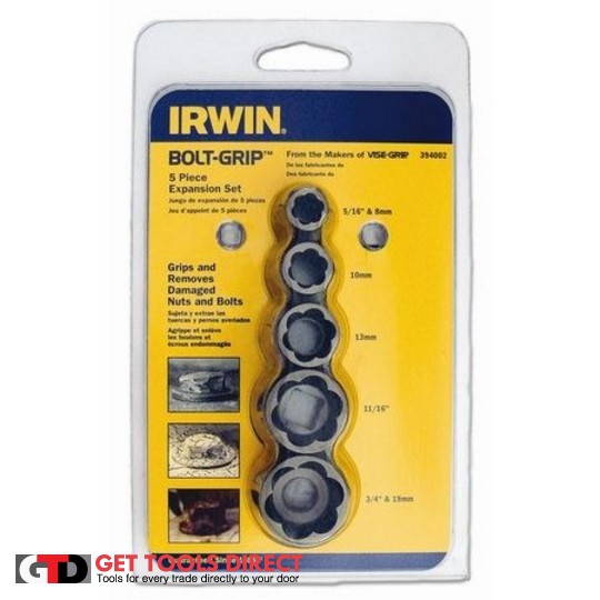

So unfortunately only 18 of the 21 bolts came out without stripping the Torx 27 head. Tier 1 alternative was an easy out, which wouldn't budge them. Tier 2 alternative was to use an 11/16" bolt-grip socket, which has fluted blades inside it that dig into the bolt head. Unfortunately there wasn't enough clearance for the socket to settle around the bolt head, so I used a cutter with an oscillating plastic/metal cutting blade to trim off and through the plastic and make enough clearance. In many cases I actually cut a hole out of the plastic transmission pan around the bolt head. All of the stubborn bolts were corroded on very badly. I was careful not to cut deeply enough to damage any of the transmission parts.

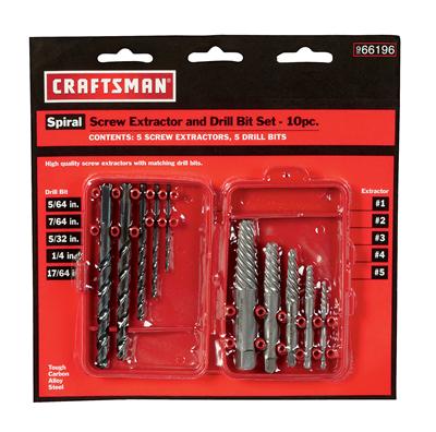

Thanks for the post! I lost several in my attempt to remove my tranny pan. I had to buy two different bolt extractor kits to eventually get all of them out. What a pain. Mine weren't corroded, per se...but the T27 torx was SO easy to strip out and I wasn't using an air gun to get the 'instant' torque that I believe it takes to break them loose.

I used these
Craftsman 10-Piece Screw Extractor Sets 966196
and Pro Grabit Screw and Bolt Remover 3 Piece Kit

Makes sense. Here's what worked for me:
