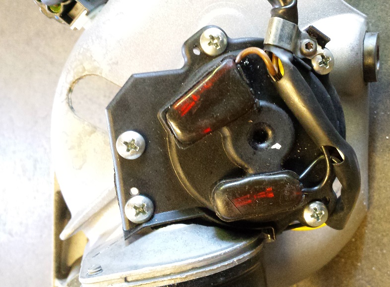

So my 2004 XJR wipers would fail when cold. They would sporadically not return to the down position, instead stopping on the return swipe right in my field of vision until the next swipe was triggered. Manageable but annoying. So I decided to try and get them working better.
Step 1: Remove wiper assembly from car. You'll have to remove the wiper blades and plastic tray covering the assembly and remove the brake booster and possibly the master cylinder. (I already had my master cylinder out cause I am replacing it) to have enough room. If you remove the master then you'll have to bleed the brakes.
Step 2: With the wiper motor out of the car, carefully drill the rivets holding position sensor cover to the wiper motor.
Step 3: Clean and sand off the tarnish on the sensor contacts and make sure they are bent out to keep good pressure on the spinning disc. (see photos)
Step 4: Apply new clean lube that is electrical friendly and reassemble unit with small screws or rivets. I chose screws so I could easily take the cover off again if needed.
Step 5: Install wiper motor Assembly back into vehicle, reinstall brake booster, reinstall plastic cover and wiper blade assemblies.
So after I completed this I tested the system by spraying the car with the garden hose. So far the wipers have worked 100% perfect without fail. We will have to wait and see the next time it rains and how long they will be good for. Time will tell how long this repair will last.

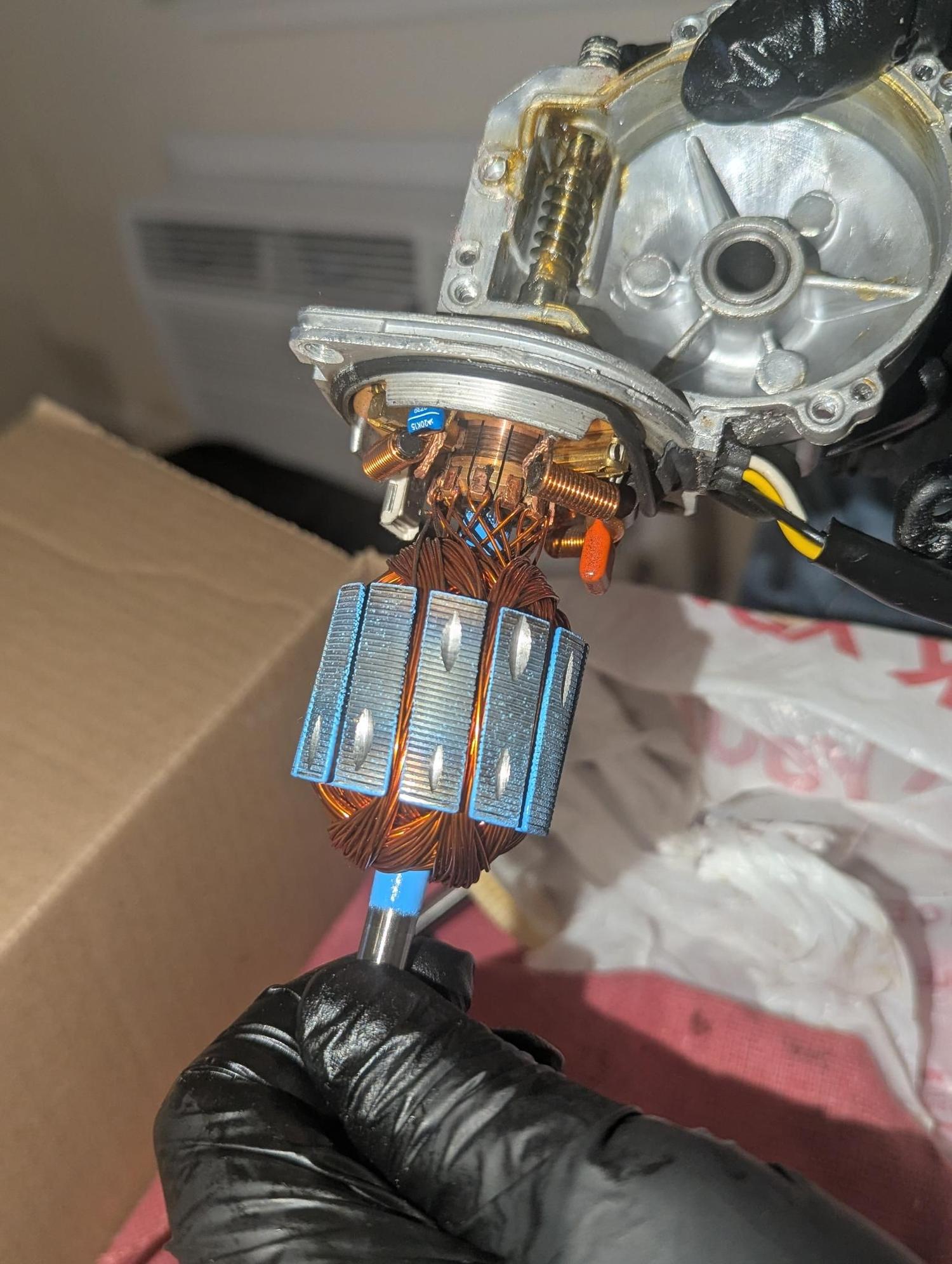

Thanks for the heads up there, I was missing that star ring under the grease. Definitely a pain in the rear to get out as there's not enough room to properly get a pick in there.
I took a small precision flathead and pried at it focusing on one side slowly until I finally bent it upward.. I was being careful to not overdo it so the blue disc didn't get damaged.
The locking ring definitely got beat but I figure since it's a retaining ring it won't impact functionality:

Somehow I think I'll be the last guy here crazy enough to undertake this but in case another soul follows through, here are additional pictures for reference.
Note these are prior to any sanding or contact cleaner, just wiped the grease off. Surprised at how clean it all looks, maybe didn't even need service but since I sourced this second hand, I'd rather go through it all once.
Wasn't able to get the combinator out unfortunately but I'll wipe the area that makes contact with the brushes as best as I can.
