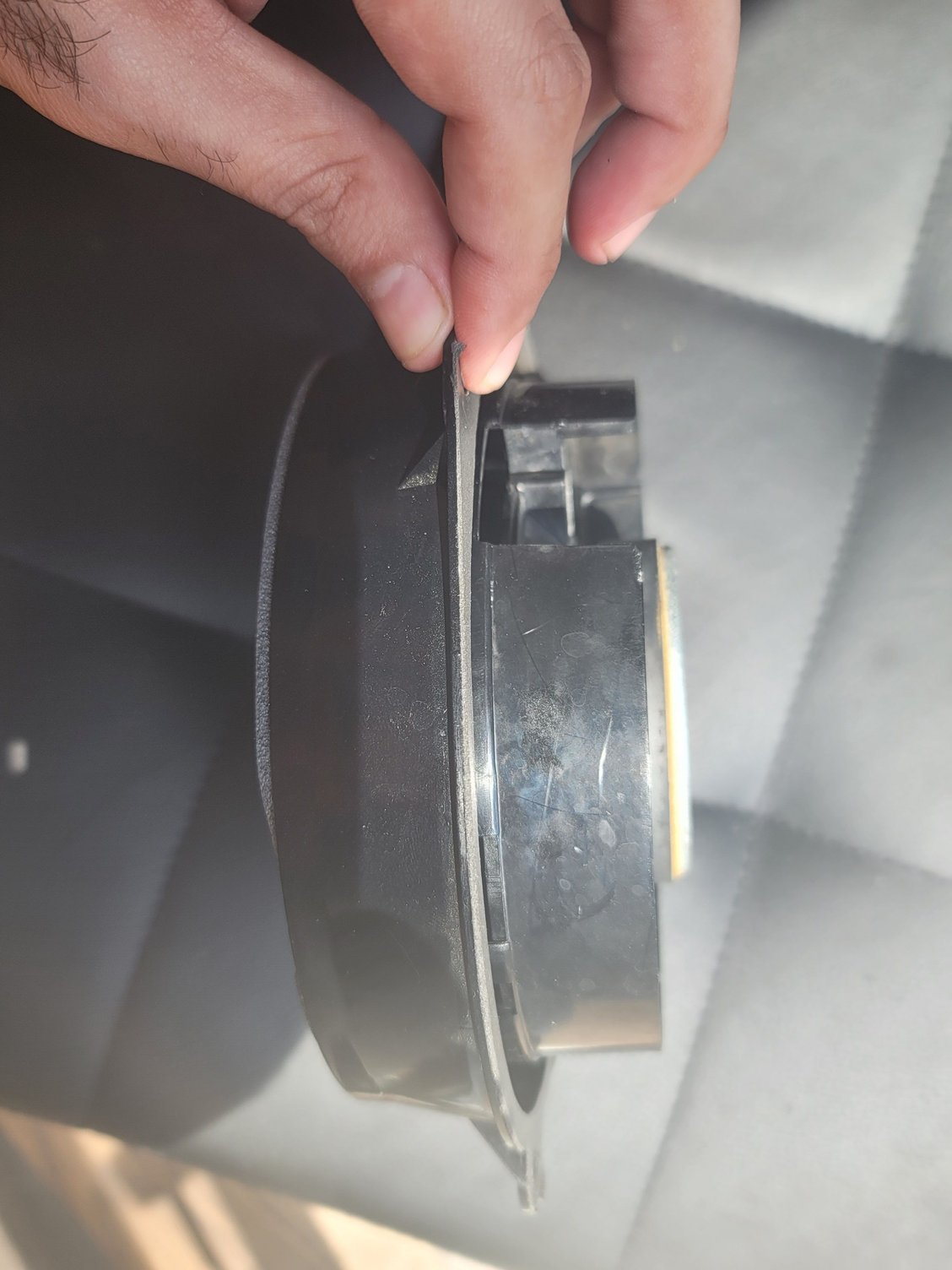

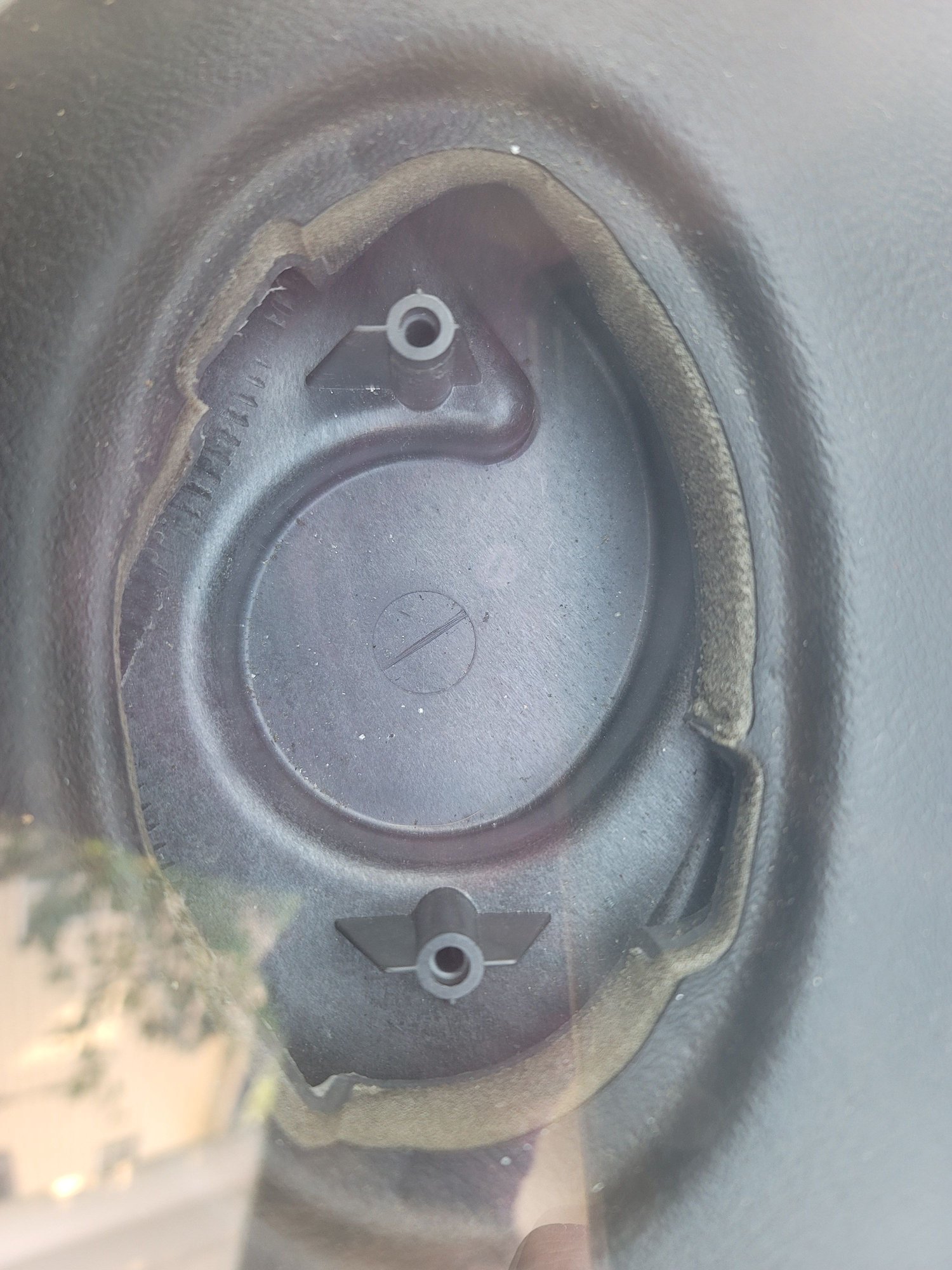

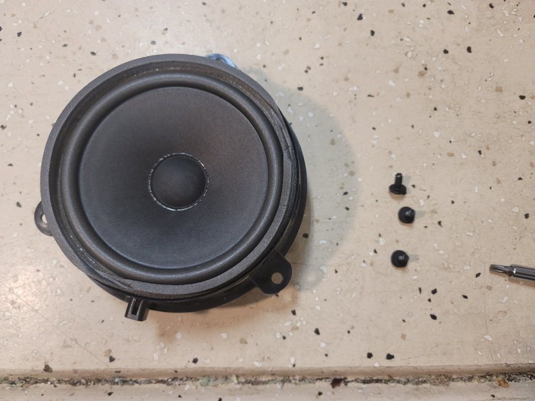

Another sad update; This is project is running into all sorts of problems: I managed to make some progress and installed the woofers in the doors. TDLR; the 1/2 " spacer doesn't really help and extra small gap can be covered with any sound insulator like tape.
1- The original speaker depth to the screw hole is around 1.5" with an additional ~1" plastic cover to the speaker. Total depth IMHO is less than 2.85" or the speaker touches the window glass. My CDTs fit but they are literally 1/2" over the PVC bracket and the spacer wasn't used.
See the photos below:
I then taped the gaps for better bass response & the difference in sound quality without the crossovers or tweeters is night & day.
As for the crossovers; this is IMHO the best place to mount them:
The only thing left is to order a different tweeter (from CDT) and use the stock mounting location. As the dash endeavor is a dead end IMHO and not worth the extra hassle to run wires from the door panel to the dash. There is no "hole" or pre-wired cables and IMHO it isn't worth the effort.

My XJ8 has the "base" 8 speaker 140W stereo with speakers only in the doors. I already have a 12" inch Dayton Audio Reference sub (as good as JL 12w6 SQ wise but for less $$) given 800W to handle the lows. I was stunned to find the OEM factory speakers (4 OHMs BTW) are of awful quality as shown below:

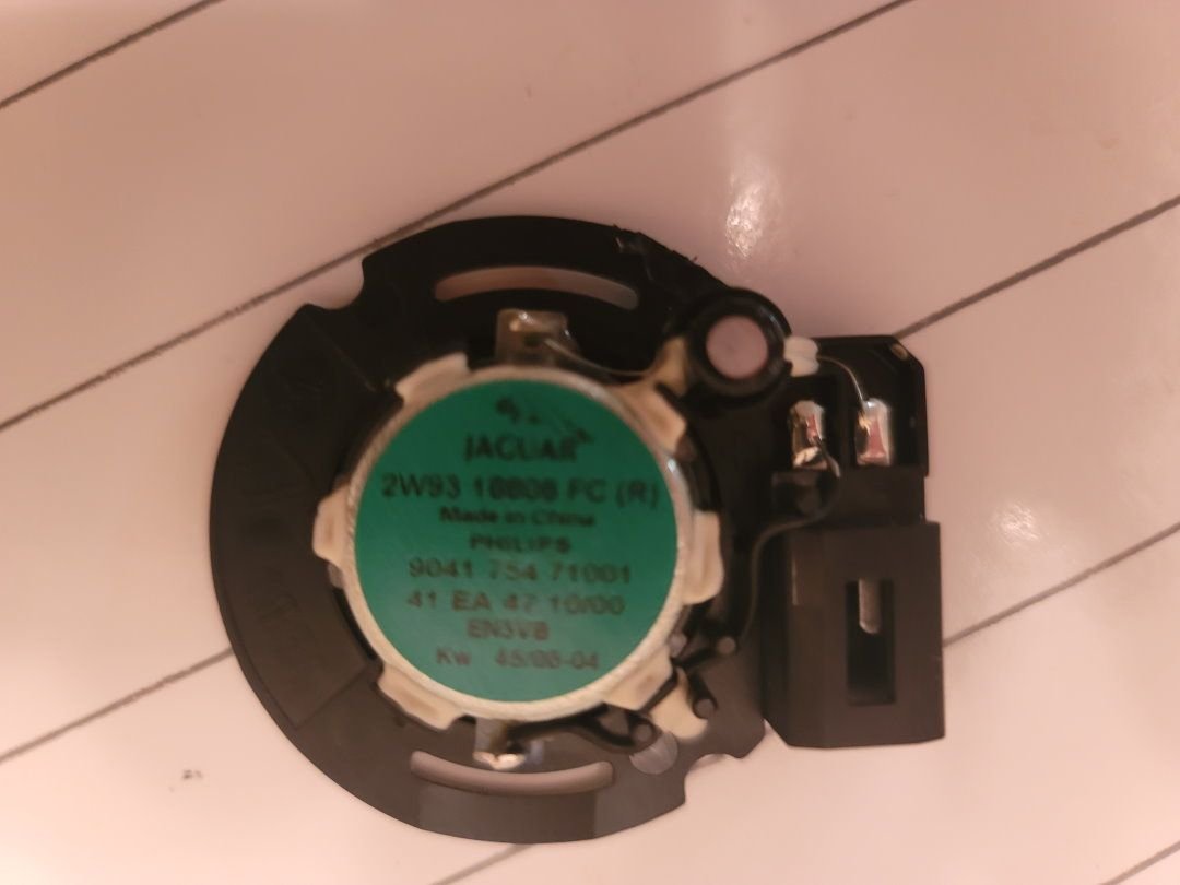

They are literally $20-30 generic speakers. The tweeters while better are also nothing to write home about:
The tweeters are 1.25" with outer diameter of 2".

I was able to adapt a tweeter to the factory location, with the factory plate. I Dremeled out the tabs holding the tweeter to the plate and then I used the Dremel tool to very slightly enlarge the cutout size and remove the plastic "fence" over the tweeter. Eventualy my replacement tweeter fit the plate and I just epoxied it onto the plate, and used the plate in the door panel just like the original tweeters. I didn't use the factory tweeter line, I just connected it to the woofer using its passive capacitor crossover. I did use the factory wire to feed the woofer in the door.
