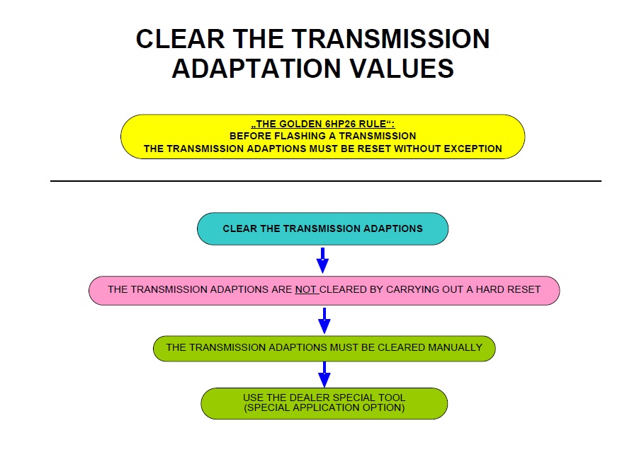

Transmission adaptations are not cleared by carrying out a 'Hard Reset'. They can only be cleared with dealer diagnostics or equivalent.
This extract from the ZF HP6 Troubleshooting Guide confirms:
Members across the forums having models fitted with ZF 6-Speed transmissions aren't reporting anywhere near the problems of those with the earlier 5-Speed but this could be because the later transmissions haven't yet got as much age or miles on them.
