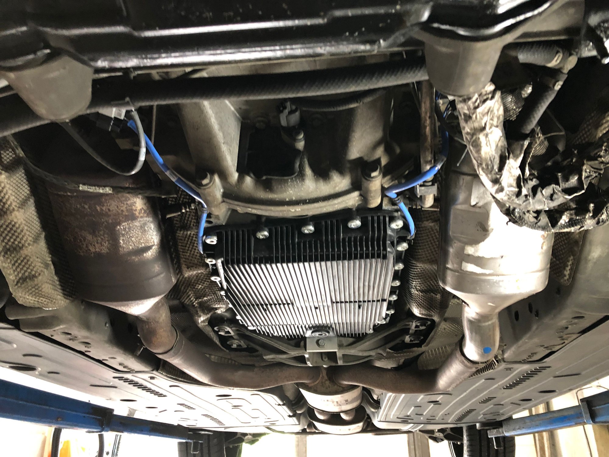

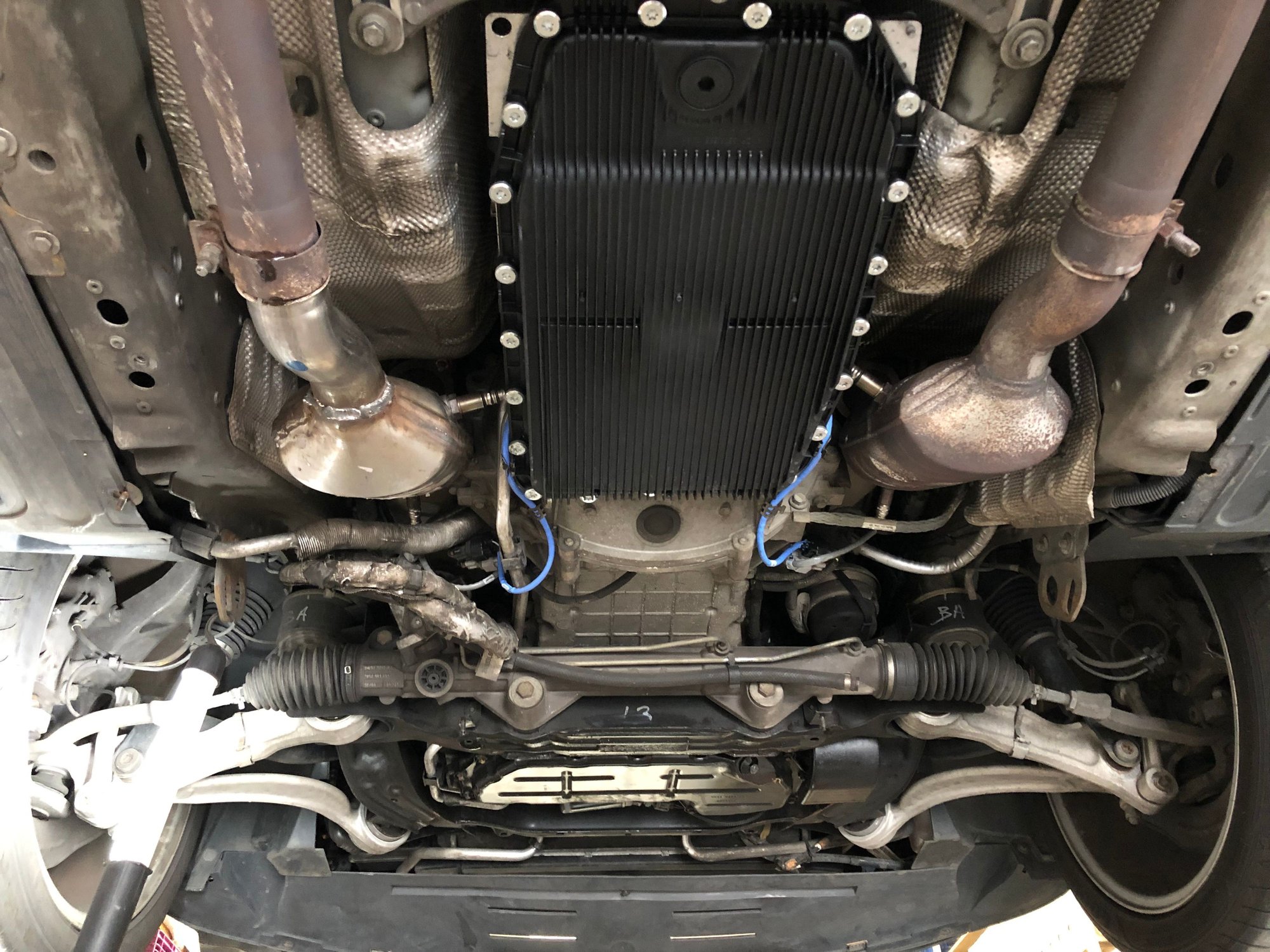

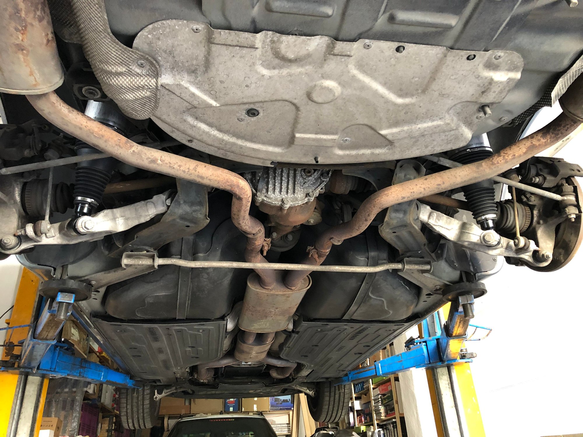

If you look under the car, you will definitely see only TWO catalytic converters, one for each bank.
They look like this, the picture is taken from the Jaguar parts catalogue, and in reality they also look exactly like in the picture. I have had my car on the lift enough times to know, and I have already replaced one of them.
After the catalytic converters, you have the middle silencers and then the end silencers. You can easily check the setup vial the link I have posted in my first answer.
What you mechanics might refer to, and also the text posted by rsa760041 might refer to, is the fact that within each catalytic converter there are two cell packs, with an oxygen sensor placed in between them.
Each cell pack could also form a separate catalytic converter if packed into a separate enclosure, but this is not the case with our cars.
So, technically speaking, it could be considered that the car has 4 catalytic converters, but if you talk about the catalytic converter as the part that can be bought as a spare from Jaguar, then you only have ONE for each bank, as shown in the picture.
Everything else would mean buying the internal cell packs, opening the enclosure of the catalytic converter, replace the cell packs, and re-weld the enclosure to close it. Maybe your repair shop is talking about this procedure, instead of a spare part as sold by Jaguar.
The point is that normally, when you speak about catalytic converters, you talk about the part to be replaced "as is", and not about replacing the internal cell packs.
