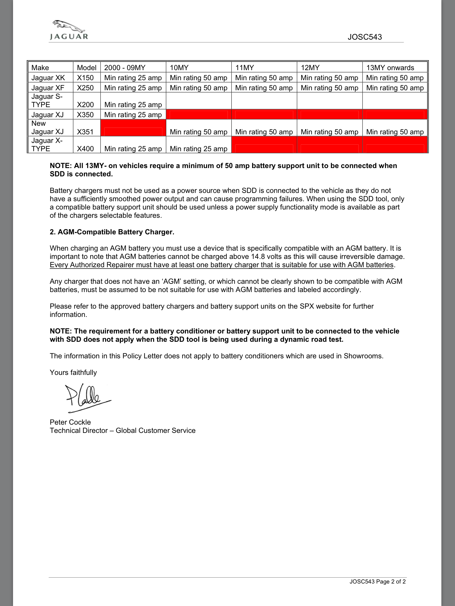

Hi all,
I have a VCM setup in the mail (coming from Cambo...thumbs up to him for getting everything setup and shipped in a hurry) and it will be here sooner than I expected.
From a quick search, it looks like the dealers use the 55 amp Midtronics PCS-550, which you can get for about $400. I only need a minumum 25-30 amp charger (see attached bulletin), but I'd like to get a minimum 50 amp just so I can use it on newer vehicles if/when we upgrade. These range from $50 and up, but I don't want a piece of junk.
For you mechanics/tech gurus in the states using a VCM/Mongoose or something similar, what kind of charger are you using or do you prefer?
Thanks!
Attached Thumbnails Charger when using IDS/SDD-img_1246.png   Charger when using IDS/SDD-img_1247.png
