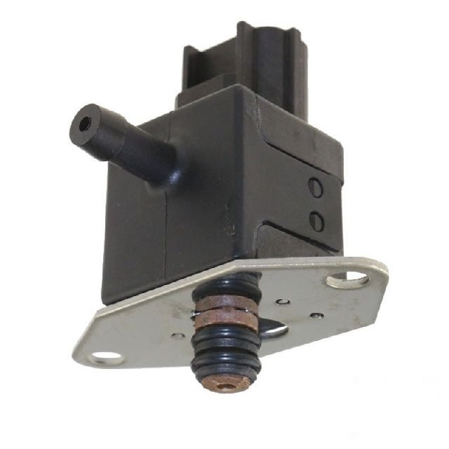

I think you have the 4.2L V-8?
On the V-8 the test port is on the passenger side towards the rear of the engine. I have also seen it on the drivers side at the front of the engine.
When I had a problem with fuel pressure on my 2005 S Type R it turned out to be the fuel pressure sensor.
It looks like this;
It does look like Jaguar dropped the test port at some point too. So if you can't find the test port all you can do is use the scanner read out.
