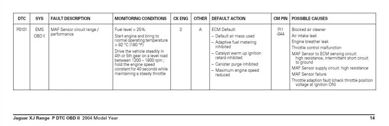

I just started on vacation and when I sttopped at Sonic the car did not want to start it took 4 tries to get it started each time it started and then immediately died once it did start I stoppeutoZone and got codes 0508 and 0101 what are they and how do I fix them thanks in adva thanks in advance Adam. Ps. I did just change the spark plugs.

Adam,
The last thing you need on a vacation drive.
Here is P0101:
I can't find P0508 listed for your model.
