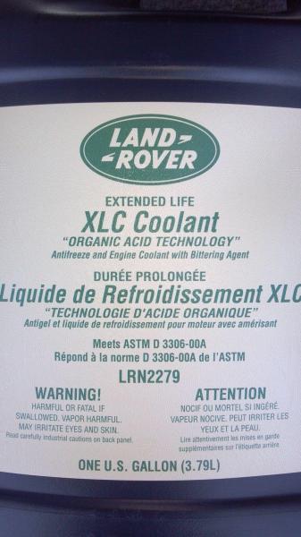

Click on the picture attachment below to see the coolant that was given to me. Maybe this will help and you can determine if this is ok or not for a 2004 XJ8. Please let me know. Thank you.

This is from your owner's manual:
Use anti-freeze to
specification WSS M97B44, coloured
orange, Extended Life Coolant.
Dexcool type coolants meets this spec. No need to go to a dealer and pay triple or quadruple the price. Neither Jaguar nor LR manufacture their own coolant- they just have someone bottle the coolant and put their label on it.
Old Sep 4, 2012 | 06:57 PM
The correct coolant for your Jaguar is OAT (Organic Acid Technology) Extended Life Coolant.
Jaguar literature gives further information that the Coolant should conform to specification WSS M97B44-D Orange or equivalent. This specification is a FORD standard reference number.
The Coolant you have been given in the Land Rover branded container is OAT and complies with ASTM D3306-00A. This is the American Society for Testing & Materials standard reference number.
The two standards are equivalent and you can safely use the supplied product.

In my last flush I used DexCool as well. There have been no heating or cooling issues as a result. As mentioned, it conforms to the specification.
