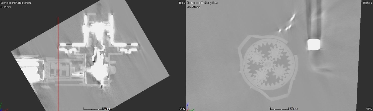

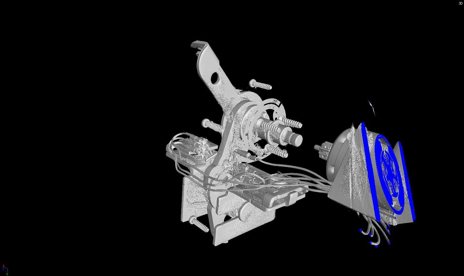

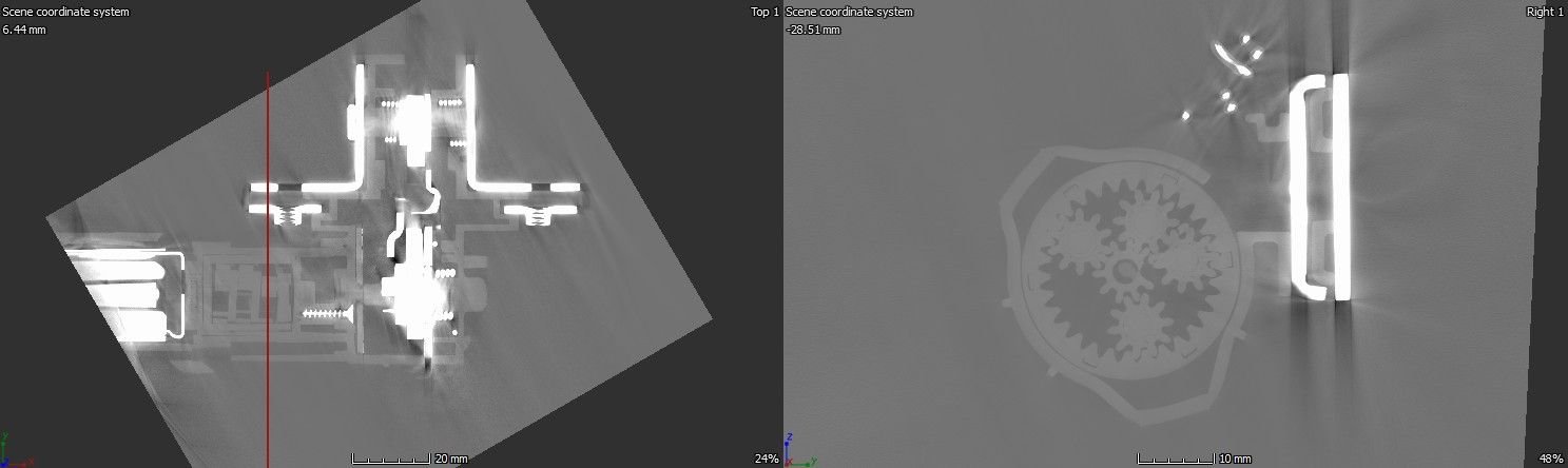

jonpalley posted a very nice videos of taking apart trunk latch.
Here is another way of troubleshooting this problem, it dies not require taking latch apart, for troubleshooting, but it requires access to $300,000 piece of equipment
Naked metal parts in position but plastic removed
Brocken and dislocated gears; last stage of gearbox
good gears in second stage of gearbox
I know what caused it! was in a rush and had bunch of loose closing laying on top of lounge chairs in the trunk. I was too busy to spread things around and as lid came very close to be closed... I just 'helped' it a little.
So, I spend XXX time more fixing this issue!
Now I need to find a way how to 3D print broken gears and I will have good working latch again.
