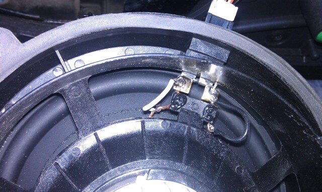

I tackled my non-functioning door speakers today in my '04 XJR. Both right door mid-bass speakers were out although the tweeters were working. The wiring diagram shows both these speakers run off the same channel on the amp so I figured it was the speaker.
The door panel gave me some trouble. It was actually very simple, 4 screws and pull it off, but I wasn't expecting to have to use as much force as I did. I don't know if the panels were stuck because they've never been off before, or if they are just that tight, but I stopped several times to consult the workshop manual and make sure I had all the screws out. My trim tool wouldn't do it and I finally worked up to a pickle fork before it popped off.
I tried another speaker and it worked, and I had read in another thread that the connections in the speaker itself go bad sometimes, so I jumped a wire from the input directly to the wires going to the voice coil and it worked. I took both speakers and soldered jumper wires to the voice coil leads and everything seems good now.

I fixed all four of mine in December the same way. This seems to be a problem on all of these speakers. Mine were corroded between the soldered connection and the point where they were glued to the stand-off. I assumed it was the solder they used, but someone else suggested it may be the glue instead.

I finally had a chance to do this to my speakers yesterday. Over time all four of my door speakers had stopped working. just like kaug said "Mine were corroded between the soldered connection and the point where they were glued to the stand-off." the copper wire was corroded at the standoff.

thank your for the starting this thread and posting the pic gmcgann.
